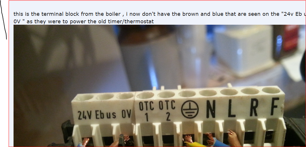

i have the GLOWWORM FLEXICOM 30cx combination boiler, i have bought the Nest V3 smart thermostat , i have wired up the boiler and the thermostat as far as i know correctly from the diagram with the nest instructions

this is the terminal block from the boiler , i now don't have the brown and blue that are seen on the "24v Eb us 0V " as they were to power the old timer/thermostat

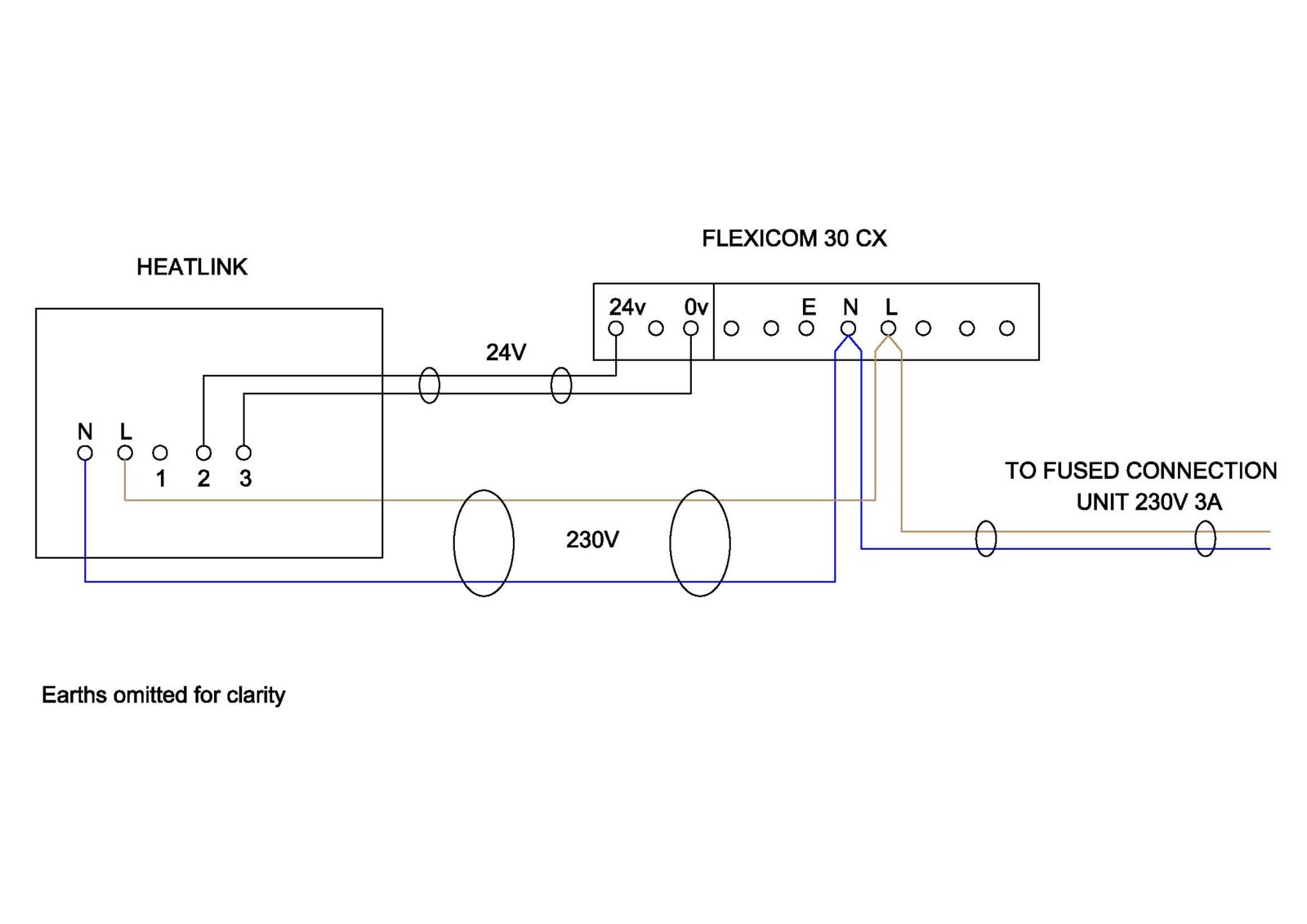

This is the diagram i have followed from the instruction manual
The issue i have is that the combi boiler is obtaining power as the unit powers up and the display panel is illuminated , and when i turn on the hot tap , i get hot water (its a combi boiler)
BUT i do not have any central heating control , i cannot get it to fire up at all
Am i missing a wire somewhere, ?
i do not understand the diagram - do the lines above terminal 1-2-3 represent its switches between one and the other ?
