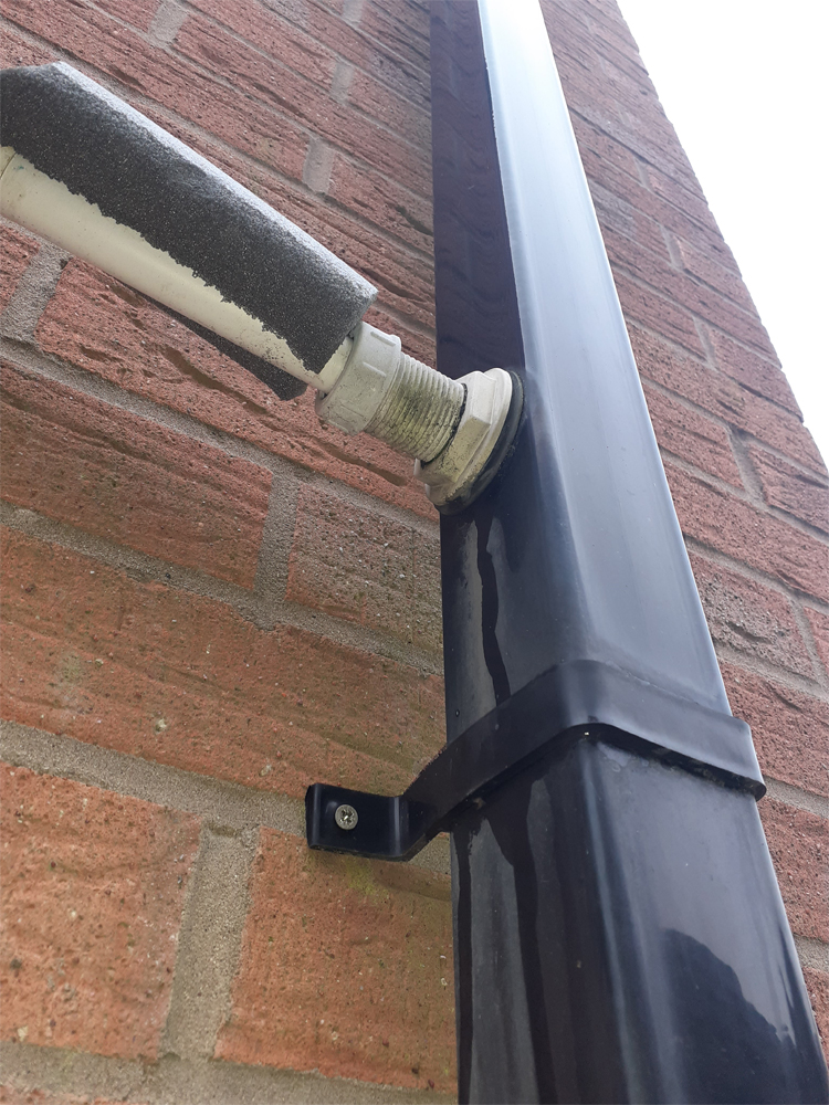

I'm hoping some kind soul might be able to comment if this workmanship has been carried out properly?
Situation is: previously an open vented system which has been converted to a sealed system (the benefits of which I'm still unclear on). As such, an expansion vessel was positioned in the loft, and a prv above the boiler, leading to what I have discovered is the attached work having been carried out on the external wall behind the boiler.
1. The partial foam covering will surely just disintegrate and/or blow off in strong weather? It just initially strikes me as a bit of a sticky tape and blu-tac approach?
2. Where they have bored into the existing down pipe, there is some slight seepage which trickles down the outside of the down pipe as can be seen in the photo. Surely the seal should be tight?
3. On a related note, we were quoted £295 for sealing the system incl expansion vessel, prv and 6mtr pump by the proprietor. The workers who attended did not see fit to install the 6mtr pump (as the sealing was done in preparation for a power flush), so do we know what a reasonable ballpark figure for the sealing should be in light of this?

It looks a botched job, they might at least have used the right size insulation, and used adhesive tape.
That's the condensate pipe. But it sounds like the boiler wasn't changed, or was it? If not, no need to touch the condensate pipe.
No idea about 3, I'm not in the trade.
To add - it's definitely not right like that as it's at risk of freezing. Then the boiler will lock out and you've lost heating just when you need it.
It shouldn't be leaking but it doesn't look new. As above, was the boiler changed?
That looks like the old condensate pipework that was done when the boiler was installed...it's a bodge done at the time and even more so now the regs have been tightened regarding outside pipework.

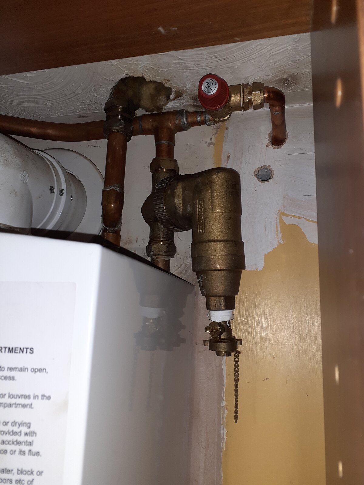

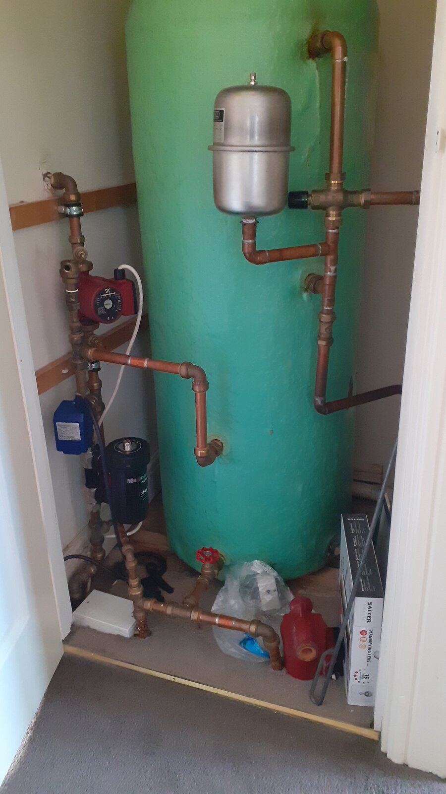

Need more pics of the work done...show us the safety valve/filling loop/gauge and vessel.
Safety valve should emerge through the wall normally although there are ways round that.

That is the condensate pipe and will require an air break, incase the downpipe blocks, it will damage the boiler

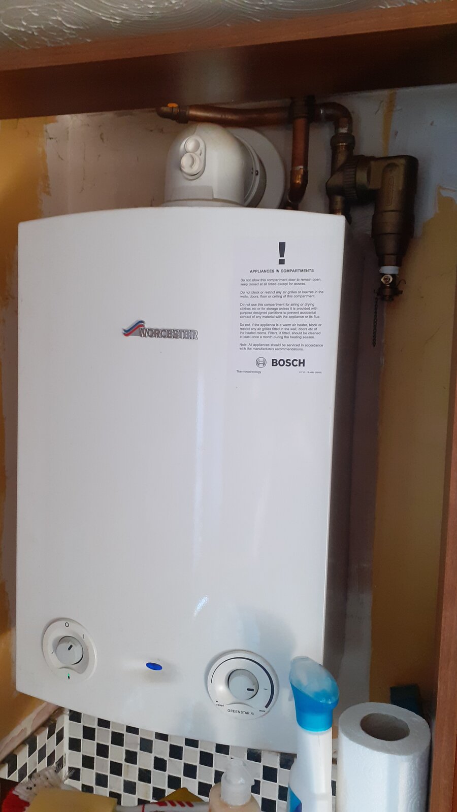

The boiler is a Worcester Greenstar 15ri consdensing boiler. The story goes something like this:

Here are the "before" pictures of the airing cupboard and boiler:
And here's the "after" shot of the boiler showing what I understand is the PRV:
Comparing the two photos it looks like a second vacant hole has appeared in the wall towards the right. Does this new pipework / workmansip look like an ok job?
The white condensate pipework was done at the time of the boiler installation...and not very well.
Outside pipework is prone to freezing and there is an added risk of the downpipe blocking from leaves etc causing rainwater to back up into the boiler.
