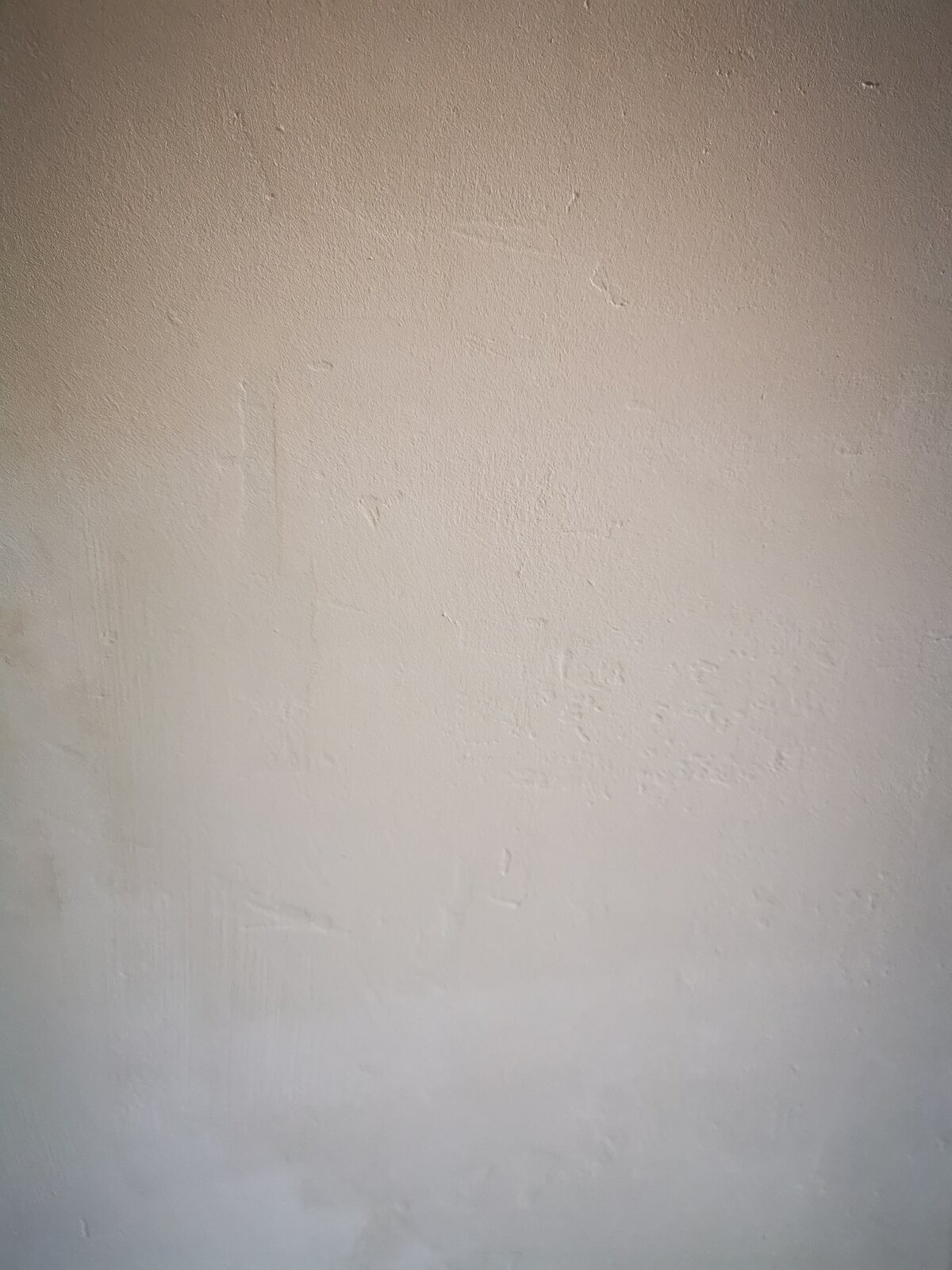

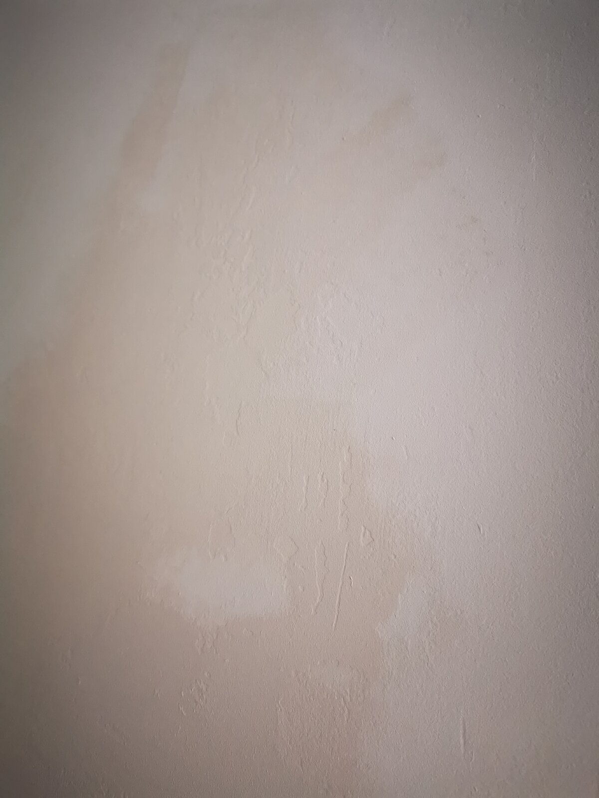

Hi thought we'd decorate the downstairs toilet and the previous owner had music note pages all stuck on one wall which initially looked nice & unique.
After steaming off the pages and removing a mirror he'd put up using no nails and screws the wall's not looking too good.
Where do i start???
I've got a box of Toupret
Sand Most of the wall down ?

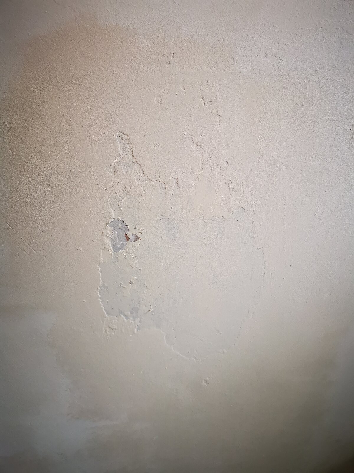

Just keep applying coats and build them up? You can see in the first picture that the paints just peeling back off.
Is there a thicker undercoat i can buy?
Or would i need this?
https://www.screwfix.com/p/make-goo...-filling-ready-mixed-compound-white-5kg/144gp
bettz1, good evening.
Can I suggest sanding with a "Pole Sander" using various grades of paper?
Also suggest you consider using a very heavy grade of lining paper, easier than an attempted skim??
