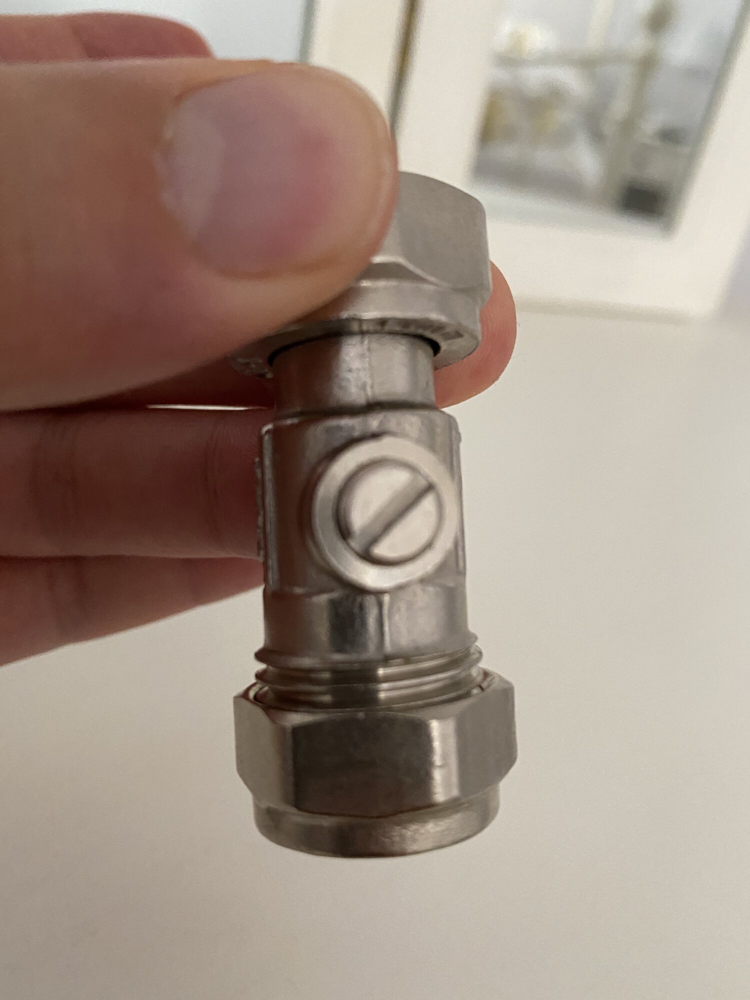

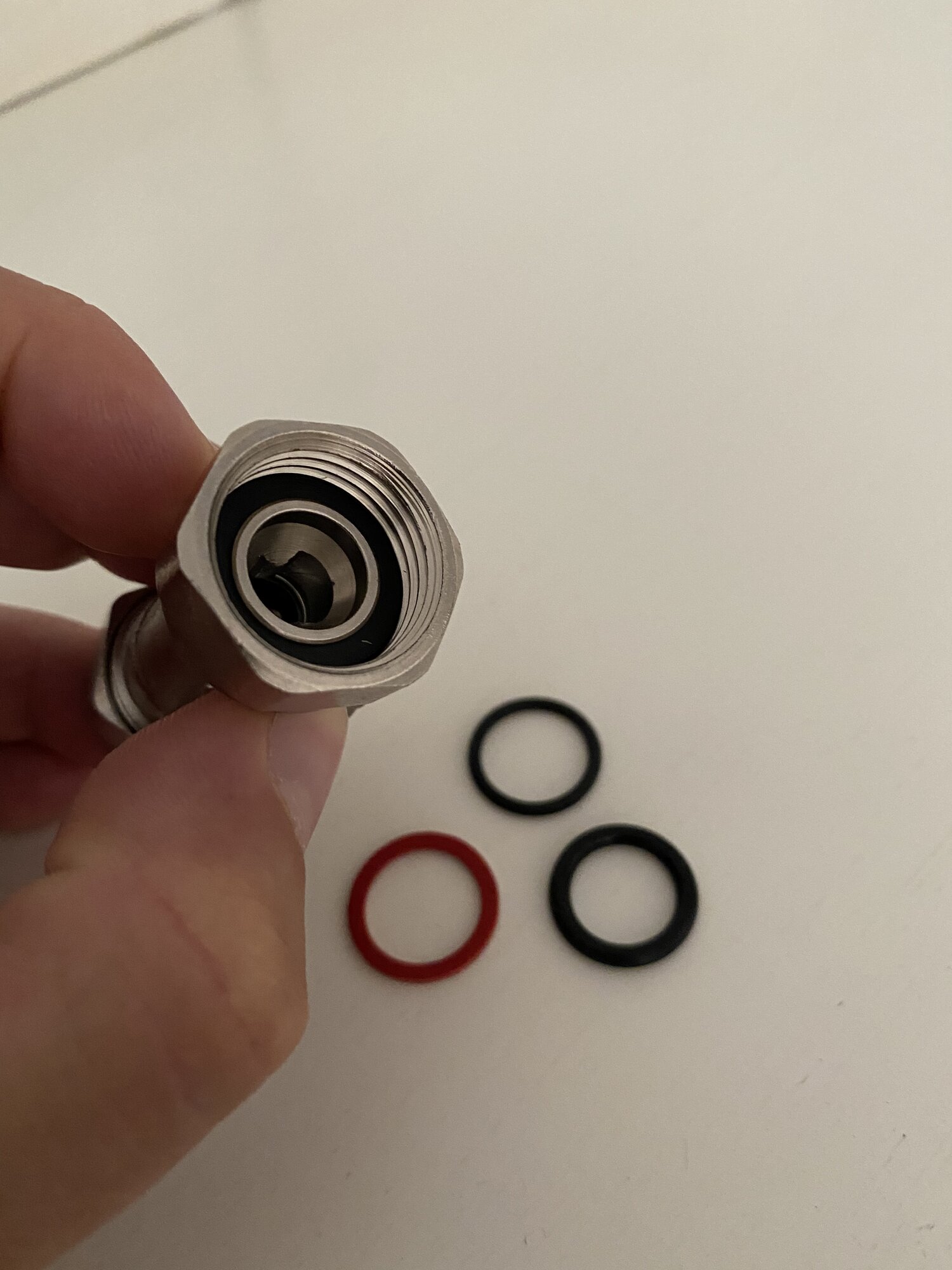

Bottom feed water connection to cistern sprung a leak from the joint between thread and isolation valve.
I thought it was due to a failed thread on the plastic 1/2” shank, so I replaced with a brass one…. but still can’t get to seal up.
Please see the pics.
[GALLERY=media, 106871]D3ACB485-E924-45A6-A95A-B97A59D96E8E by TheRunningMan79 posted 6 Aug 2021 at 8:35 AM[/GALLERY]
[GALLERY=media, 106870]6085B92D-D908-49CF-907D-D788D48B5978 by TheRunningMan79 posted 6 Aug 2021 at 8:35 AM[/GALLERY]
Ive tried various washers, fibre & rubber in the 1/2” side of isolation valve but still no joy.
It’s not leaking up and out through the threads but weeping through the collar where I’m holding it up by in the photo.
is it a washer problem? Surely that’s what should be providing the seal?
Cheers
Thanks for replies, I’ll replace the isolation valve and see if that works.
Unscrewing the valve, I can’t see how this could easily be done… does the top stem come out the body completely? Not sure how it’d reseal if I got it out.
It’s was a £2.50 Mickey Mouse one
Any links to a suitable alternative? Might have to cut pipe if any longer than 5cm.
