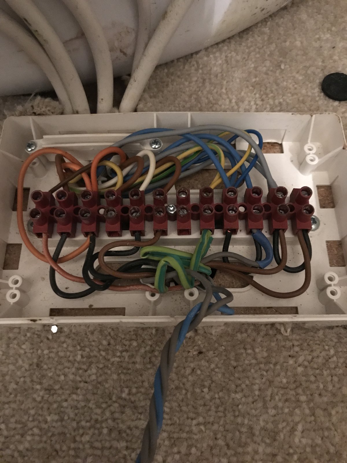

Im a bit of a newbie at this but I’m wondering if I need to alter anything in the wiring centre as the remote sensor is wired into the TP9000, far right terminals in 2nd photo.
As the TP9000 is both devices combined into one, then there isn't a separate thermostat to need the above modification. Although it has a remote sensor the TP9000 actually is the thermostat that does the electrical switching, and the sensor should just be considered part of it so can simply be removed along with it.

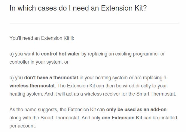

@stem What are your thoughts on Tado with my layout? Could I use their smart thermostat to control heating upstairs (replace TP5000) and then extension kit (with another thermostat) to control heating downstairs and hot water (replace TP9000)?
I would have thought so, but didn't mention it earlier because I' not 100% certain. I haven't installed a multi zone that includes hot water using Tado.
I know you can have single zone and hot water, or two heating zones. Certainly from a wiring point of view it can be done, as long as the Tado software supports it.
Their website talks about only being able to have "one extension kit per account" I'm not sure in practice what that actually means :confused:
However, their website offers a service where they would check what you would need for your system, and there's chat and a telephone number too, so you could check with them quite easily.

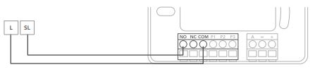

@kasabians you are correct. Your present thermostat is battery powered, but the Hive & Tado Receivers require 230V supply to power them.
Remember though that the Receiver can be located remotely from the Thermostat.
So, for example, with the Hive Thermostat which is wire free, it can be located where the TP5000 is now, and the receiver could be mounted elsewhere in a convenient position for the wiring to be routed to it.
sing-jpg.212014
As well as the new 230V supply to N and L, the wires currently going to the TP5000 COM and N/O terminals will need to connect to the COMMON and NO terminals of the Hive Receiver.
However, with Tado there is the option of a battery operated wired thermostat for a second zone which can replace a wired thermostat.
The Tado receiver then normally replaces an existing programmer controlling the heating and hot water (depending on your installation) which will already have a 230V supply.
