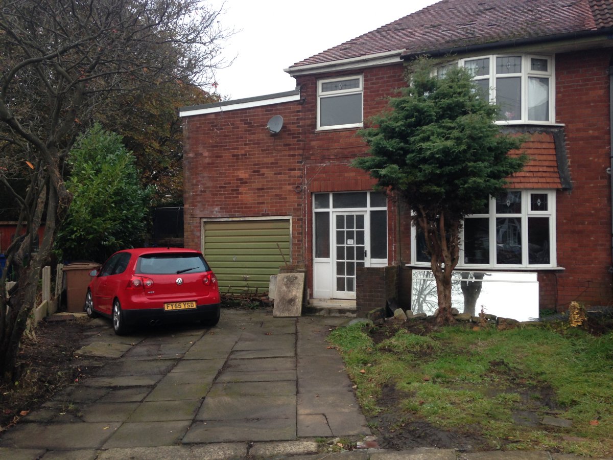

Hi there,
New to this forum, after some advice regarding a hip to gable with a dormer loft conversion.
My house has a 2 storey side extension which currently has a flat roof. I have planning permission to add a roof over the side extension, but at the same time I'd like to have a loft conversion with a dormer, which I believe should fall under PD.
I have a few queries:
1) I've been told by an architect that most councils will not allow for a hip to gable as the property already has an extension. How true do you think this is?
2) I have also been advised that the dormer can only go above the original house and not above the extended part. Again has this happened to anyone before?
3) Lastly Could someone briefly explain the permitted development process to me please, as what happens once I know the work can be undertaken under PD.
All help is appreciated!

Permitted development does not have a process. If the work is PD, or you just build to the PD dimensions and criteria, then that's it.
Thankfully I'm not the one with a cat, but fwiw, here's my 2-cent's worth;
You would need planning permission to put a gabled tiled roof over your flat-roof side extension.
You would not need p.p. to build a flat-roof dormer on the rear roof slope of the original house, as long as it was less than 50m³ in
volume, and did not encroach over the side-extension part (and a few other minor conditions as well).

If a build is going to be p.d., you do not need to apply for a LDC. 'Structural plans' is a Building Control issue (nothing to do with Planning) and you can build with or without plans. The BCO might ask for structural calculations for beams etc.
The porch has no effect any other p.d. extension you may do.

No; if it's permitted development, it doesn't matter as long as it doesn't go above the existing ridge.
But pitched roof dormers would give you less useable headroom.
Thanks Tony,
Just to be sure, it wouldn't be PD to extend this roof (keeping it hipped) over the flat roofed extension would it?
By convention, a new hipped roof over that side extension would normally not be permitted development, as the council would consider the whole extension (ie flat-roof extension plus proposed hipped roof) as one new extension, which would need planning permission because it's two-storey and on the side.
However, there was an appeal case last June (google Hilton v DCLG) which threw this established convention up in the air.
But rather than argue case law with Rochdale council, why not just apply for p.p? In your case you will undoubtedly get it because it would be an improvement to the look of the house.
