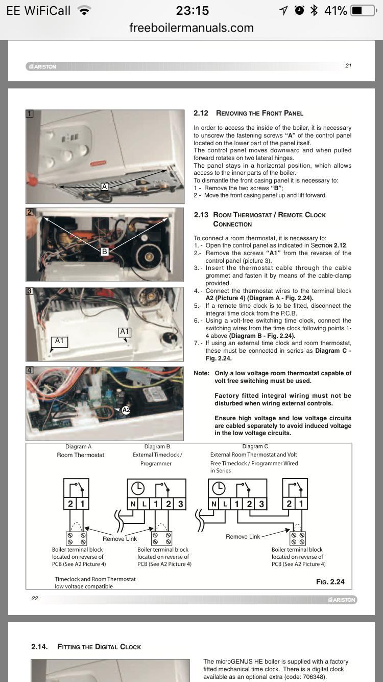

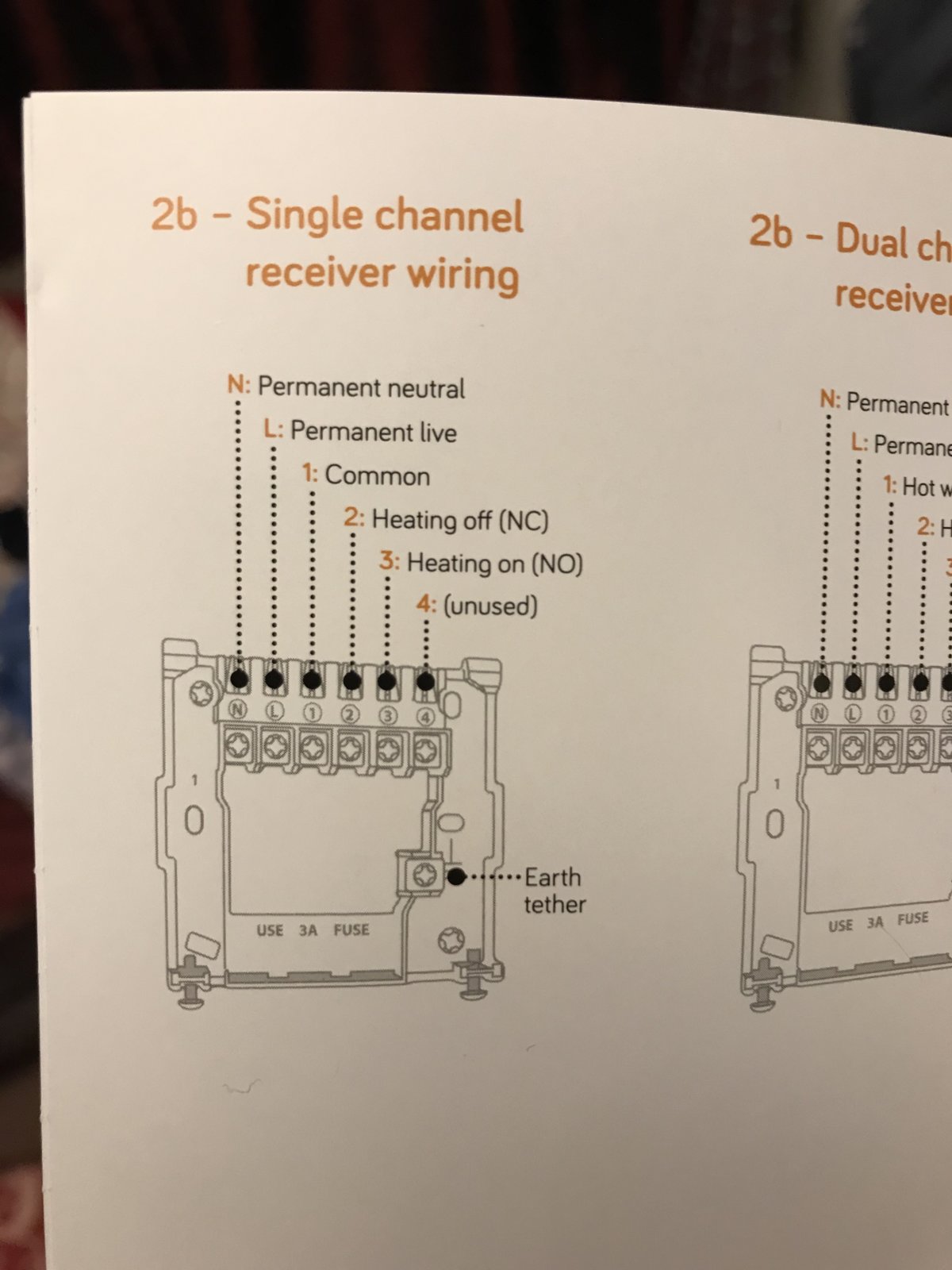

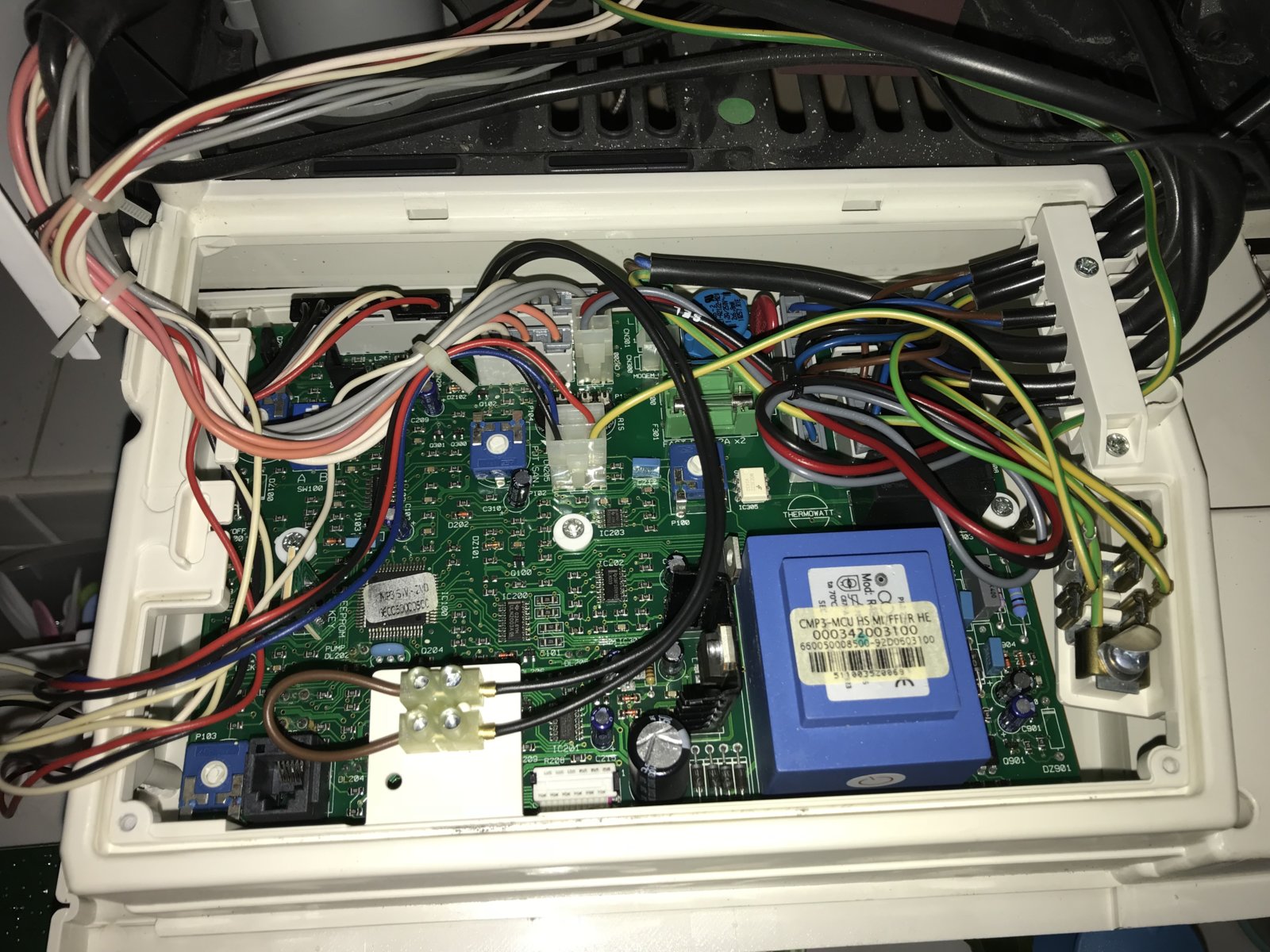

Hi all, I have just bought a Hive 2 system to go with my Microgenus HE system. There is no existing external control system/thermostat and was all controlled by the internal timer, which can’t keep time.
I think I’ve worked out the wiring but just want to check with you guys first as there are some contradicting ideas online.
I’ve isolated my mains supply, L & N, now I’m guessing I run a line from what was the thermostat loop to terminal 1 common and then back from terminal 3 to the other side ofthe circuit and obviously get rid of the brown connecting wire from the loop.
Am I about right there? My confusion comes from Ariston’s diagram which says to connect with terminal 2,heating off.
Any help greatly appreciated!
I’ve uploaded the two circuit diagrams I have and a picture of my PCB.
