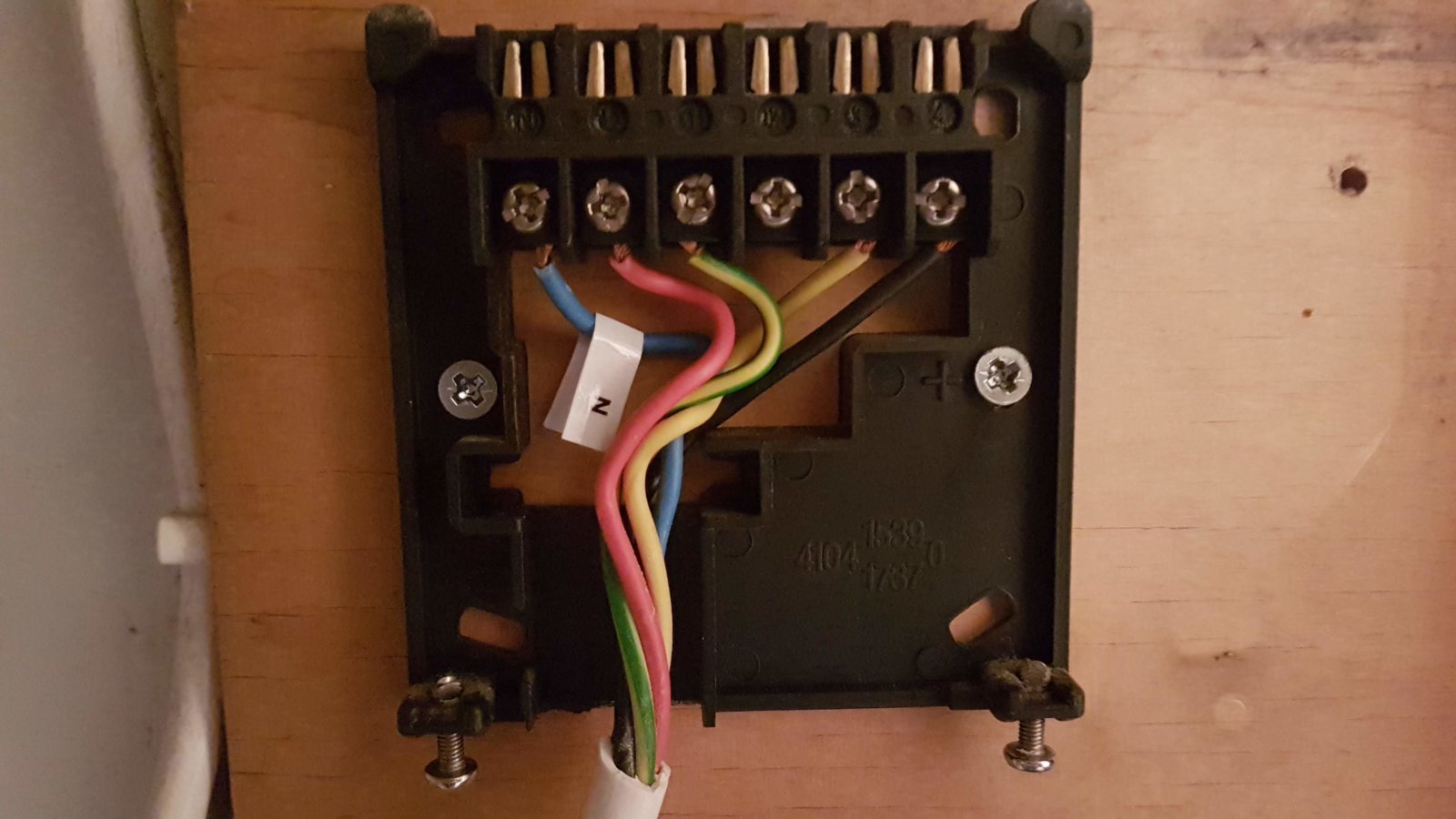

Hi,
Just moved into a new home and planning to replace the existing timer, for heating and hot water, with the Hive dual channel receiver, thermostat and hub.
There doesn't seem to an existing thermostat in the house, only the timer.

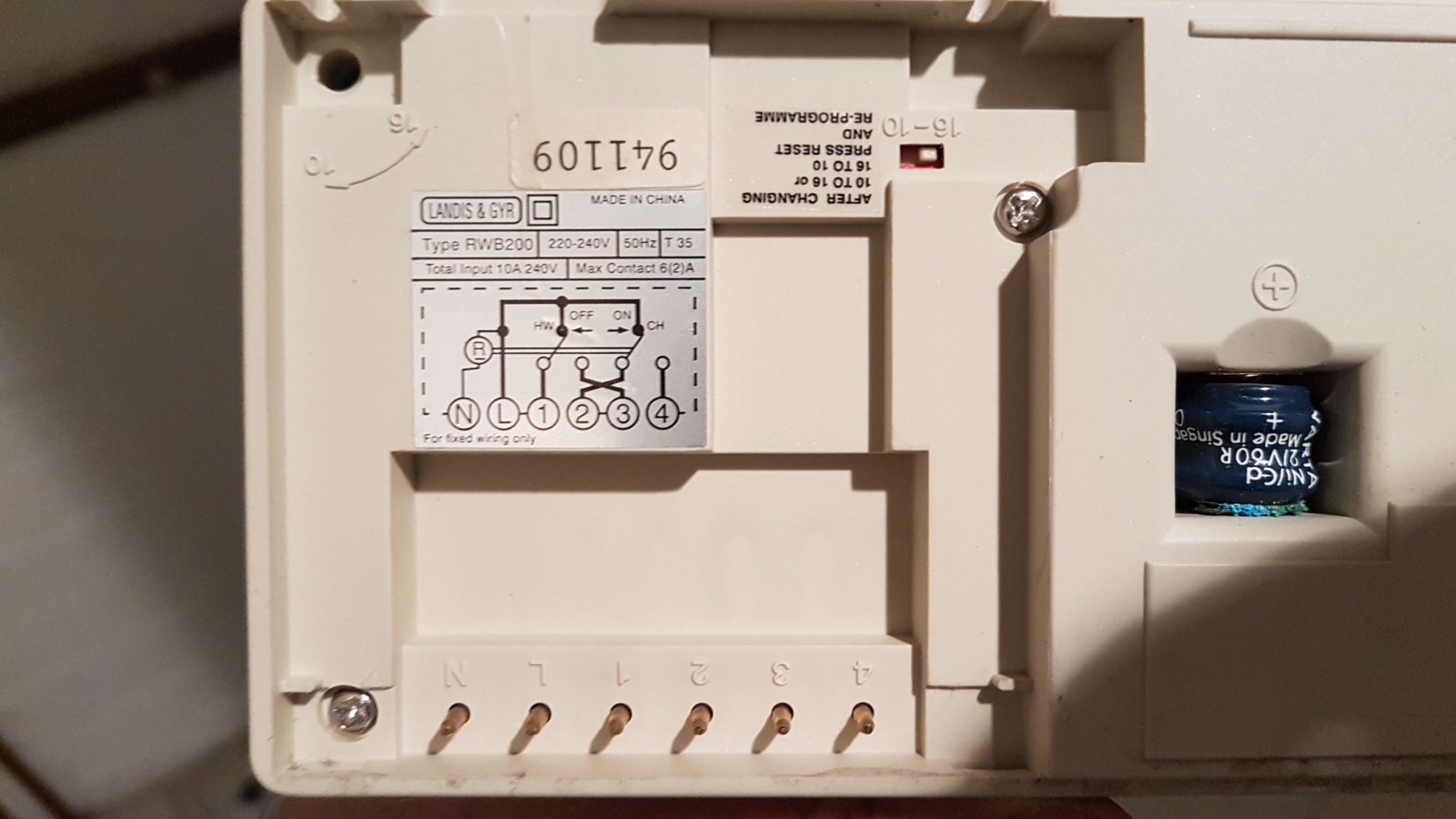

The attached images are of the existing wiring and the diagram on the back of the timer. I note that the mount will fit the Hive receiver perfectly.
Is it feasible to transfer the wires, like for like, to the Hive mount?
Any help will be greatly appreciated. Thanks in advance.

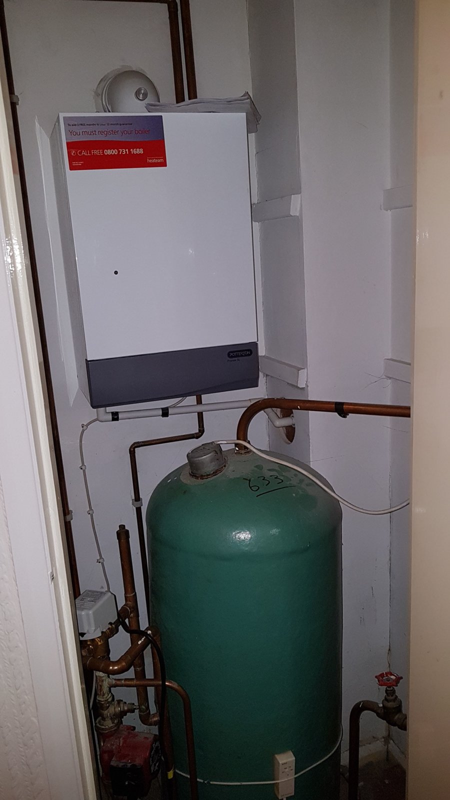

The boiler is a Potterton Promax SL.
