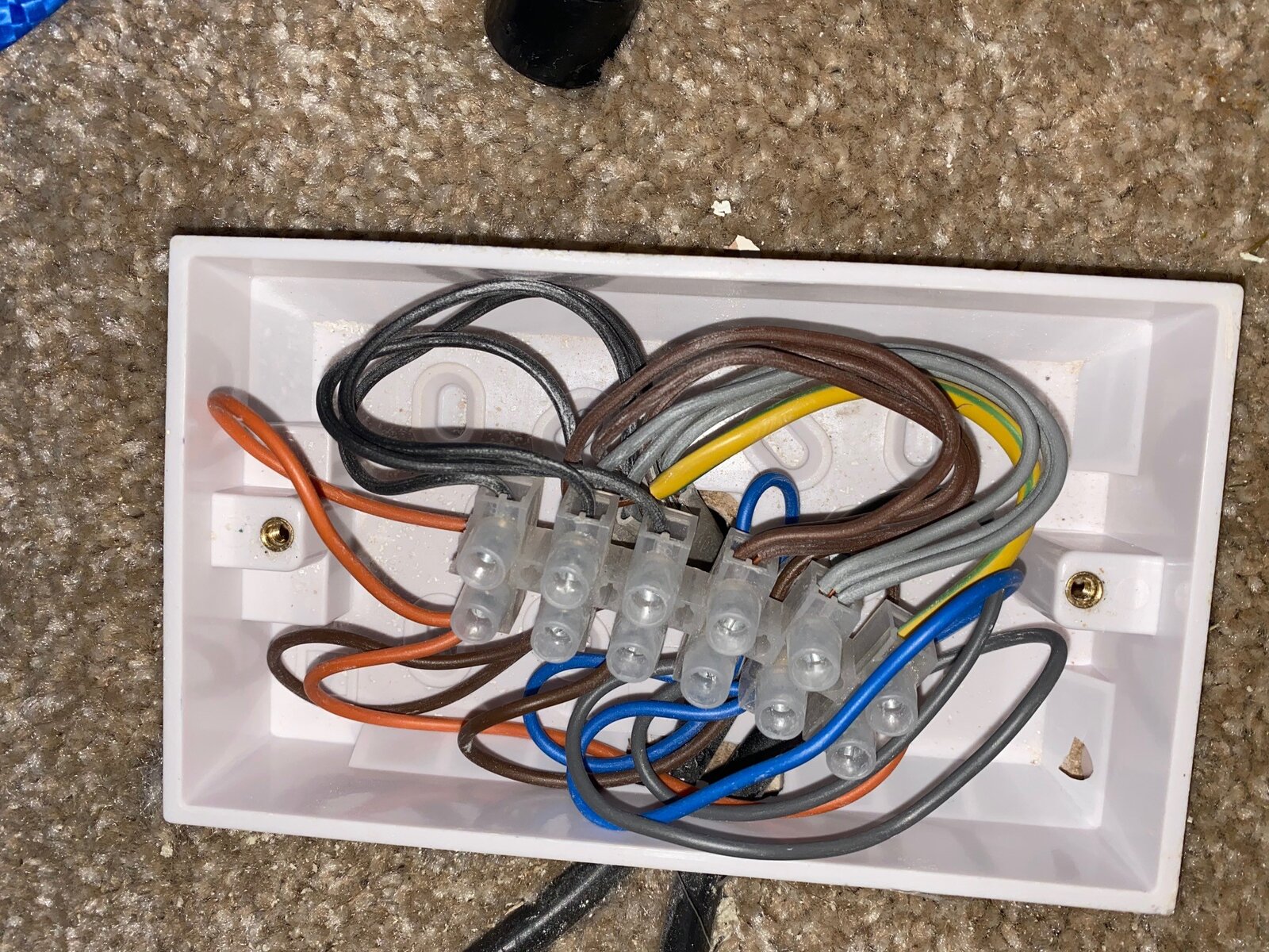

Where do i place my two hive receivers? From the research i have done for my boiler and system, which is two zone heating (downstairs and/or upstairs) i have seen two different opinions.

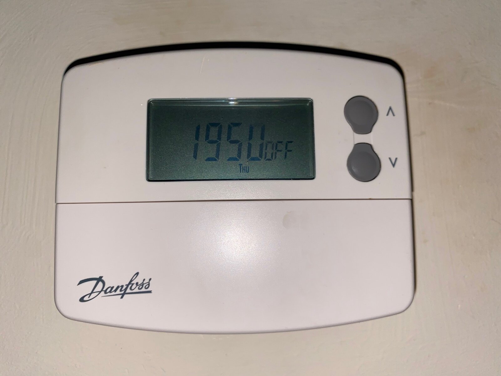

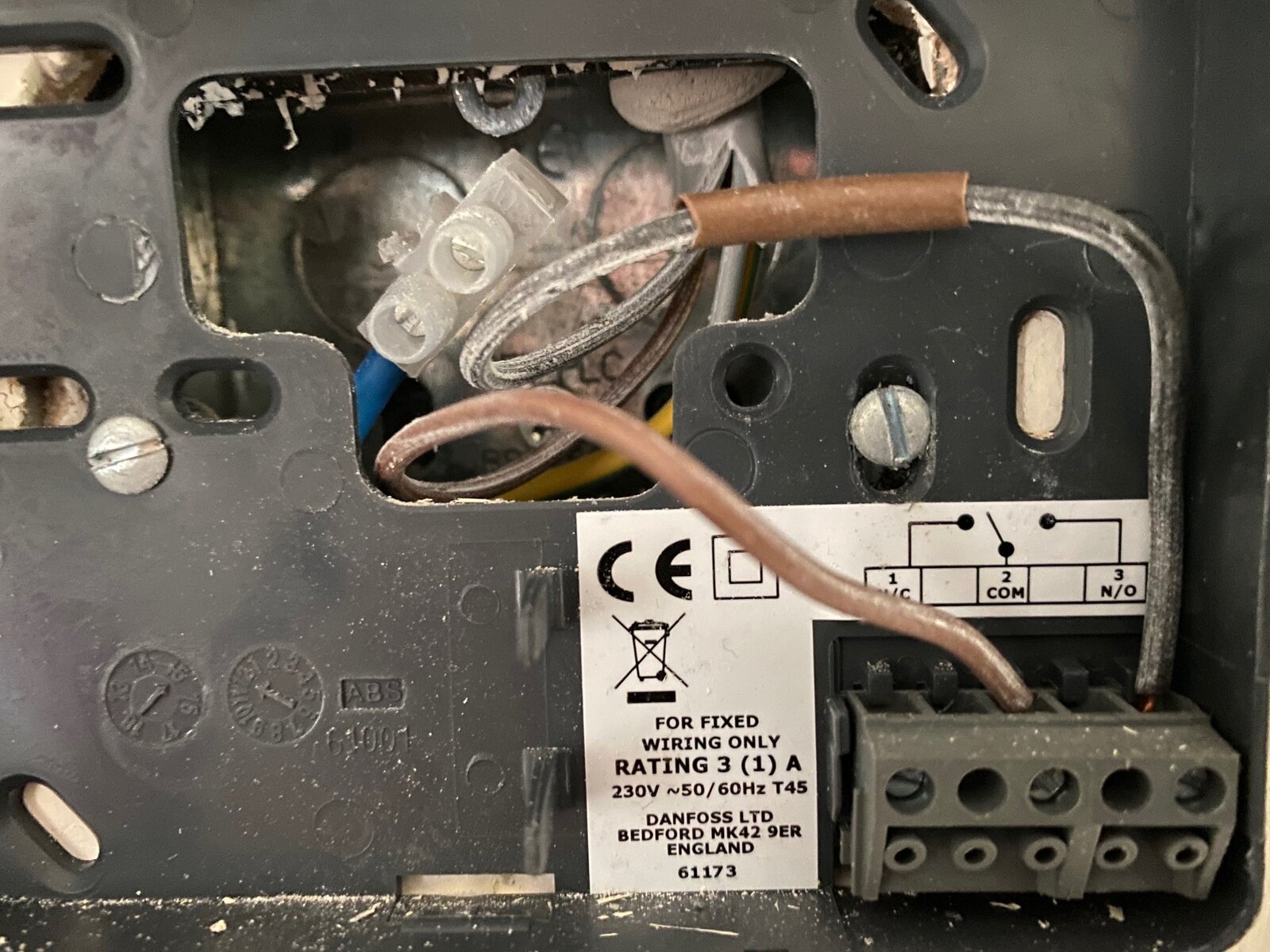

I have two thermostats on the wall, one downstairs and one upstairs which are wired in with two connected wires (one COM and one NO) with an extra blue one (assuming this is neutral) which is not wired in to the thermostats.

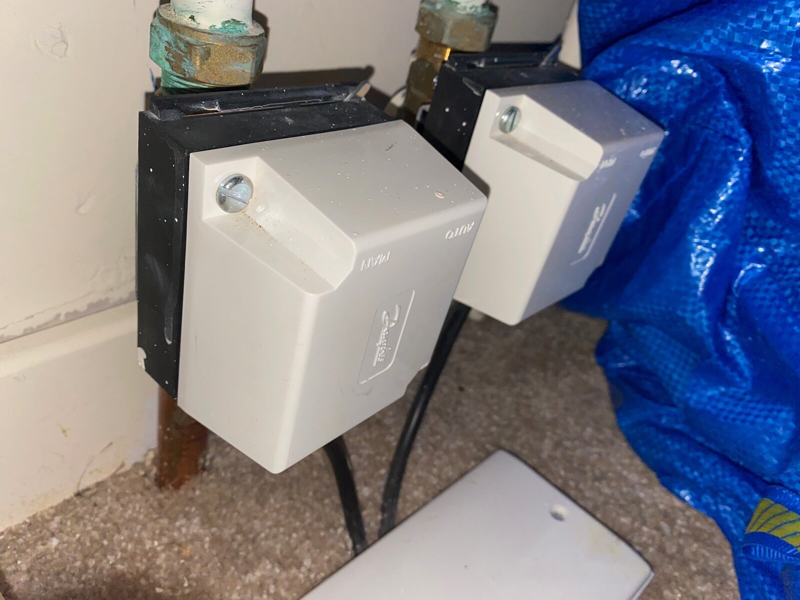

My main question is, do i install the receivers at the thermostat locations and wire them in with the bridging wire from terminal 1 to L on the hive receiver OR do i install these at the main wiring box that is in an upstairs cupboard next to the zonal switching pumps?
I think i am right in saying that i defo do not need to get inside the boiler and wire them both up from there.
I am stuck more on the best location for them - seems much simper if replacing the existing thermostats with receivers as it really straightforward by the looks of it - however if at the main box then more complicated as will need to suss out which wire is which.
many thanks in advance.
