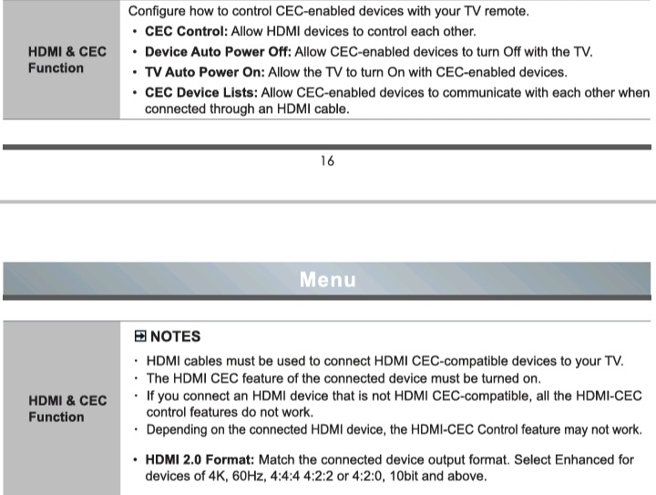

Have you got these options available and operating on your TV?
Connected Equipment Control, may be able to control a modern DVD player, through the TV remote, if it's connected through an HDMI cable.

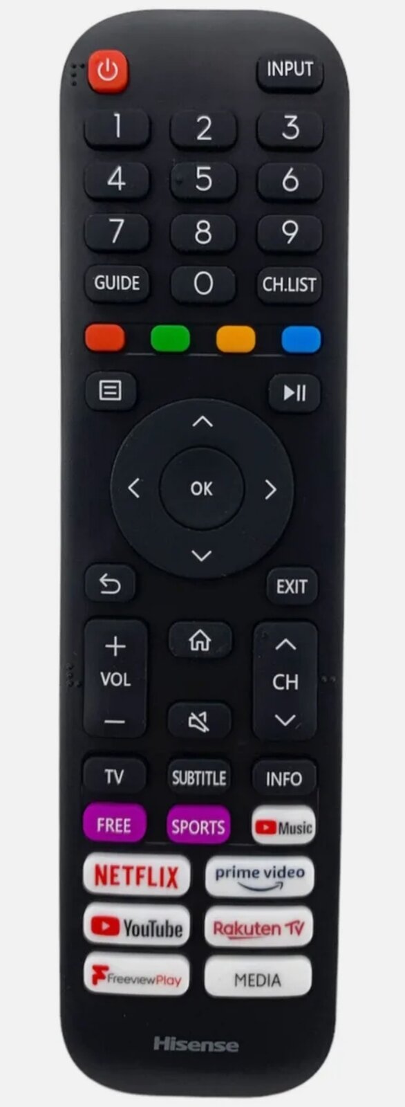

It's too late to connect your DVD player via HDMI CEC. You would need the player remote in order to set up CEC so you can use the TV remote as an alternative, but you've lost the player remote so you can't set this up. Catch 22.
Besides, the TV remote doesn't look like it offers comprehensive controls for DVD/Blu-ray playback. Thatbthen puts you back in the position of "find/replace the original remote"
