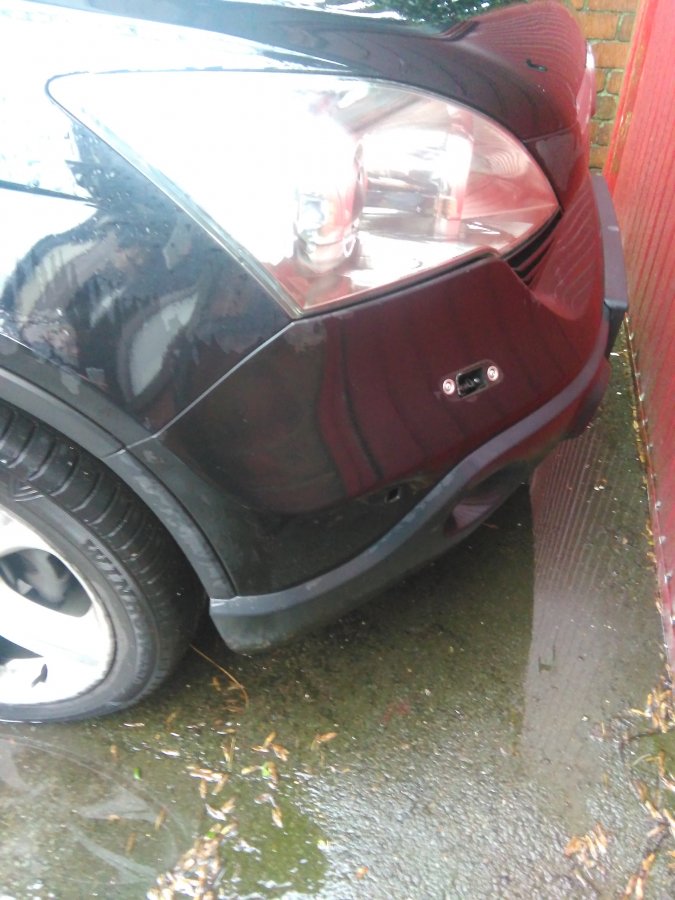

Hi,
I have a Honda cr-v 07 reg, which has recently had some parts knicked from the front driver side bumper.
I know one is a parking sensor, but does anyone know what the other part is? Also any advice on the best place to source tthem?
Any advice greatly appreciated.
Cheers.

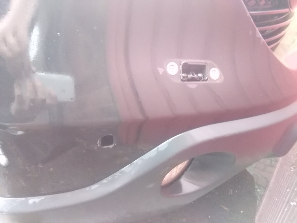

Could the top ones be the headlamp washers, and the lowers the parking sensors?
I guess you could try the washers and see if water sprays out!
John :)
Cheers for the reply, it's definitely not a washer - I should have stated that there's an identical part the other side, it's basically just a plastic cap.
I've worked in a bodyshop for the best part of 10yrs and that sure looks like a headlamp washer with the cover missing to me fella. To fit a cover you need to pull the water nozzle out, this will be very stiff, the next trick is clipping the cover on whilst trying to hold the water nozzle!! The lower hole sure looks like a PDC, hopefully this has been unplugged and the wiring left hanging behind the bumper, if not you could be looking at replacing the whole set (4)
