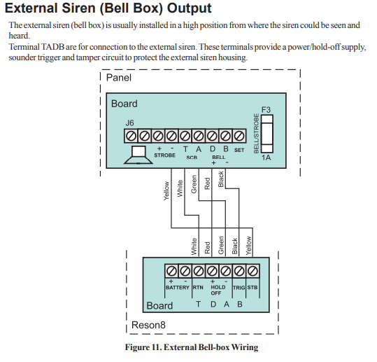

I have a Honeywell Reson8 Bell Box which generally behaves but in the hotter weather the bell box and alarm panel goes off around the same time each day and results in my having to put the alarm panel into Engineering Mode until late afternoon when it becomes cooler. Lately the alarm has been going off in the early hours too and so I want to temporarily disable the tamper in the bell box to confirm whether it's the bell box tamper that's the issue.
Question is how do I go about bypassing the Bell Box tamper circuit from the alarm panel? I've attached the wiring configuration below but I'm unsure what I need to do.
Any help would be much appreciated.

Thanks Sparkymarka, will have a good look at the weekend and check the tampers.. In the meantime if I wanted to bypass the tamper to the bell box, given the above diagram what would I need to do? Do I need to remove the the tamper return and put a link between the T and A at the main panel?
Yes thats correct. This will not stop the bell box sounding if the tamper switch opens, but it will not generate an alarm on the control panel.

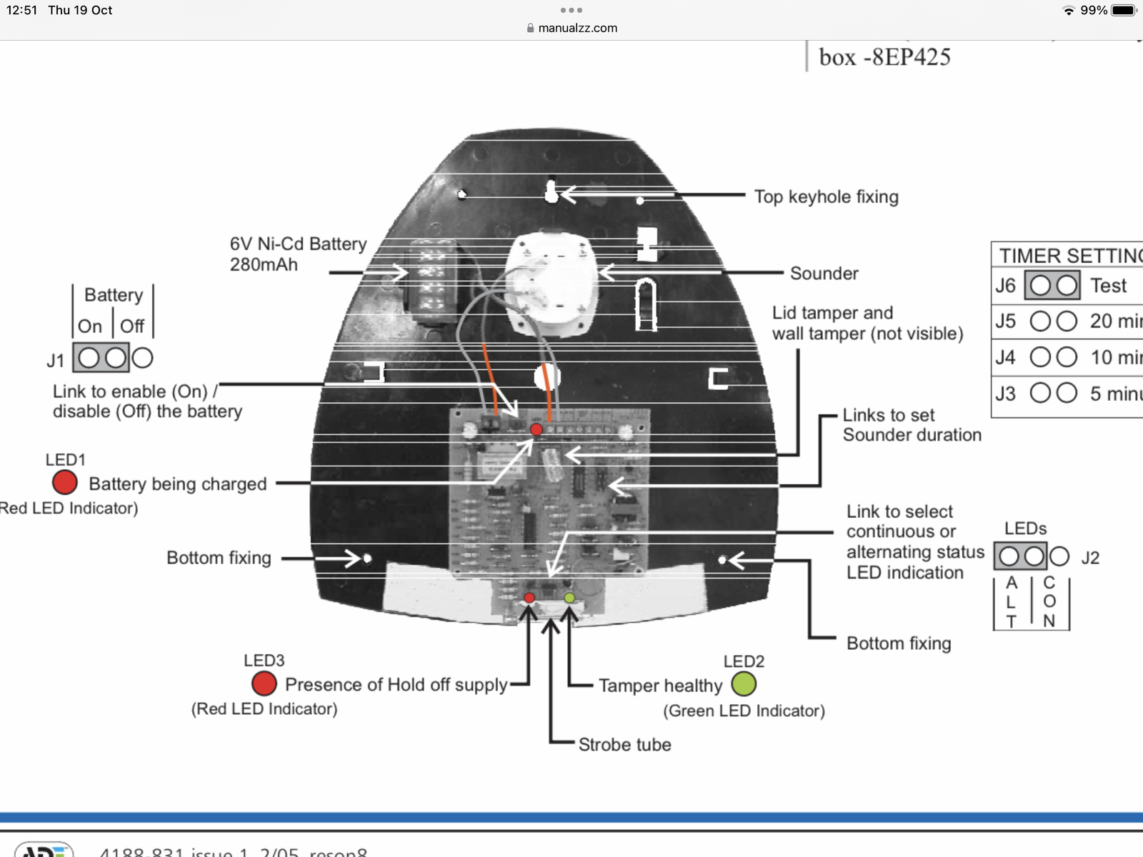

I am not familiar with this kind of bell box but u would have to short out the tamper switch/wiring in the box its self. It may just be a spring on the board

It is spring front and back but mine is fine and not on the edge of going off so I think mine is a Bell box issue.
