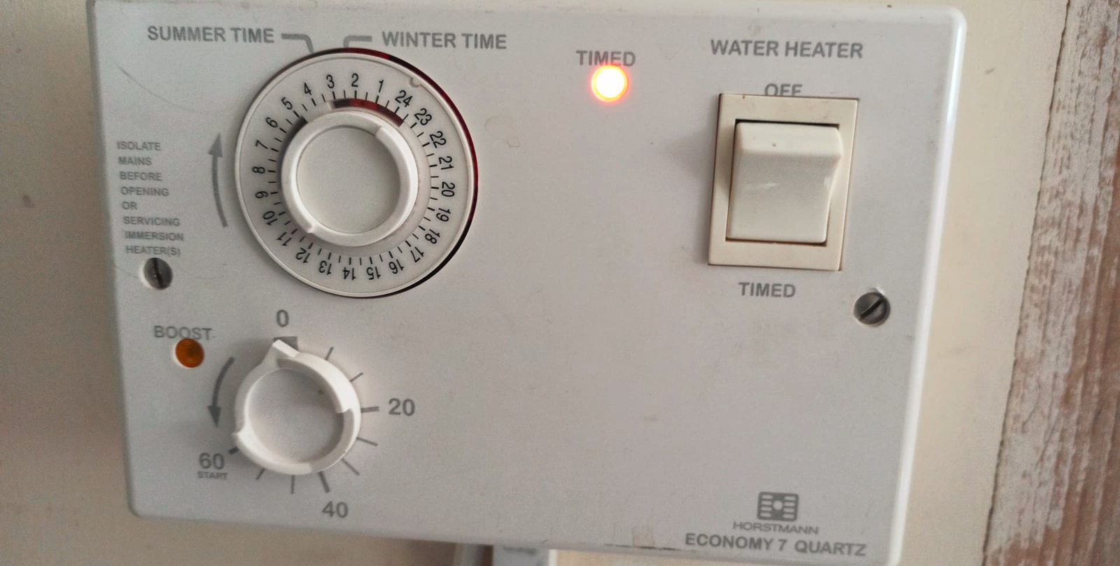

Originally, when connected to old tank, the timer unit "ticked" as it went round. It no longer makes a noise or goes round!
The boost light and timer lights come on - see pictures, but water doesn't appear to get heated.
I suspect the battery. It doesn't look hard for an electrician to re-solder a new one in.
Other possibilities? heating element wasn't wired into new tank correctly, but surely timer would go round and "tick"?
I am trying to avoid the expense & waste of buying a new Horstmann (and would love any suggestions that don't involve buying a new Horstmann!). Having got very inspired by a fantastic post on mending a Miele washing machine (only 2 components for less than £5 needed!!), I have renewed vigour to mend things.
Boost light comes on, but dial doesn't move.
Night timer light comes on when I manually turn timer round to 3.30 am. Timer dial doesn't "tick" or turn automatically.

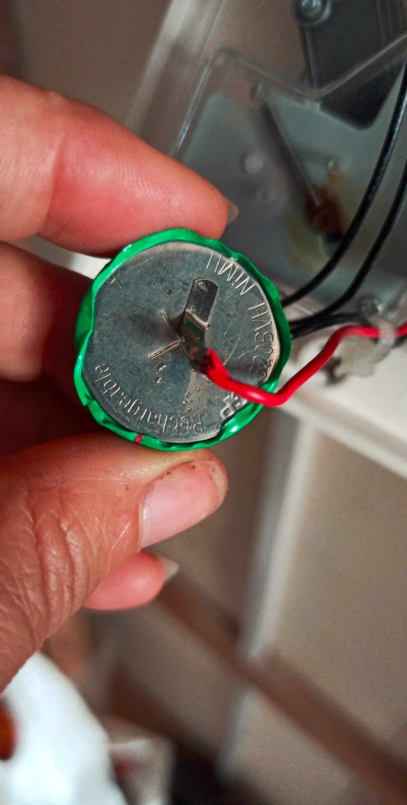

Above is picture of mine and the writing on it says: Rechargeable; A; NIMH
and same number as CBW's reply! 320BVH And as you can see, it has pig-tails. I think even I can solder onto that!
CBW- thank you! will try that.
I measured the voltage - it may as well been a lump of metal, I have never seen a battery at 0.1 V!

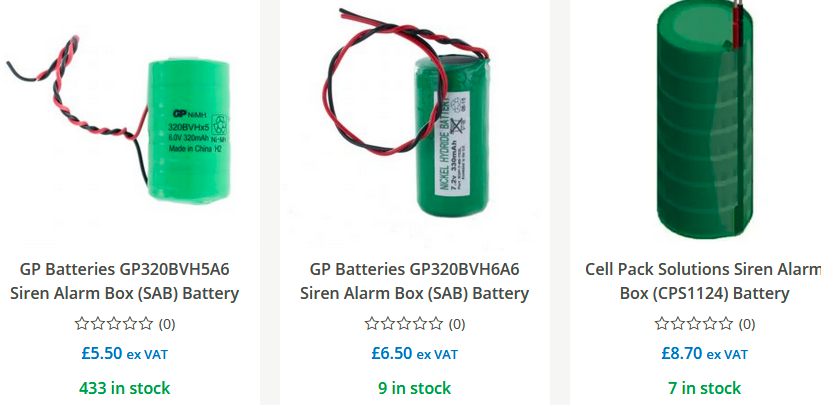

I did find this though, you could always contact them and see if they’ll make you one, or if they stock it?https://cellpacksolutions.co.uk/
Also maybe contact GP batteries or Horstmann?.
I checked GP Batteries, and nothing again. I have emailed Cell Pack Solutions.
I really wonder what I am doing wrong with my searches!
On cellpacksolutions there were these. They have numbers after (and are different shape, although I don't mind that) - am I looking for one without numbers after?
Sorry I dont know, I would try RS Components, google 320bvh nimh there are loads, see if you see one that matches yours, wouldnt have thought it would be the battery to be honest, most likely the motor
