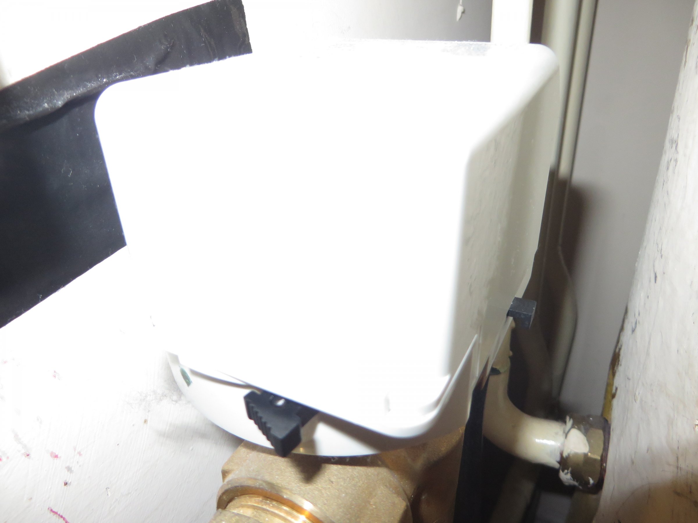

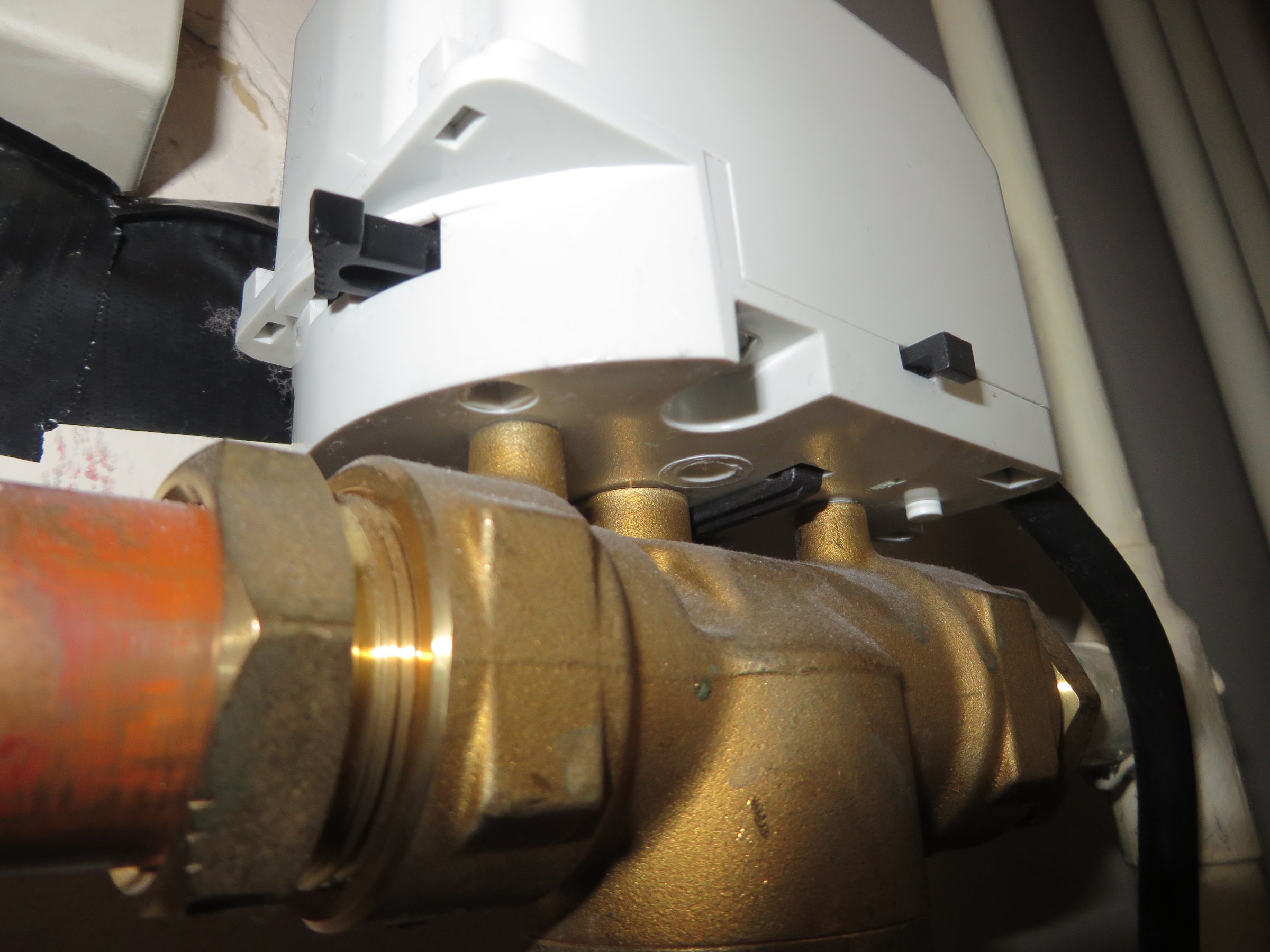

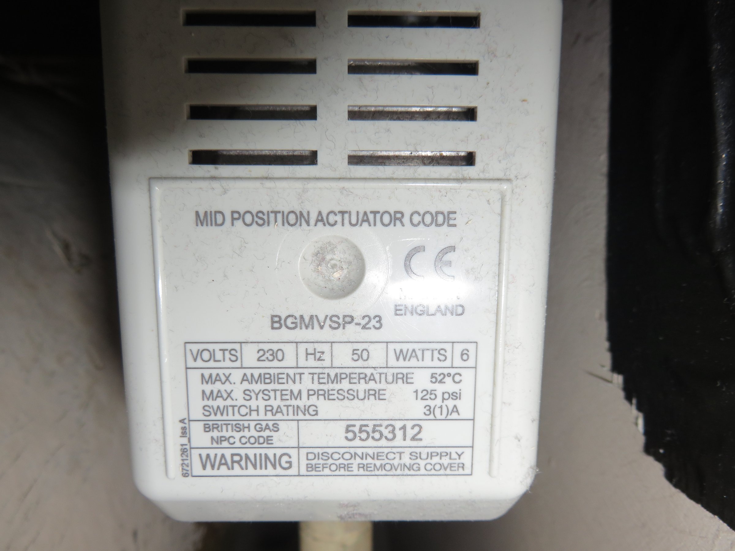

i've just nipped home at lunch to take a photo of the motorized valve and the heating AND hot water both appear to be on! i've got no idea what's happening, there doesn't seem to be any logic to it! i've attached a few pics of the motor valve. as you can see it's got a lever on the front and something sticking out of the side. from what i can tell, the thing on the side does nothing. i've pushed it in a little but it doesn't seem to do anything. i can't pull it out any further. however, the lever on the front moves when the power is on, but once it's in position you cannot move it manually. if i turn off the power, the lever moves back over to the far left on it's own (presumably closing the valves) and then i can then move it back over to the right freely, but it always 'bounces' back to the left and i never know whether i've opened up hot water or heating, or both, etc. however, with a bit of trial and error switching it off/on and moving the lever i can influence whether it's the hot water or central heating that starts to work...

At rest, the valve sits at the hot water only position (the central heating port is closed off) where it is held by a spring. In this position when you slide the lever you will feel the resistance of the mechanism and when you release the lever, it will be pulled back to rest by the spring.
When heating and hot water are required the motor winds the valve to the central position so that both hot water and heating ports are open.
When heating only is required, the motor winds the valve fully across so that the hot water port is closed off.
Once the motor has moved the valve from the rest position, if the lever is moved, there will be less or no resistance, and it can feel loose and disconnected. The main purpose of the lever is so that both ports can be locked open when the system is being filled with water.
Whilst all 3 port valves are similar, yours looks like a Drayton that has been re-badged by British Gas. You can find a manual here.
One of the foibles of a 3 port valve is that it can stay energised, even when the programmer has turned off, and this can cause some confusion.

thanks for the link to the manual, i've taken a look and i've also googled drayton 3 port valves. i've found an installation guide which says "When the manual lever is moved to the right and pushed in to ‘lock’, both outlet ports A and B are open, it automatically releases when the valve is powered."
the problem is, the valve is powered from the same supply as the pump and the programmer, so i can't leave the valve turned off. the statement above seems to suggest that when the valve is powered the lever is going to automatically revert to it's resting position?
I suspect that the valve has been moved by its motor to the heating and hot water position. At this point the boiler will be under the control of the hot water cylinder thermostat and is running, so both hot water and radiators heat up. Then, after a while, when the hot water was up to temperature, the cylinder thermostat would turn off the boiler, and the valve would wind to heating only. Normally when this happens, the microswitch in the motorised valve would take over and keep the boiler running. If the microswitch was faulty it wouldn't, and so the boiler and pump would go off. That means that the valve could well be in its correct position, but as the boiler and pump are off, everything cools down.
However, the only way to be sure is to check the wiring with test equipment and find out if the right control signals are there or not. Alternatively, you could try swapping the valve actuator and see if that fixes it. If not, it's back to the drawing board and you will have a spare for when it does fail.
