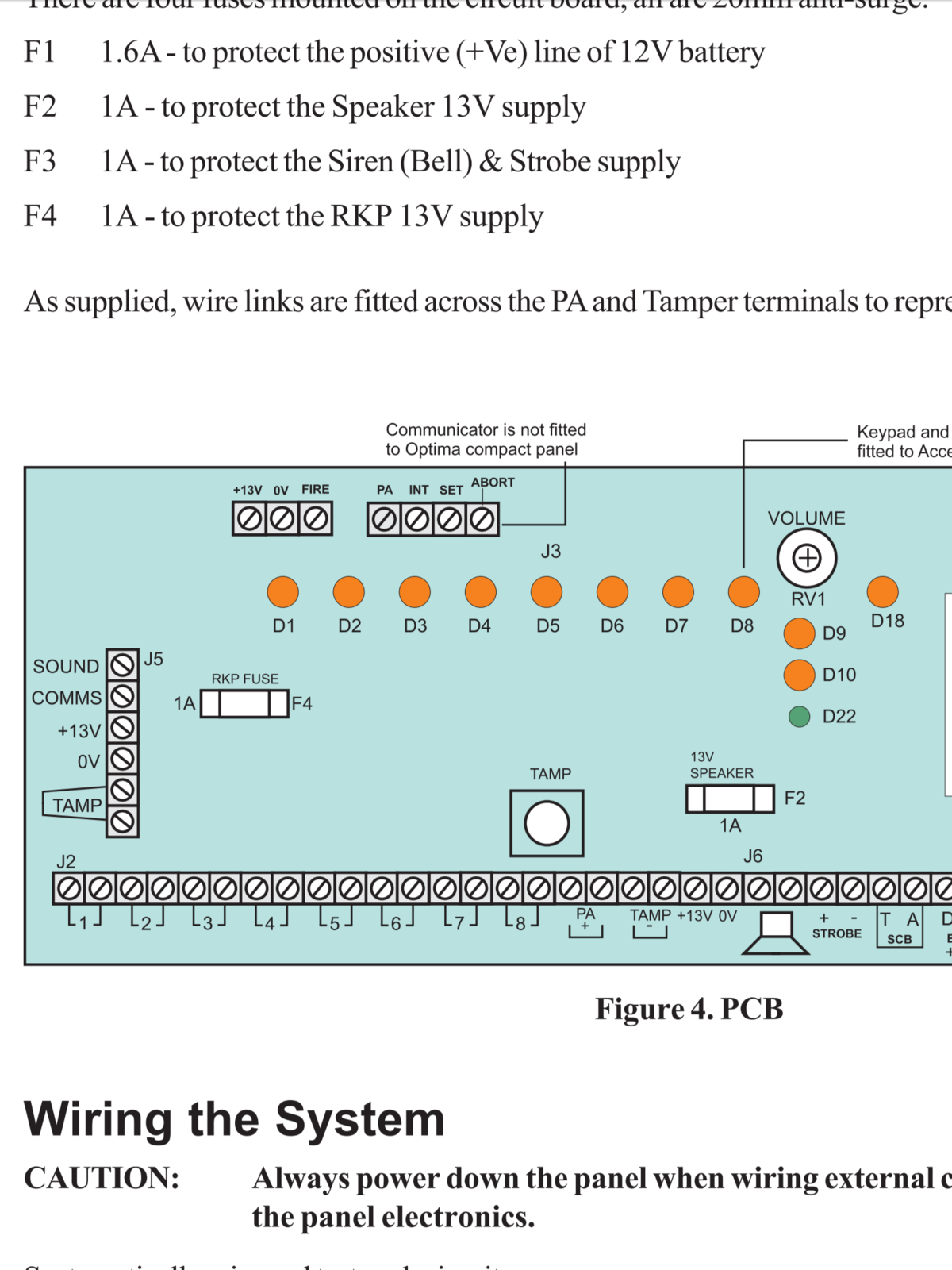

Swapped burnt out circuit board pics below for a new one + new battery, each wired connection swapped over. Factory bridges refitted connected wires removed. Nothing is connected to the fire sensor terminals (top left). Intruder sensors are wired into terminals 7 and 8. Prog setting all fire is No / Off. Alarm activated with FIRE - zone eight, I removed connections. Then FIRE - zone 7 again removed connections. “fire fault lockout” then shown? Reconnected 7 & 8 still “fire fault lockout” and sensor 8 no longer functions. How can I solve this anybody? Or do I have a faulty new circuit board? Note on first power up had TAMPER FAULT LOCKOUT strongly suspect this is from the external SCB - Self Contained Bell box. As I cannot get any sound from it only flashing light.

On the circuit board top left hand side are 3 terminal blocks marked +13V - 0V - Fire.
Brand new complete alarm panel and LCD display from Amazon. Only Swapped out circuit board and just in case something had changed the separate LCD display unit.
These are the outputs for a communicator

Hello Sparkymarka, nothing wired to that terminal. Only Zones 7 and 8 which can be programmed as fire zones. Extract from the manual Pg 7
"The fire zone detects fires all the time and will operate whether the system is Set or Unset" this was what was occurring indication zone 8 which is were we were standing so it detected us? Hence why a disconnected the sensor cables into the panel. then it sounded fire from zone 7 a bedroom we were not in - nothing to detect. Really confused me. Disconnected zone 7 it then gave this FIRE FAULT LOCKOUT! reconnected Zone 7 and 8 now will not clear this lockout fault also zone 8 sensor has stopped working.

Zones 7 & 8 can be programmed as INTRUDER zone,exit zone of fire zone.
If you have a pir wired into these zones then they should not be programmed as fire.

The reason the resistor failed is .....the battery was not replaced and it burnt it out , a common issue on these cheap panels
Finally got back to the brother in-law’s alarm. Kept all the Tamp etc, links in per instruction manual. Confirmed sensor 8 – porch, including siren in external bell box not working, although strobe functions. Put link in 7 and 8 per sparkymarka suggestion - FIRE FAULT LOCKOUT! Disappeared resulting in Fire in porch alarm.
Factory reset the board per Secureiam suggestion. Went through the manual setting everything up again. Fantastic no fault codes showing – worked correctly.
Rewired Sensor 7 and 8 in again – came up with sensor eight fault. Put link back in 8 all OK.
