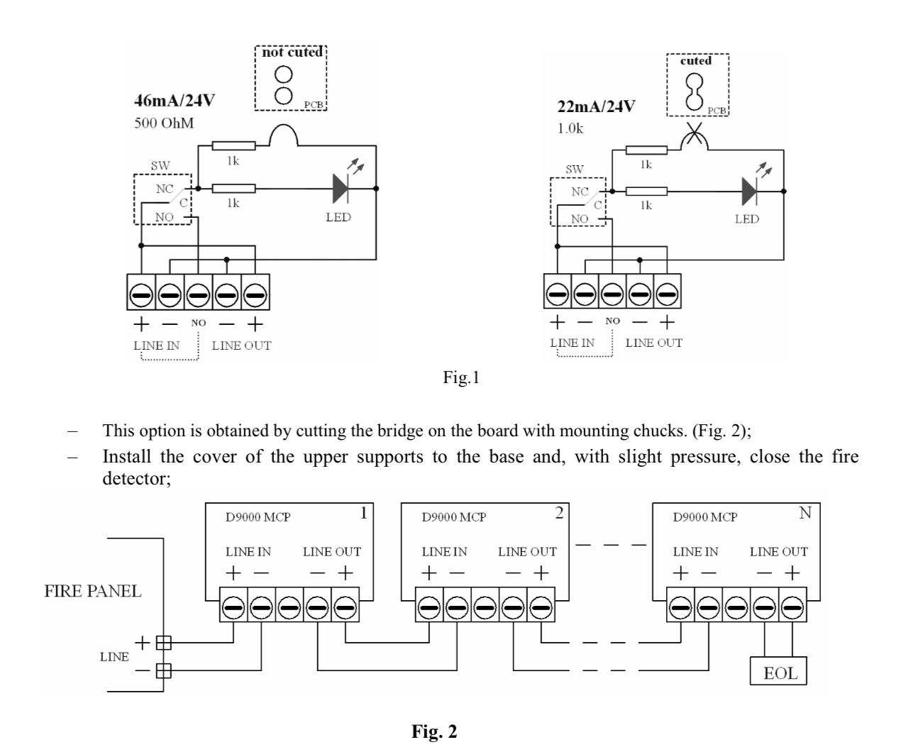

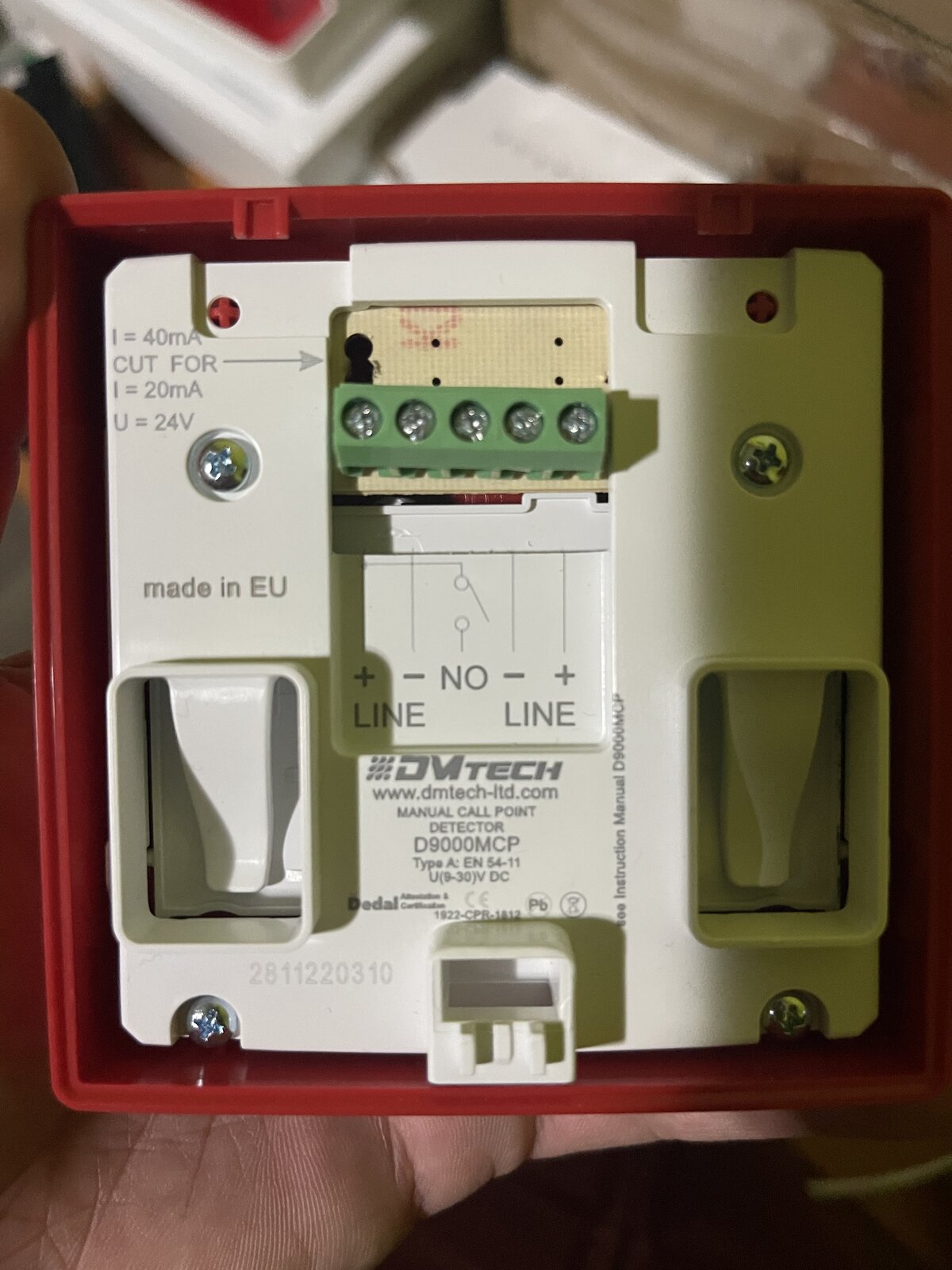

S slkgam Joined 23 Sep 2022 Messages 8 Reaction score 0 Country 27 Dec 2022 #1 Trying to connect 2 smoke detectors and one call point, once i connect the call point zone is always open. My manual call point has this pins, how should I connect it to work properly? Last edited: 27 Dec 2022

S slkgam Joined 23 Sep 2022 Messages 8 Reaction score 0 Country 28 Dec 2022 #5 T1GERIII said: What alarm panel is it? These MCPs are 24v operation Click to expand... If you see on the back of the mcp it says 9-30v
