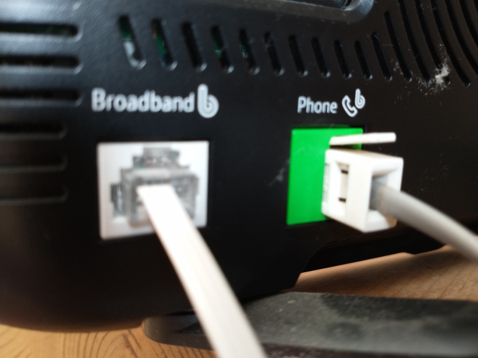

2) My version of BT instructions continued.
At back of BT router remove sticker from the area labeled 'phone'.
Put teh cable from you telephone into hole marked Phone.
Test your connected telephone by calling someone.

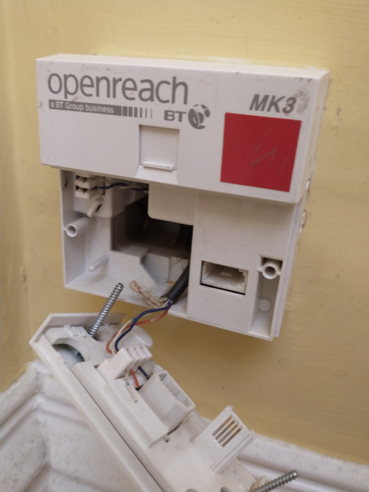

3) Remove lower faceplate of Master Socket.
DO NOT REMOVE ANY CABLES
Leave (top/lower) 'router' section of the Master Socket pushed against the wall.
The cable at 9o'clock (on Left) is the cable from BT coming from outside of your house into your house.
Inside the section of the Master Socket that is still on the wall, this cable is split into two cables.
- One cable goes directly to the socket at the 12o'clock (top) and contains the ADSL and the new digital telephone information. And your Router is connected to this upper socket.
- One cable has a filter on it to remove the ADSL signal and this goes to telephone socket hole at 3o'clock (right).
The visable cable at 6o'clock (bottom) that is coming off the hanging bit of plastic goes to all the other telephone sockets in my house.
The issue is that when this bottom plate is plugged in it connects my all the telephone sockets in my house to the BT signal, but this now no lomger provdes a working phone signal.
So I have to disconnect all my home sockets from the BT incoming line.
Having the two parts of the Master Socket separated like in the image is doing just that as the front hanging plate is not plugged in.
But you cannot leave it separated like this.

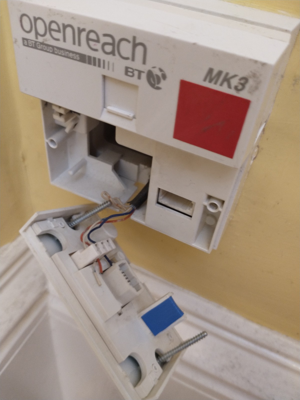

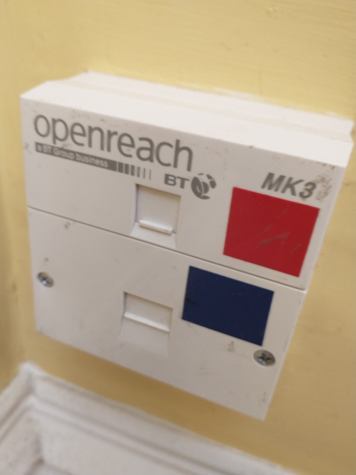

4) The solution is to put a bit of electrical tape (blue tape used in photo) over the plug to isolate the BT incoming cables from the Phone socket on the Master Socket and from the home sockets when it lower faceplate of the Master Socket is plugged back in.
Put insulation tape over the protruding plug and plug teh lower faceplate back in to the main body of the Master Socket.
Put a phone into lower socket and you should now hear nothing as it is disconnected from the BT incoming line.
Remember to plug the router cable and router into upper socket of Master Socket.
5) So you should now have no dial tone on your home telephone sockets.

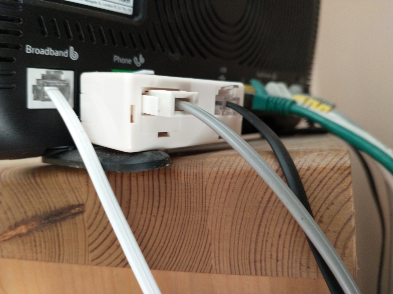

We now have to get this working telphone signal from teh back of teh router into the Home phone sockets.
On the back of the router split the "phone socket' into two phone sockets using 2 way splitter.
Search for "phone 2 way adapter"
https://www.google.com/search?client=firefox-b-d&q=phone+2+way+adapter
Plug your phone into one side of the splitter and test that phone works.
Get a phone extension cable that has a BT Plug on both ends.
Plug this into other side of the splitter, and then plug other end into the lower hole of the master socket (only after you have made the modification with tape as shown above).
Search for "BT plug to plug"
https://www.google.com/search?client=firefox-b-d&q=bt+plug+to+plug
(note that my photo shows a less perfect solution using a spliter with a BT phone conntection and RJ11 connection. Above links are better solution).
6) Your home telephone sockets should now be disconnected from the Master socket, but connected to the "phone" connection at the back of the router.
And so your phones and alarm signals will go though your home phone sockets, into the back at the router at the 'phone' socket, be converted in to ADSL signal and connected to the BT system outside your house using ADSL.
