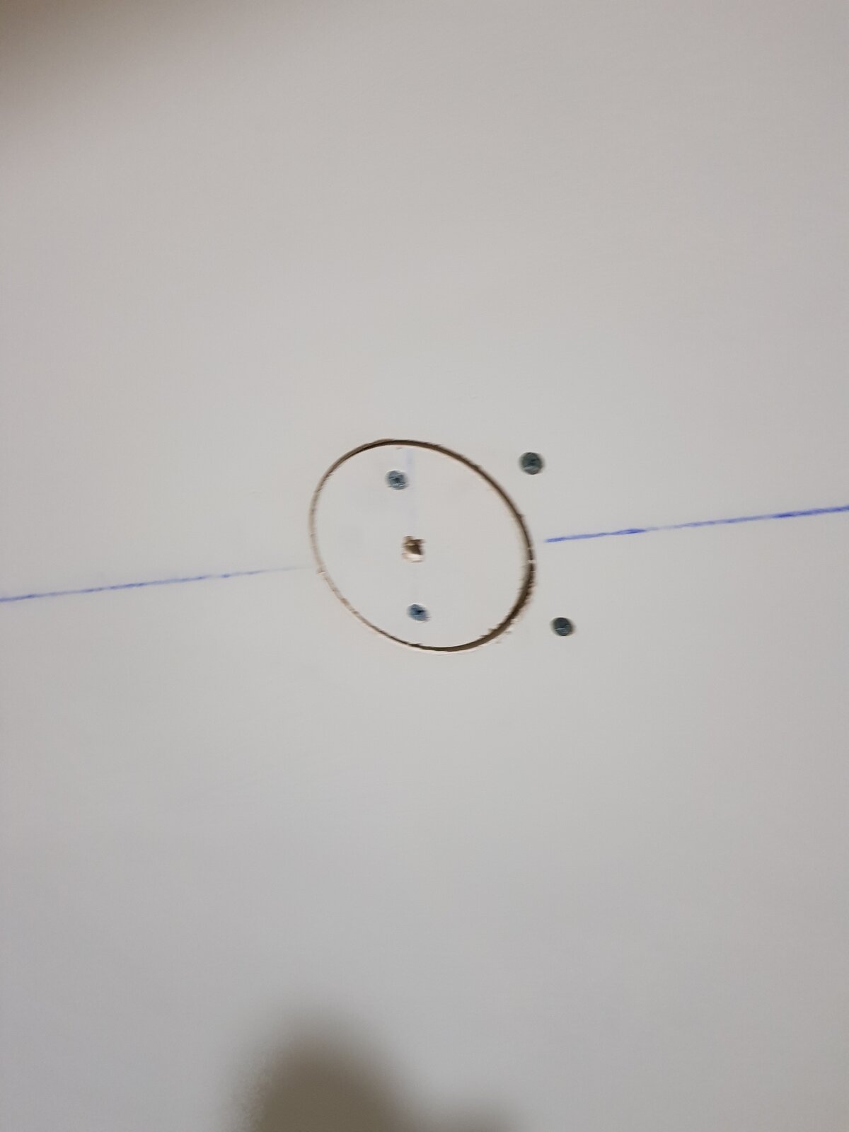

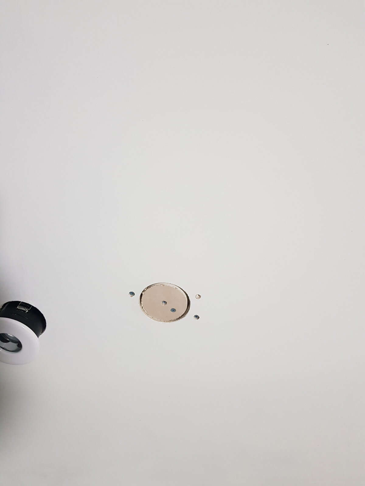

J Jonny Vee Joined 22 Nov 2019 Messages 623 Reaction score 12 Country 19 Nov 2020 #1 I had to open few hole to fish out cable for downlights. How do I make good on the right way? Attachments 16058118523936710093742893981147.jpg 57.5 KB · Views: 185 16058119341947930277660163409594.jpg 66.3 KB · Views: 187
Alastairreid Joined 21 Nov 2008 Messages 7,112 Reaction score 1,307 Location uk Country 19 Nov 2020 #2 Skrim tape easi-fill and sandpaper.
J Jonny Vee Joined 22 Nov 2019 Messages 623 Reaction score 12 Country 19 Nov 2020 #3 Alastairreid said: Skrim tape easi-fill and sandpaper. Click to expand... Will keep same level without any build up?
Alastairreid Joined 21 Nov 2008 Messages 7,112 Reaction score 1,307 Location uk Country 19 Nov 2020 #4 You can feather it out over a few inches either side of the patch, will need a couple of coats.
D dontbelieveawordofit 19 Nov 2020 #5 dont need scrim . stick the old bits back , slightly lower if possible and skim over with toupret filler.
J Jonny Vee Joined 22 Nov 2019 Messages 623 Reaction score 12 Country 19 Nov 2020 #6 What the best way to mix filler. Water only, paint only or water and paint?
dilalio Joined 20 Mar 2009 Messages 13,957 Reaction score 5,937 Location Potters Bar Country 20 Nov 2020 #9 PVA edges of plasterboard holes and biscuits before filling.
