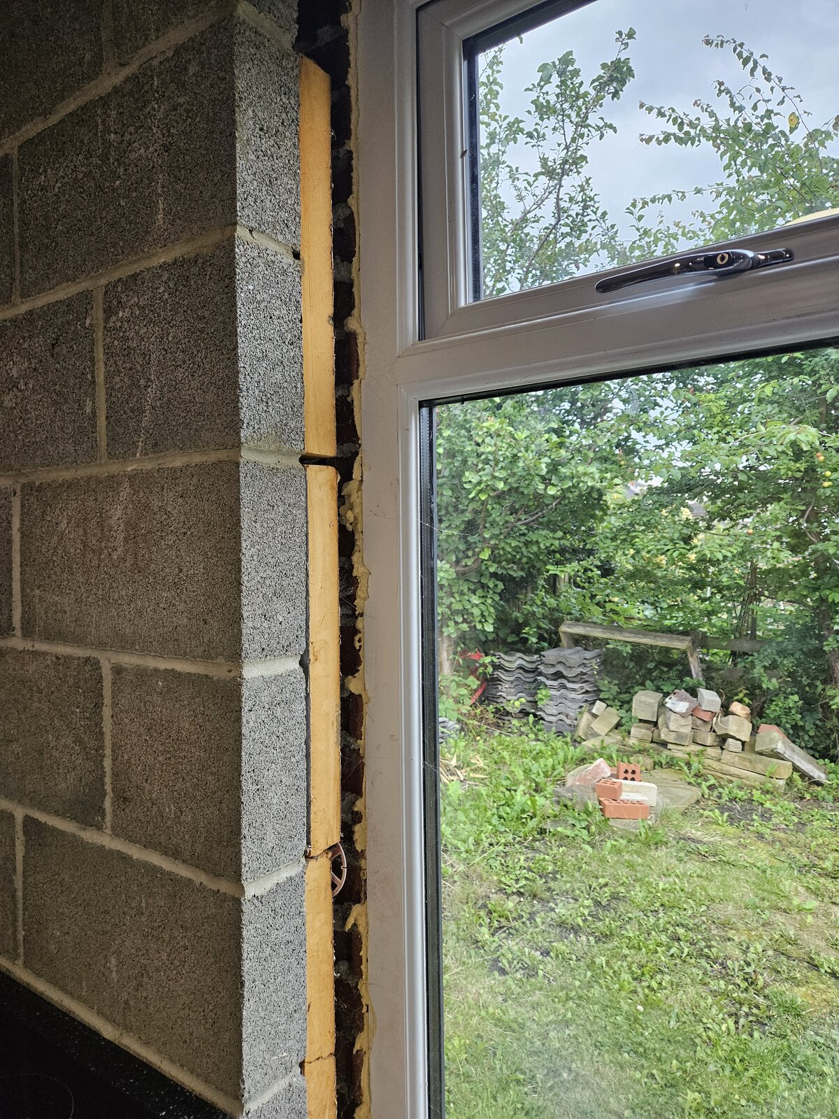

just a quick one.
so this is my garage. Wanting to hide the cavity. Just a garage so doesn't need to be super slick. It's not getting plastered BTW. Just thought if there's any products out there I don't know about.
was initially thinking cavity closer but don't think they'll be thick enough to cover insulation part and don't think they'll have a solid fix if fitted now. (Yes I know they should have been fitted before the window was installed.)
other thing I'm thinking about is getting some fascia boards around it. With the lip of the facia wrapping around the wall.
Upvc utility board is probably better suited than fascia board.

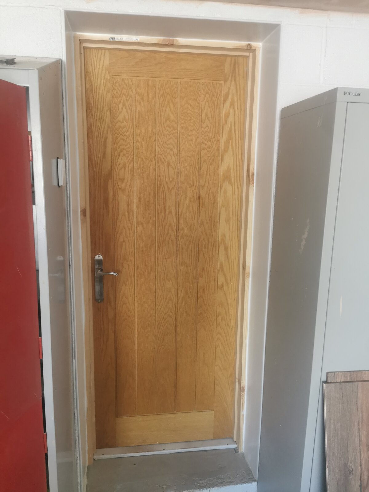

I'll be doing the same round my garage windows and have already done around the internal door opening which had the same issue.
That's a good shout , do you have any pics of the end product? Did you also cover the lintel for aesthetic?
Expanding foam and some 100 or 120mm bullnose capping would be better than fully lining the reveal, IMO.

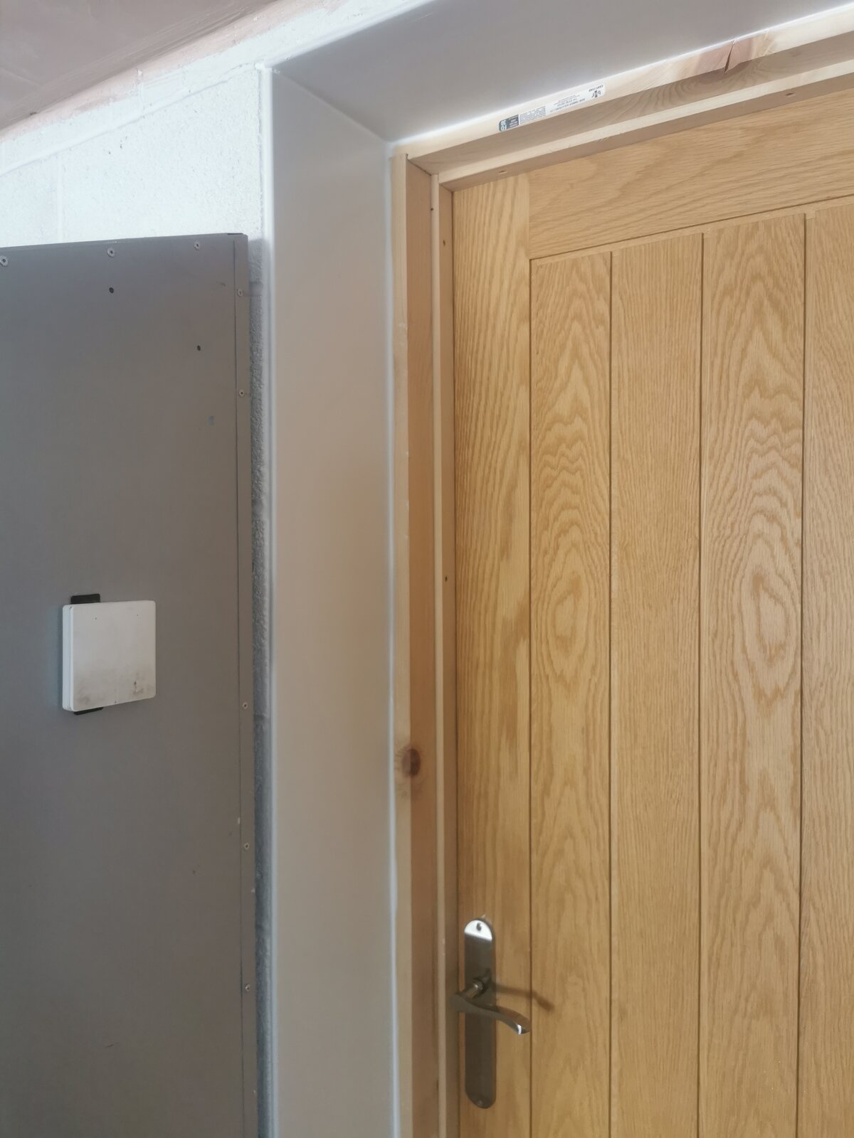

Sorry for the delay, below are a couple of pictures of our garage door, I'll be doing the same to the windows at some point.
Looks good. Hoping it to be delivered later this week and try putting it on weekend.
