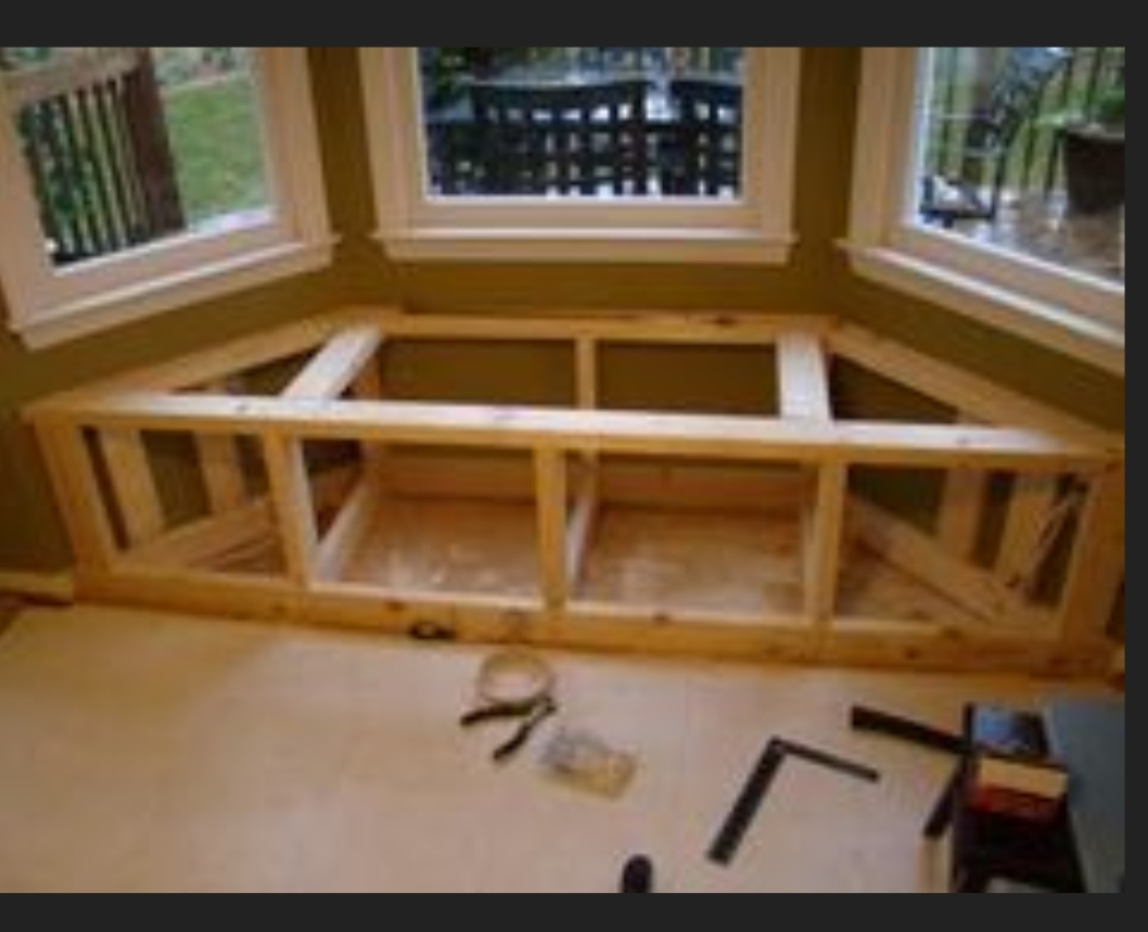

That looks great, my bay area is much smaller but the idea is the same. I was going to do something very similar to the following, which involves drilling all the pieces into the wall and then attaching the seat top.
I guess if i build it properly it could also be free standing like you say, didn't think of that.

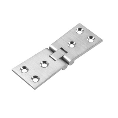

countertop/bar flap hinges are nice for that kind of job
depending on style of house
