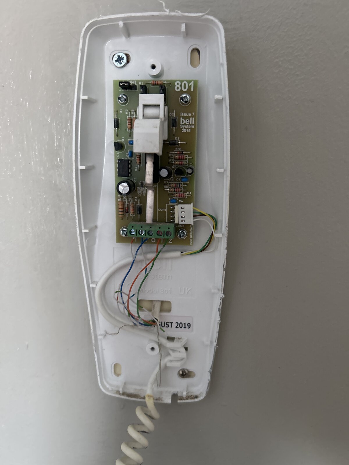

S Spu Joined 11 Mar 2024 Messages 2 Reaction score 0 Country 11 Mar 2024 #1 Please someone help me turn the buzzer off lol it’s driving me mad Attachments image.jpg 146.1 KB · Views: 60
J Jurassicspark Joined 6 Nov 2023 Messages 1,192 Reaction score 246 Location East Country 11 Mar 2024 #2 Unplug the connector (C6) Or find out where the white wire comes from and disconnect it from there.
securespark Joined 11 Jan 2004 Messages 43,322 Reaction score 2,758 Country 11 Mar 2024 #4 Why? Just unplug the connector. This will suffice as a temporary measure. Then you will need to enquire as to who maintains that equipment so you can get it repaired.

sparkymarka Joined 16 Feb 2011 Messages 10,533 Reaction score 1,742 Location Sheffield Country 11 Mar 2024 #5 The I wire …white with orange is the buzzer wire remove this to silence the buzzer …I also think the removal of the HI/LO jumper at the top also stops the buzzer
