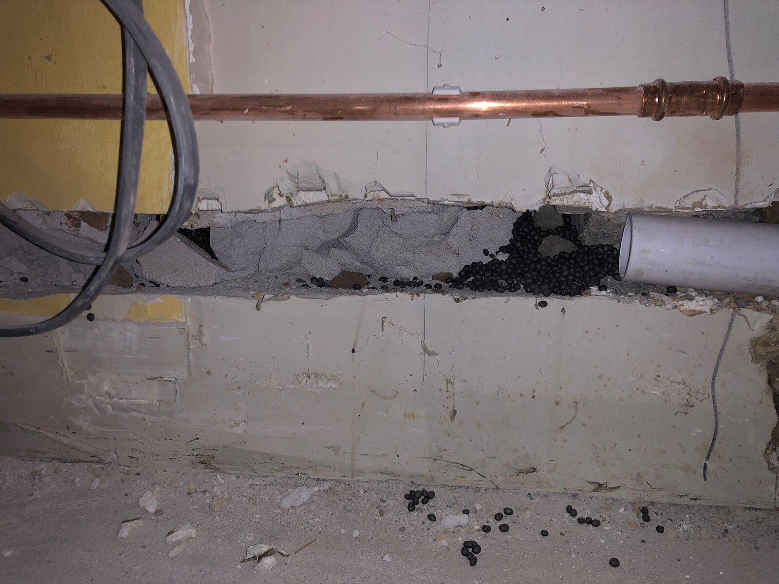

Hi all,
First time poster here. As a bot of back ground, im getting a new kitchen fitted.

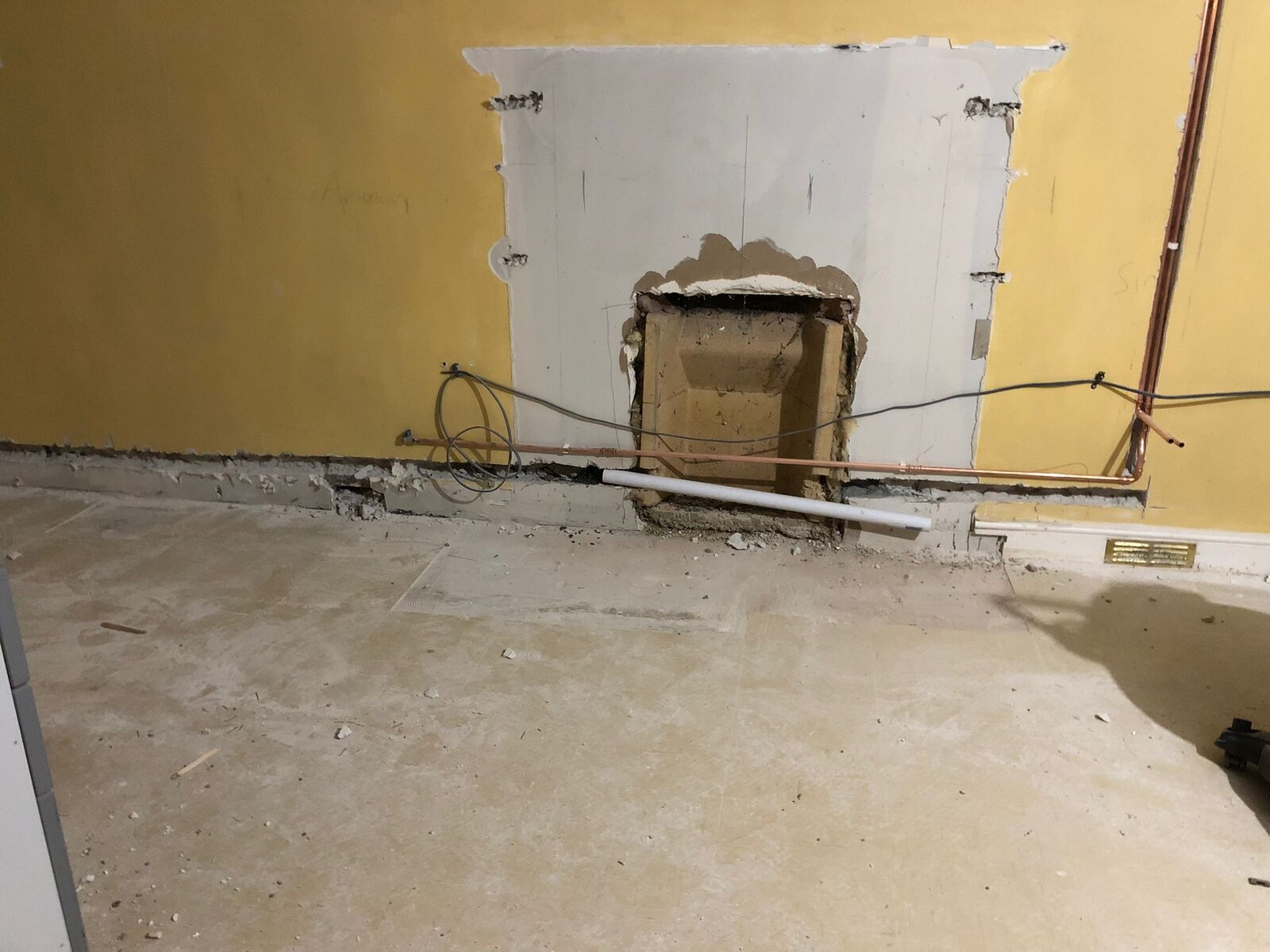

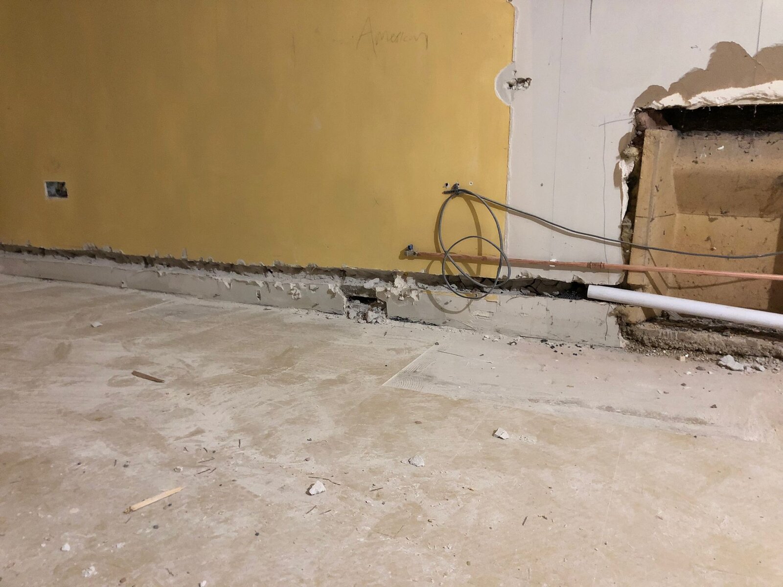

The plumber, sub-contracted out by the builder, came around to do some work today. When I got back, I witnessed the following. He has essentially chased the wall (External gable end wall) through to fit the waste water pipe for the sink. As you can see its rather deep - the full width of the internal freezer block in some places and spans for about 3meters.
I'm no structural engineer - but is this ok? It doesn't look it and im slightly worried. In not even sure why it needed chasing, as surly the waste will run at the back underside of the kitchen cabinets won't it?
Any advice please. Is this ok, and if not - what should I do?
Structurally, I’m not qualified to say, but I would have thought it would be ok. It’s not the best job, and can’t understand it myself, vast majority of kitchen units have approx 60mm space behind them to accommodate for such things. Have you asked the builder?
Is that a cavity wall or double brick thickness wall?
From what I can see in the photos, he may have severally weakened the structure of that wall, but if there is a run of units along that wall - why has he done that at all?
All modern kitchen units have space behind them to run pipes and cables without need to chop them into walls.

Its a cavity wall, breeze block internal, brink external. This is the gable end or the house.
Yeah the full wall is having cabinets. SO not sure why the waste is being chased... This is what started my alarm bells ringing.
Its a Howdens kitchen going in...
is that not dot and dab plasterboard wall?
depends how much of the actual wall they have taken out
Its because there is an American Fridge freezer going on that wall and I bet the builder asked him to chase the waste in to ensure it clears
the plumber wouldnt have done it for no reason
Are your builder and Plumber both British?
Only asking, as they may have different type of buildings in their home countries.
Andy
it does look a bit deep -the plaster is probably 12mm 15mm so the chase only needs to go in about 15mm leaving the pipe sticking out a tad
