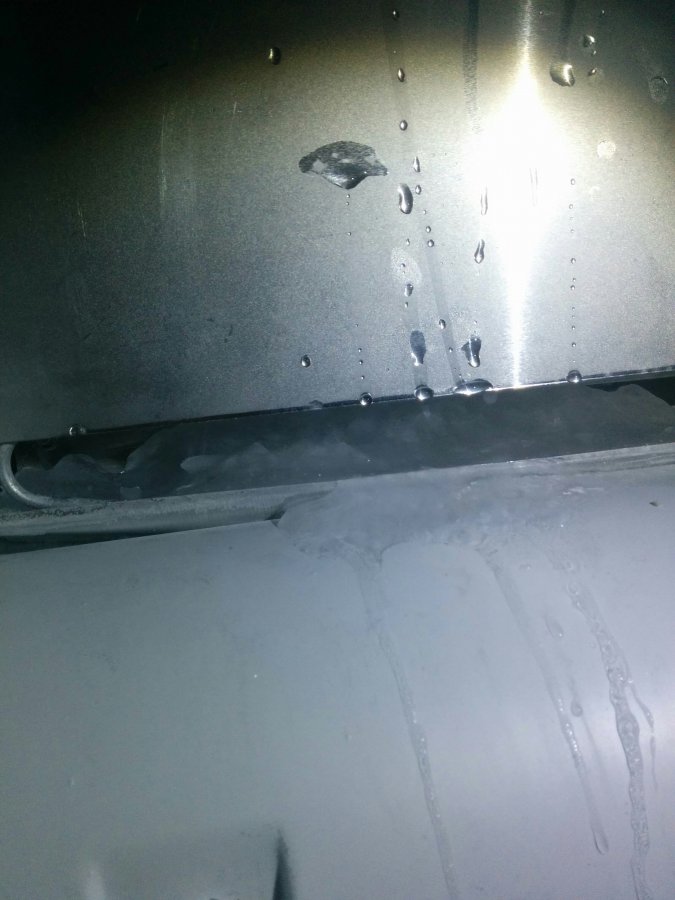

Recently (2-3 months) the bottom of the freezer has been collecting sheet ice.
I checked the reservoir at the back of the fridge where the water drains to and evaporates to see if anything was blocking the outlet but it looked fine and had water in it.
(suggesting the fridge drainage is working OK)
Taking the back off the freezer, it's clear the area that collected the water hasn't been draining and has built up a lot of ice.
I carefully removed the ice with a hairdryer on very low heat (and 45 mins).
Despite this, it still didn't want to drain.
I tried adding some warm water and agitating it for 5 mins in case there was some ice blocking the drainage hole that the hot air couldn't reach. No luck.
Back panel removal (just before disconnecting fan power cord to completely remove the panel)
Small mountain of ice
Ice removed
Cheers!

Indesit freezer builds up ice at the bottom of the freezer.
The water collection unit at the back of the fridge (on top of the compressor) was clear of obstruction - so it was likely the draining tray/hole/tube had iced up of there was a blockage.
(a blockage is unlikely as in this design, I can't see how anything would get to the draining tray)
Cause:
Freeze meltwater drain is blocked, causing no water to drain - which freezers and blocks the entire draining tray (see pictures in previous post).

Thaw Draining Tray
Use the hair dryer on a low setting to carefully thaw the ice in multiple passes over the ice - don't let it get too hot and don't hold it on any area for a long (3-5 seconds) time!
It helps to remove melted water also as this otherwise absorbs heat from the hairdryer - use a paper towel or very clean cloth.
Keep going until all ice is gone - do not use an implement to try and prise the ice away - you may break something.
If the water doesn't start to drain, try some warm water too - it could be ice blocking the draining hold beyond sight.
Hopefully that should do the job.

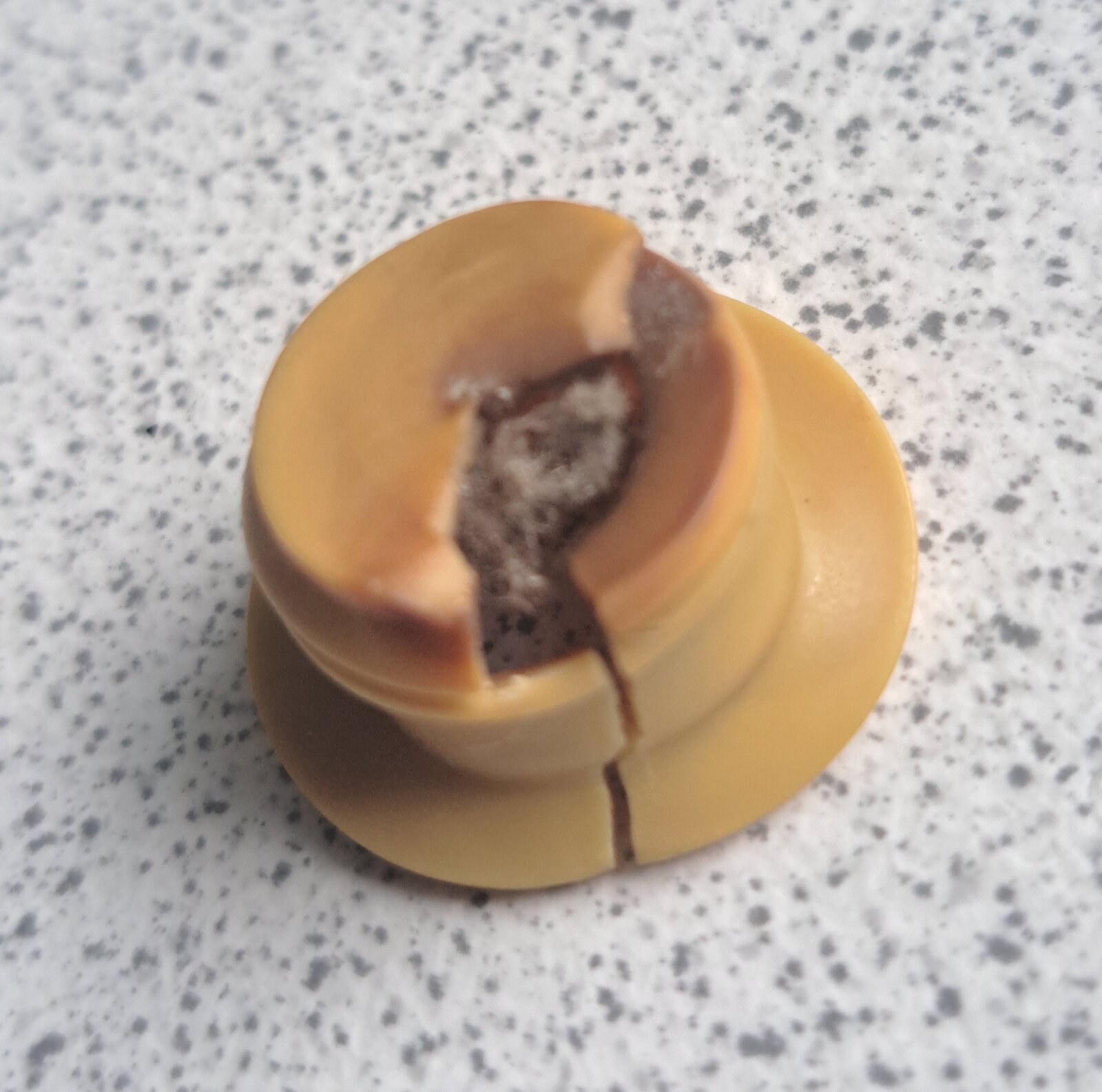

So, going back to the drainage collection tray at the back of the fridge - there was water, but this was from the fridge draining point - pouring water into the fridge draining hole came right through.
It turns out this model has a separate draining line and exit point for the fridge and freezer.
When you're looking at the rear of the fridge - the draining tube exit right in front of you is for the fridge.
There is also another one about 4 inches behind it (grey, hard to see).
The freezer draining tube has a rubber/silicone valve - basically a small piece of rubber with a 'X' shape - this allows water to drip out and (I'd assume) nothing to get in - especially warm air.
Upon giving it a prod with a pencil - water gushed out, but stopped when the pressure of the pencil was removed.
There was no 'gunk' or any build-up - it looks as if the seal on our fridge was very inflexible and wouldn't allow any water through and/or the 'X' wasn't fully cut through.
Carefully using a stanley knife, re-score the 'X' shape into the seal, allowing each of the four 'flaps' to be able to move and allow drops of water through.
Done.

A big thanks for posting this, as the average person would not have a clue about how to fix this problem. I have now solved the exact same issue on the exact same model. The plug however was not a silicon plug but a hard plastic cap with a small pinhole that was destined to become blocked (see photo) I also had no idea that there was a separate secondary pipe behind the main fridge drain line.
After the full defrost I ended up replacing the broken and blocked plug by cable tying on a piece of latex cut from the finger of a disposable glove, with a small hole just big enough for water to escape.
Again, many thanks. I now have a perfectly functional fridge freezer and saved the cost of buying a new one.
