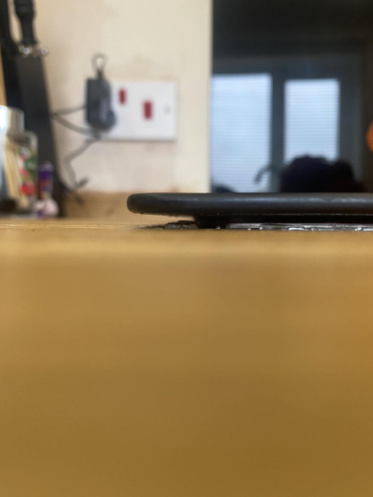

Hoping someone can help.
I recently had a B&Q kitchen installed (by their fitters) and there is a fairly sizeable gap between the hob and wooden worktop (image attached).
The fitters have said they can’t get the hob any tighter but to me the gap seems too big. Could anyone please advise if a gap this size is normal and if not, why this might be the case?
No, not normal. Hole too tight or something below holding it up, shouldn't be difficult to find the problem.
Don't know if that is sealant in the picture under the hob, but in my instructions it says not to apply sealant.
And no, it should sit further down, there should be no gap.
That is shocking workmanship, the hob glass underside should be sitting on the worktop with a foam seal.
