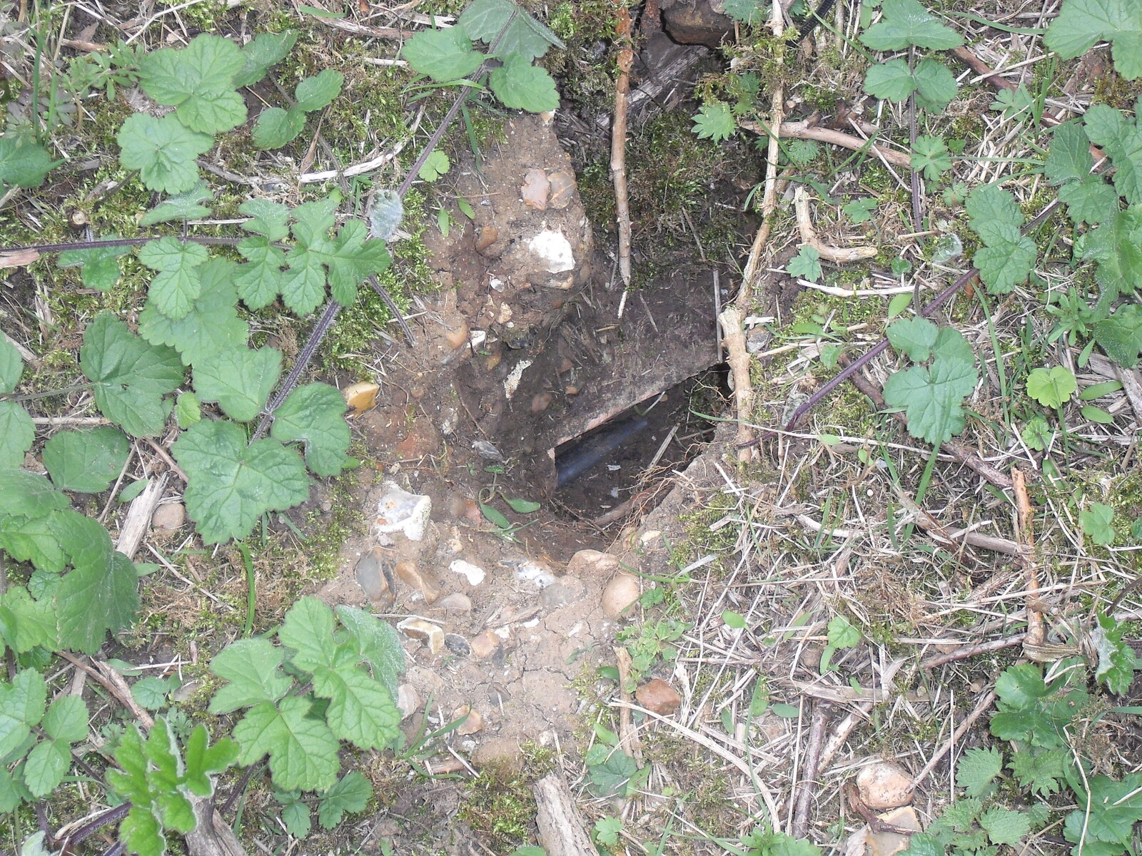

So talking of quick pictures...
Finding something like this which was declared as buried 900mm down does tend to make many professionals wary/sceptical.
To add perspective to the picture it's a brown [sewer style] pipe less than 150mm down, provided for 2 armoured cables. For some unknown reason theres a hole in it and this is where the rats had originally created a way in or out. A slab had been placed over it [shown by lack of vegetation] to stop them and all they did was keep digging.

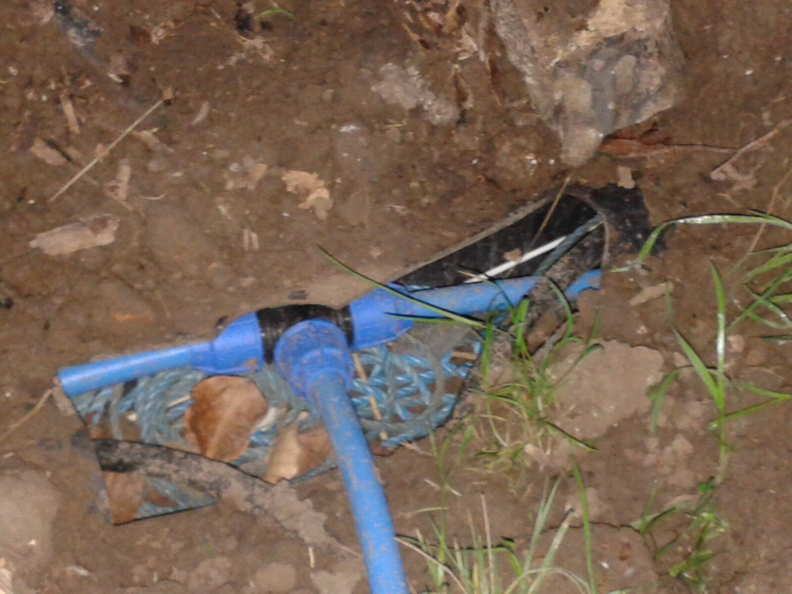

Or this one, not very clear but there's a split con and a white alarm cable running right through, a couple of SWA's heading from the bottom of the picture into the duct in each direction and of course the elephant in the room a water pipe too. Again this is buried only a few inches down and I found it covered with a big and very rotten blue 'tarpaulin' shoved over the gap and topped of with a pallet:
This duct is known to be buried much deeper, in fact a trench for a sewer was dug across its path, not more than 20m away, to a depth of some 1.8 to 2m deep without finding it and the access pit another 20m further on finds the ducts at over 1m down.
And you wonder why electricians are wary of others installing for them without consultation?
