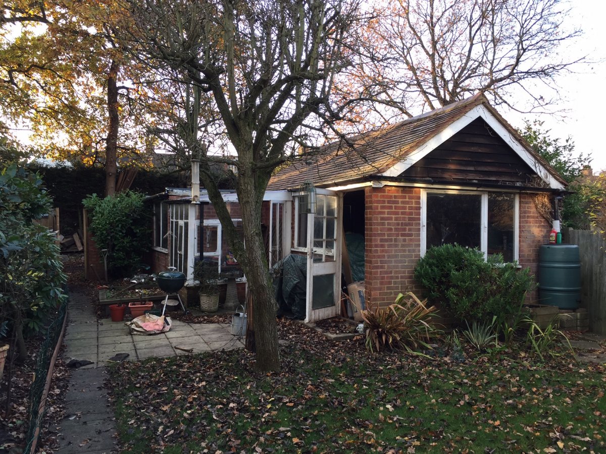

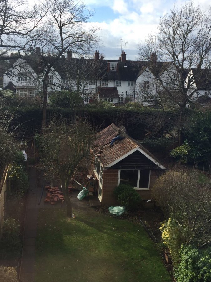

Here are some pics to get to grips with the layout etc:

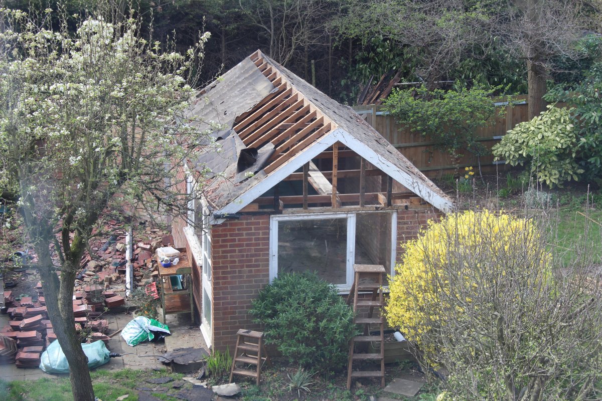

Garage as seen looking down from house
Garage and greenhouse closer up. Garden gate to alleyway visible

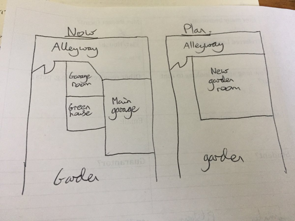

Current layout and new garden room plan. See how it makes use of empty space on the alleyway side of the garage and gives back some of my garden.
The next few months will be taken up with knocking down the garage and greenhouse. Then I will embark on building the garden room. Its initial use will be a woodworking shop, but I want to keep it's options open to be used as a gym, an office or perhaps even a small flat at some point (aware of building regs/planning etc for that).

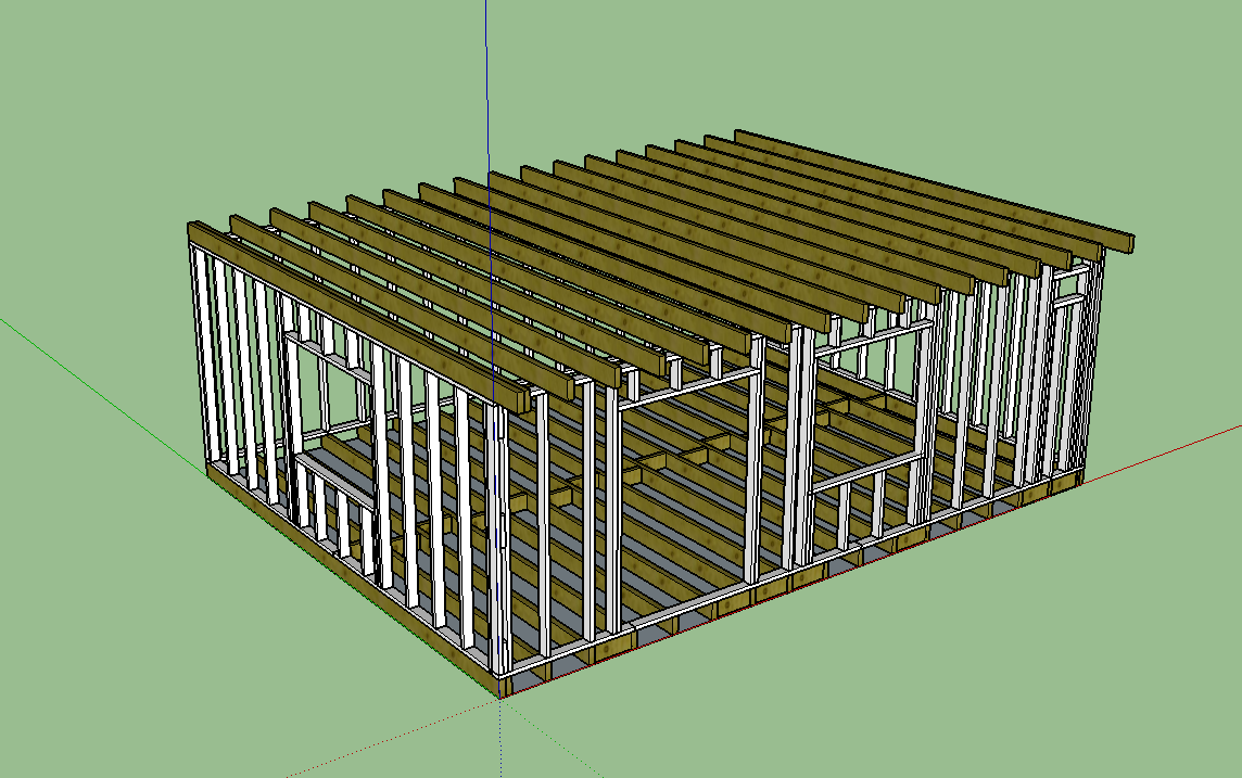

Here is my sketchup design-as you can see it's not a big windowy-bifolding door affair. Just some french doors and a couple of windows. The little window on the right will just be framed in in case I put a small toilet/showeroom there at some point in the future when I can put a window in easily.
The dimensions will be roughly 6.5m x 5m which will create an internal floorspace of 30m2 and therefore below that required for planning. The height will be 2.5m at it's max with a flat roof (no planning required).

Question 4: I had planned (as in the sketchup drawing) to use 2x4s for the walls thinking these would be 100mm+. I recently discovered that a 2x4 is not 2x4 but instead about 38mm x 89mm! How confusing. My 100mm celotex plan has gone out the window. Will 75mm be warm enough or should I be using 2x6s (which are also not 2x6 o_O)? Incidentally, if I go to 2x6 can I then change to 24 inches on centre rather than 16?
Question 5: the roof rafters will span a width of nearly 5m. according to this chart http://www.home-extension.co.uk/tech2.html , I'll need the rafters to be 75mm x 220mm. I plan to have a beehive/s on top so may require being walked on! Does that sound right?
Question 6: I plan on using an EPDB rubber roof as this is best for a flat roof. Do I need a drop between the front and the back of the building or can it be truly flat? If I do need a drop, how much over 5metres?

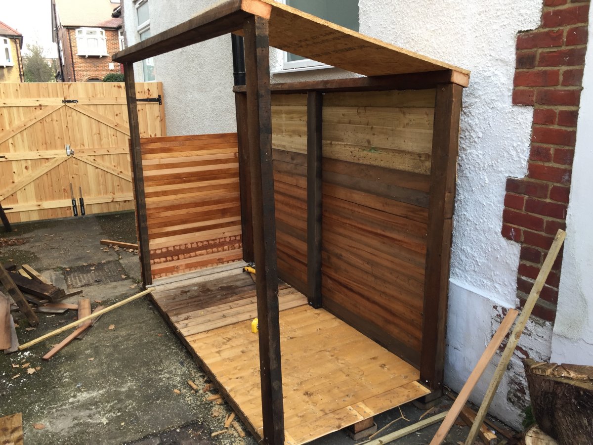

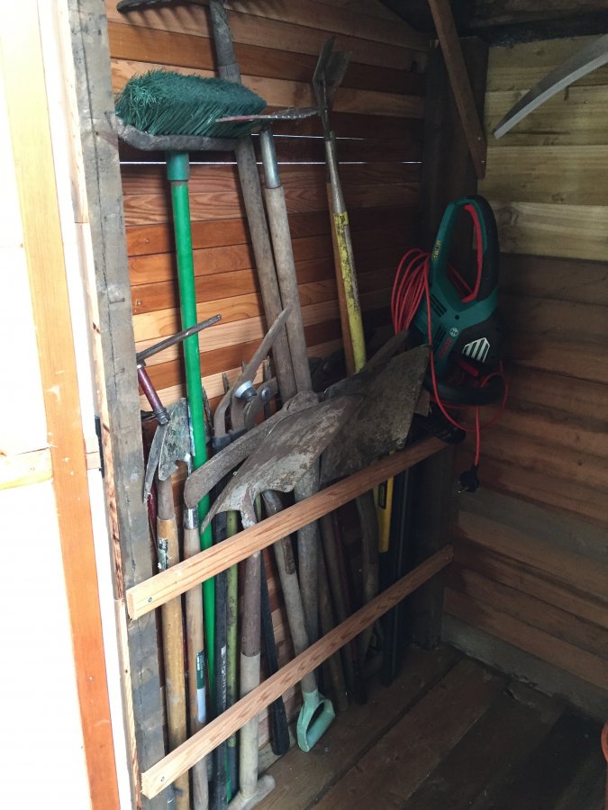

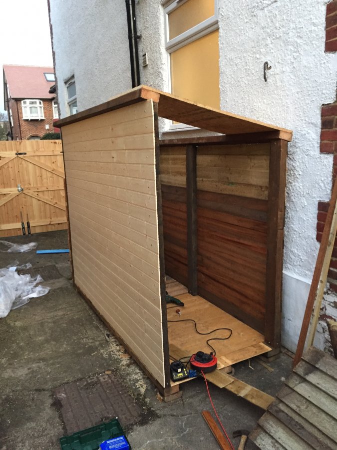

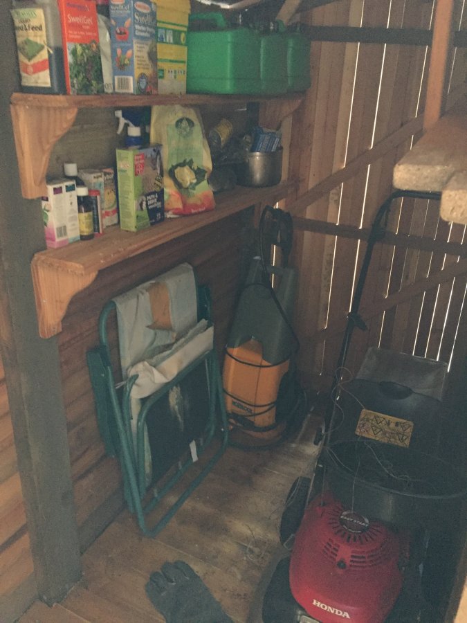

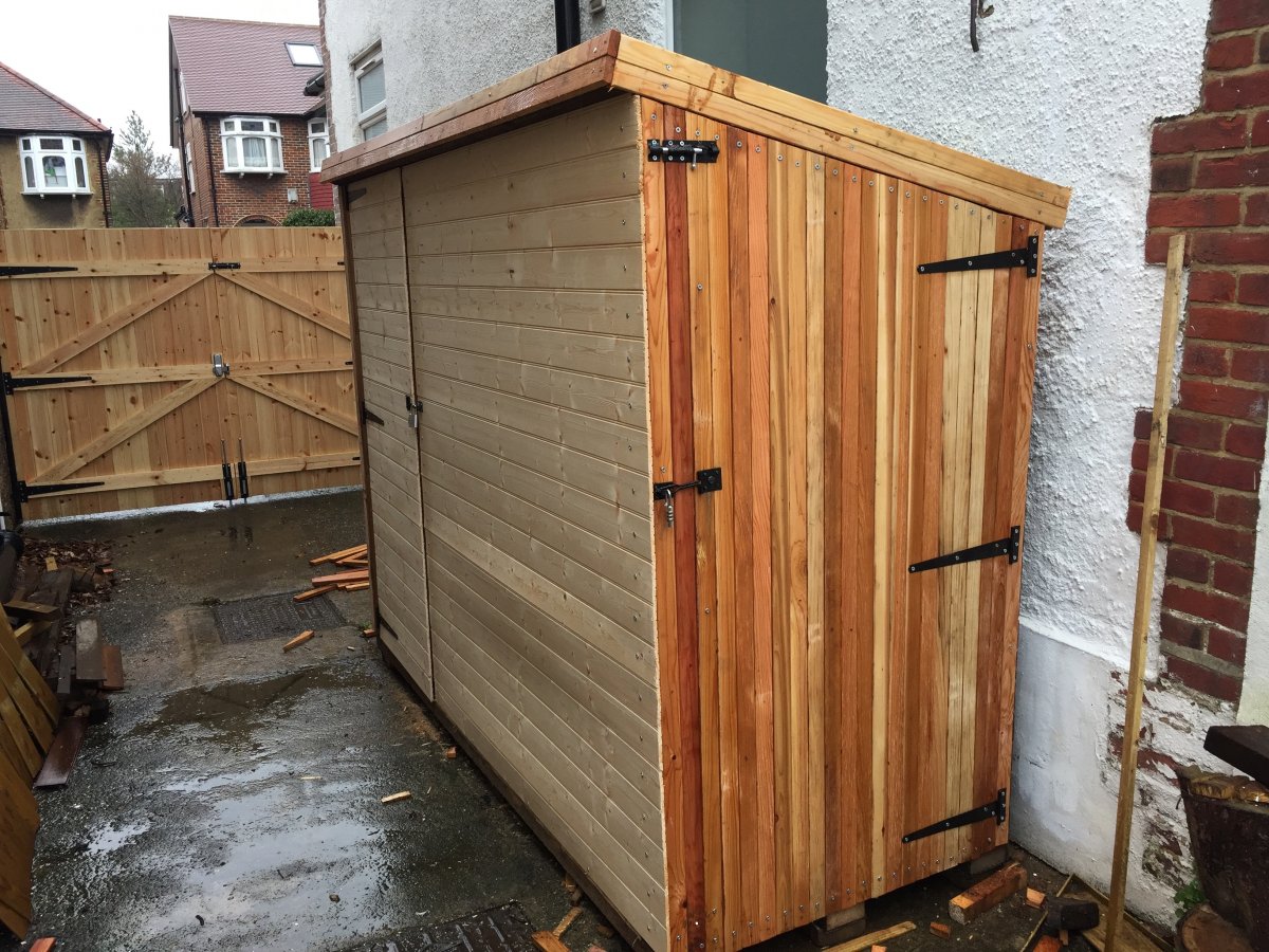

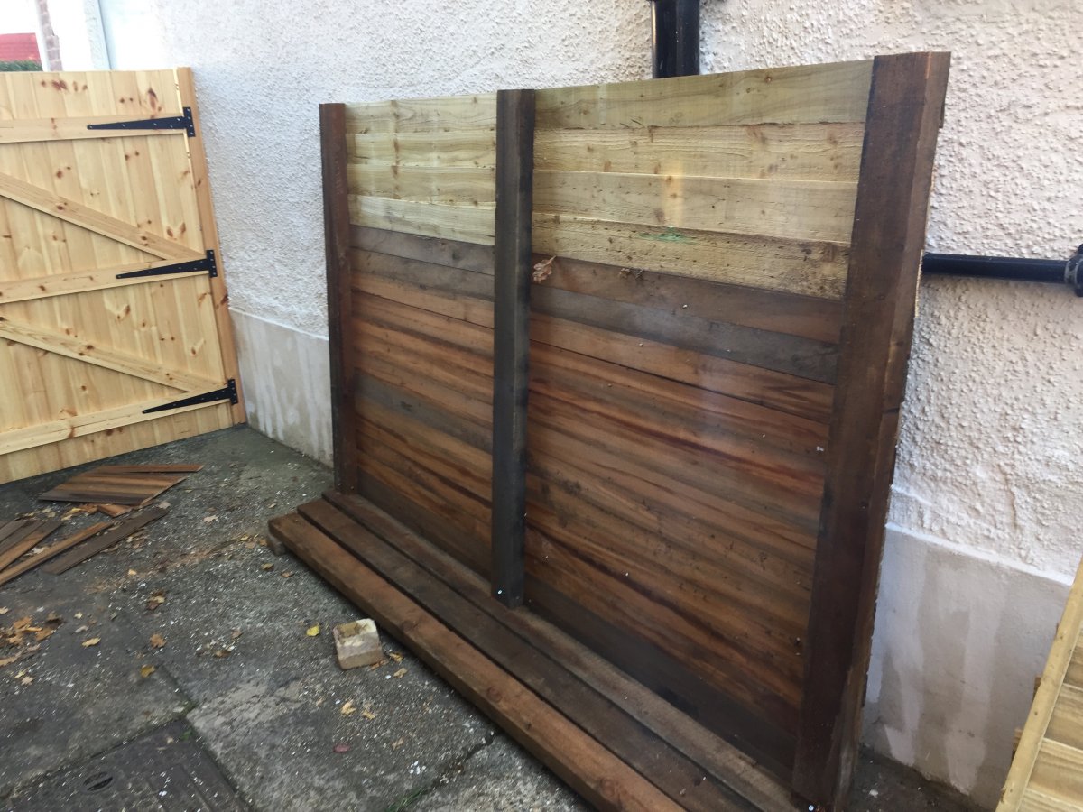

In the meantime, a mini-project- I needed a new shed for garden equipment as I'm knocking down the existing garage so I got this done over the last month. It's made predominantly from scrap wood and sits to the side of the house. It rests on 6 flat bricks with pieces of pond liner on between to act as a DPM. The red cedar came from a neighbour. The pine cladding was £35 delivered from B and Q, pretty flimsy but did the job and it made the other door nice and light. Overall I think I spent about £70. The structure is from old roof rafters so it's a lot stronger than most commercial ones. Has two entrances, the end one for ease of getting the mower in and out. OSB roof with roofing felt. Should have brought the roof protruding over the sides but will fashion some trim to overhang.
IMG_6085.jpg IMG_6089.jpg IMG_6097.jpg IMG_6109.jpg IMG_6129.jpg IMG_6170.jpg IMG_6182.jpg IMG_6183.jpg

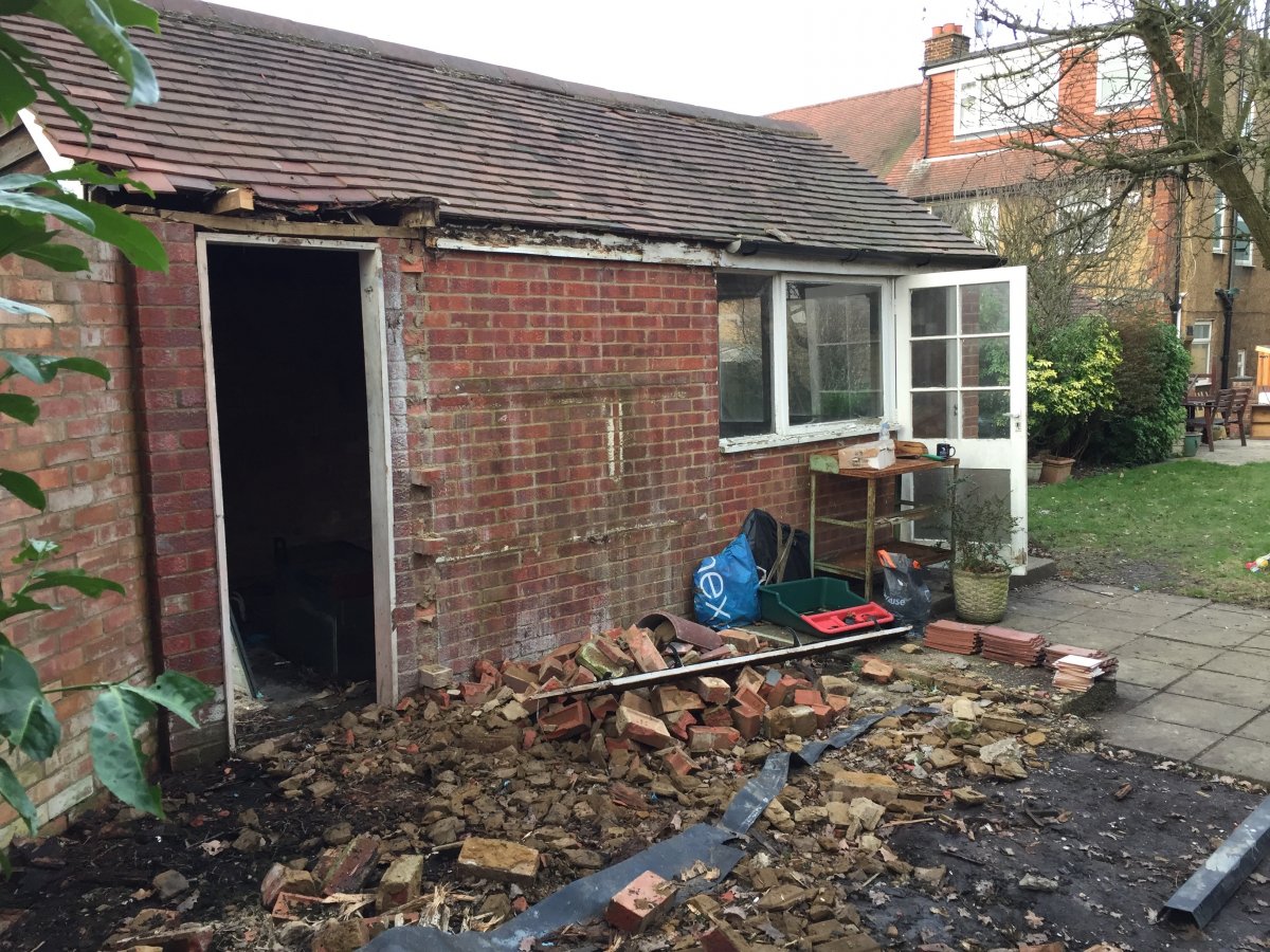

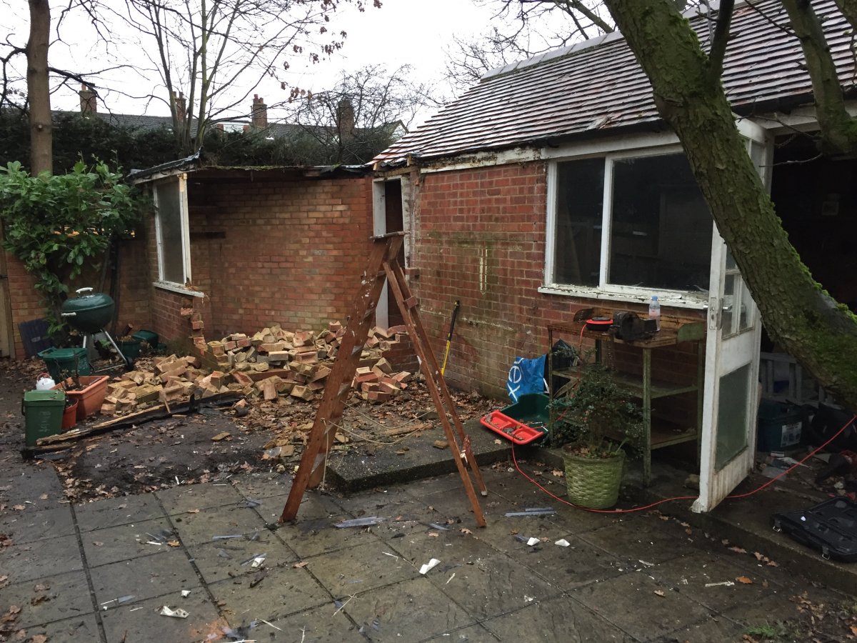

The existing greenhouse and back room have been knocked down with a trusty sledgehammer and the garage emptied of 30 years of accumulated crap, albeit some very interesting crap, including plenty of rusty old tools that I intend to make good use of when this room is done. For the remaining garage, I'll remove the tiles, then the trusses and windows then knock down the walls.

Question 4: I had planned (as in the sketchup drawing) to use 2x4s for the walls thinking these would be 100mm+. I recently discovered that a 2x4 is not 2x4 but instead about 38mm x 89mm! How confusing. My 100mm celotex plan has gone out the window. Will 75mm be warm enough or should I be using 2x6s (which are also not 2x6 o_O)? Incidentally, if I go to 2x6 can I then change to 24 inches on centre rather than 16? As you're cladding it in OSB3 you can probably get away with 4x2's at 24" (610mm) centres. 38 x 89 sounds small, 4x2 CLS should be about 44x94. 75mm celotex should be plenty, you could consider rock wool or similar full fill the studs, probably cheaper. Im planning a similar shed with 4x2 at 610 centres clad in 11mm OSB (then breather, battens and cladding) full fill rock wool, vapour barrier and then 9mm OSB.
Question 5: the roof rafters will span a width of nearly 5m. according to this chart http://www.home-extension.co.uk/tech2.html , I'll need the rafters to be 75mm x 220mm. I plan to have a beehive/s on top so may require being walked on! Does that sound right? Quite a big span, could bulk it up a bit for peace of mind, 400mm centres (16in). Looking at your sketchup id also add a few rows of noggins and bind the rafters at each end with say 220 x 50mm, it wouldn't need to be 75mm thick anyway. also gives you a nice solid facia or backing for a facia. Id also insulate the floor and roof personally, might be worth thinking about.

Tools used so far: sledge hammer, reciprocating saw, hammer and crow bar.
the wood battens that the tiles hooked on to will hopefully be re-used between my breather membrane and my cladding.
The trusses have provided plenty of wood for wood working projects when the workshop is complete.

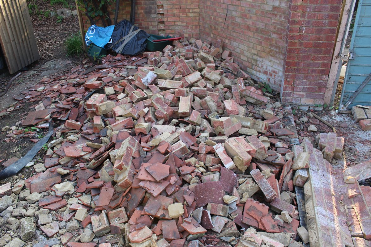

The walls came down pretty easily, some which just a good push which shows it wasn't in good condition.
Note to anyone undertaking this: remember that guy who got crushed when demolishing a garage? Always take the roof off first rather than trying to take a shortcut of pushing the lot over in one.
I've saved a lot of tiles and bricks which I hope to sell or give away saving skip money. The broken tiles and bricks and mortar might hopefully make a good lower hardcore. I'll put proper MOT over that but it should do for the lower level, unless someone advises me against.

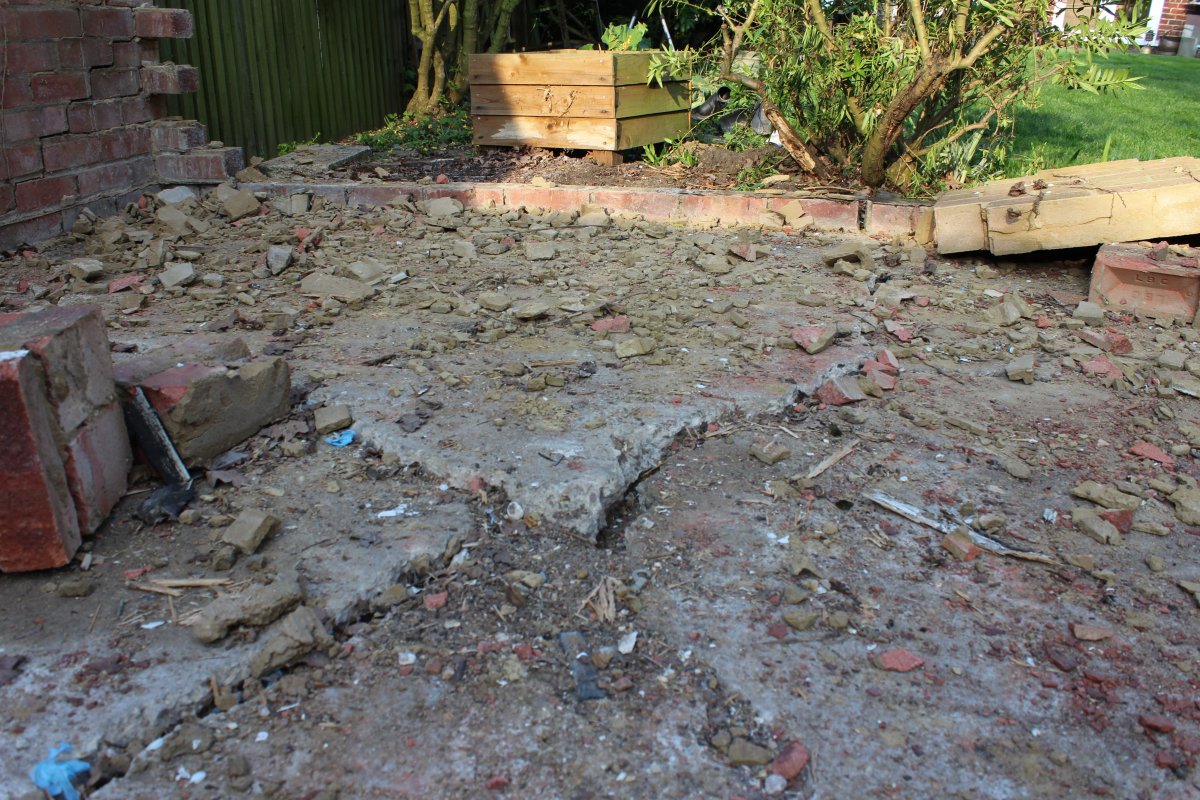

whats under the garage? I'm guessing that had a concrete slab of some form?

Here's a couple examples of what went wrong with the last slab:
This shows the foundations on my mum's side (she lives next door) with a big crack
The main floor of the garage
As you can see from that last photo, the floor is indeed concrete and could, and if I had a crusher be turned into MOT 1 sub base. It looks to me however that hiring a crusher would be more than just buying new hardcore and putting the broken up concrete in a skip. I'd welcome any thoughts on this?

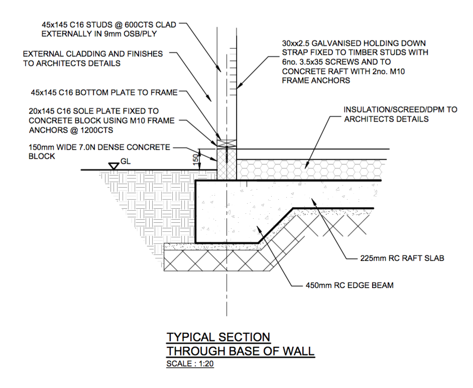

As far as the construction of the new foundation goes, I have been given some drawings by a chap who is doing a similar (yet more extravagant and professional) project.
So the base from bottom to top looks like this:
150mm MOT1-compacted
50mm sand blinding
DPM
225mm raft, 450mm edge concrete reinforced with rebar.
100mm celotex or similar insulation
DPM?
60-75mm screed.
Walls- Agreed about the mineral wool and thanks for confirming I need a vapour barrier. I think I'll need to be at 400mm centres for the timbers as the roof is spanning a very large gap and need to be on 400 centres which are best if the weight is transmitted through a timber to the foundations. I could do a double top plate which would help spread the load and go on 600mm centres but I'm wary of this. If I go for a green roof down the line I'll need the extra strength. I'll have a look for those bigger 2x4s but I'm thinking 47mm x 120mm would be best. I want it to last and be very solid. I'll post more when I come to this stage.
Roof- I'll need 2 x blocking between each rafter at one-third span positions. Joists will be 47mm x 220/225mm. Thanks for reminding me about a facia board I'd forgotten about that. I'll do a new sketchup when I've got the base ready. I'm going for a warm roof construction-OSB over the joists, vapour barrier, insulation, OSB again, then EPDM.

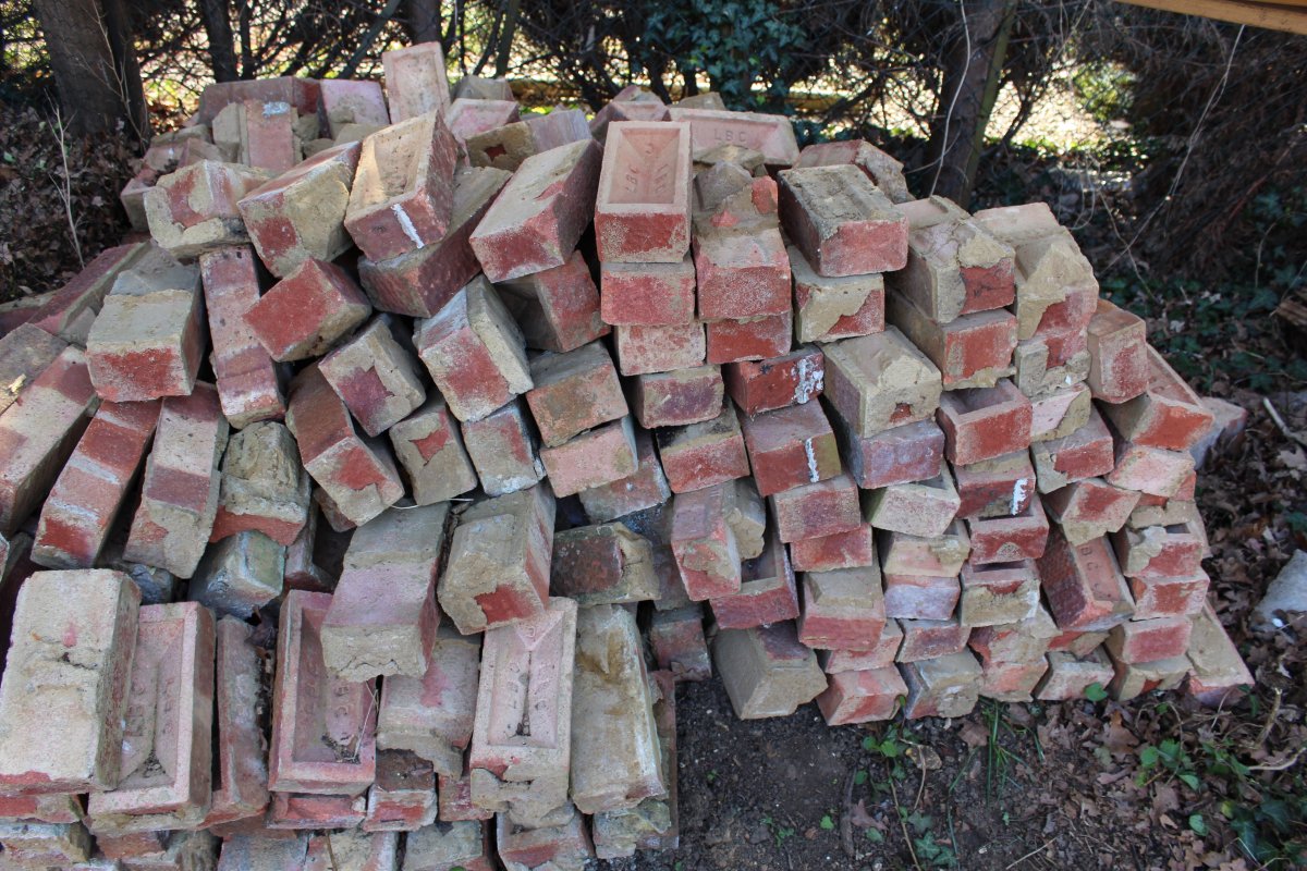

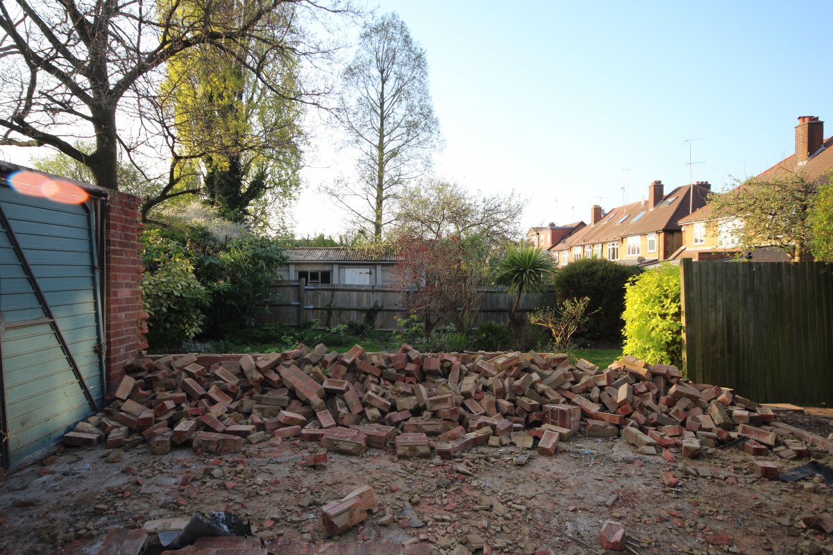

As for the bricks, I've saved the ones that haven't broken, although they have a lot of mortar attached but I'm quicky amassing a pile of broken brick, mortar and tiles that I can only assume no one would want and is not useful for sub-base?
Good bricks:
Bad bricks:
Bit more progress to report-3rd wall is now down, a lot of clear up this weekend I think:
Sounds like you've got most of it covered, good work! Yes buying hardcore and removing the old stuffs cheaper and easier than reusing it. Yes you need that other dpm, if you build that detail then you would lay the block band course on the slab, line it with a dpm before insulating and screeding. Think that detail is using a thicker insulation or screed as a block with a bed should be 225mm high assuming it's a 215x440x150 block which I'm not sure exists it would be a 140 block. I'd also insulate the side of the screed against the block and use a thicker sole plate 20mm isn't very useful imo, don't get much of a fixing and it's usually naff timber. Definitely on the right track.

The dense blocks on the concrete will be 100mm wide x as you say 225 (with mortar) so either I get thicker insulation and screed to come level or leave it a few cm short, I can't see why the latter would be a problem. I saw from another person's build that I can get the concrete down, blocks, walls and roof joists on before coming back to finish the floor with insulation and screed, that way I can buy my insulation for both the warm roof and floor later when I need it, rather than buying in two lots (or have some sitting around for the roof).

Only had time to skim that quickly but regarding the block and screed detail, you could leave it short but your going to need to line the floor with a dpm under the screed, up the side of the block and out under the dpc (dpc to sit between stud wall and top of block).. if you leave the screed short of the block height then this don may be on show and liable to get damaged, guess you could cover it with something like skirting or internal wall finish just DONT puncture it. Re doing the concrete floor etc after, yes you can and the added bonus is the roof will help keep it pristine but I'd consider what you're using and how your getting it in there, with no walls or ceiling a readymix truck could pull up and pour straight in for example, with doors and walls it's more likely a mixer and barrow job
