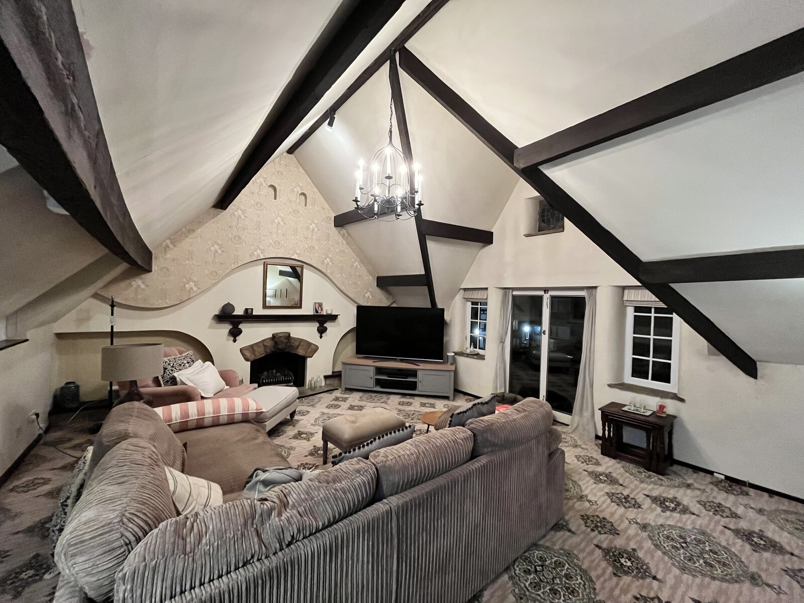

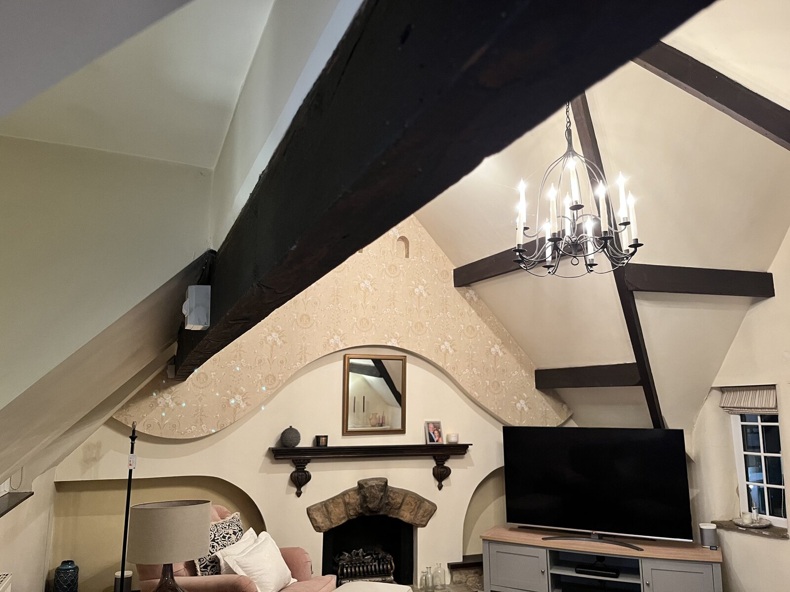

I’m renovating an Old coach house to live in the for next 4-6 years before letting it out.

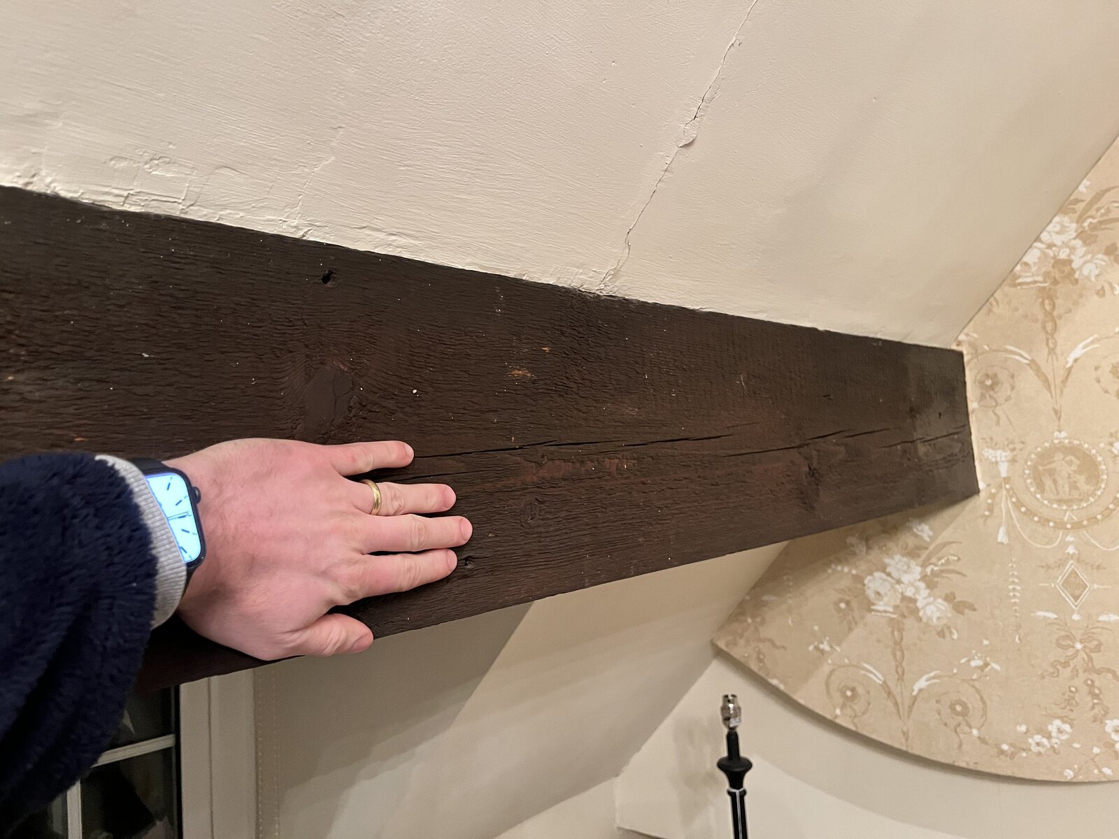

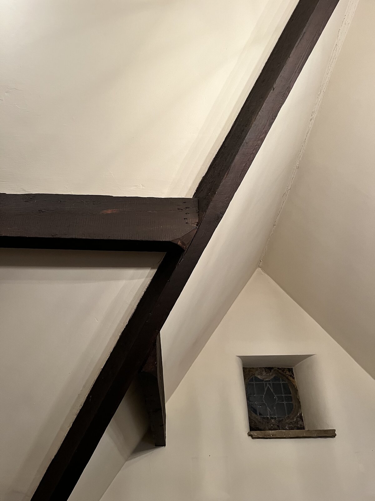

The house is upside down and the livingroom upstairs is absolutely freezing. The roof is made up of (from what I can tell) slate, membrane, a very thin (3-4 inches) layer of some kind of rockwool then plaster boarded.
I was told to potentially just screw in insulated plasterboard (as thick as I can get) on top of the plasterboard as a fix rather than redoing the entire roof (which I can’t afford / don’t want to spend the money on). The roof has so many difficult angles and the beams are bowed slightly in places so cutting boards for this as a novice is extremely daunting.
My questions are:
1. What is my best option here so insulate this ice box?
2. If I want to rent this house out in the future, do I have to adhere to the 270mm thick insulation regulation? If so, it will completely cover these beams and make the room feel much smaller.
Many thanks for any help and advice in advance.

Even so - looking at the photos of the upper floor, it is nearly all roof and no walls.
It is well worth trying to get insulation in, below the plasterboard - it will also help make a big difference when summer comes and the room turns into an oven.
If you can afford to insulate the walls, all the better, but having lived in a top floor flat with ceilings like yours - spending money on the ceilings, should be worth it.

If you are willing to cover up the old plaster so it can't be seen, pull it all off and insulate like any loft conversion.
Rigid foam slabs between the rafters are usual. If yours are wavy you will have a lot of tiresome cutting and trimming. Mineral wool is easier to press into an irregular shape, but would yave to be twice as thick ti achieve the same indilsion.
If you can live without the exposed beams you can fix more insulation and plasterboard over (under) them.

Thanks John. I think this might be the only way forward if I am to get a thick enough insulation to be effective and not hide the beams - I will need all the space/depth I can get. I was hoping to avoid this as naturally ripping it all back can cause or expose more issues / cost more money..
