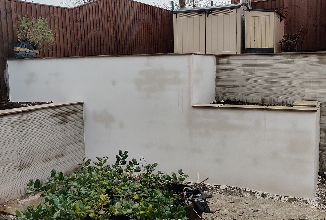

Hi all,
I've had walls built in my garden and they've mostly now been rendered with K-rend.
I've noticed that I can see water coming through the render - especially seems to be tracing the pattern of the mortar (see photos)
Is this just part of the normal drying out process or is there any issue? I'm just worried that (a) it looks a bit unsightly (b) more importantly, if there's a frost will it blow the render?
The dark pattern seems to change every day which worries me that it's not drying out.
Any advice would be very much appreciated.

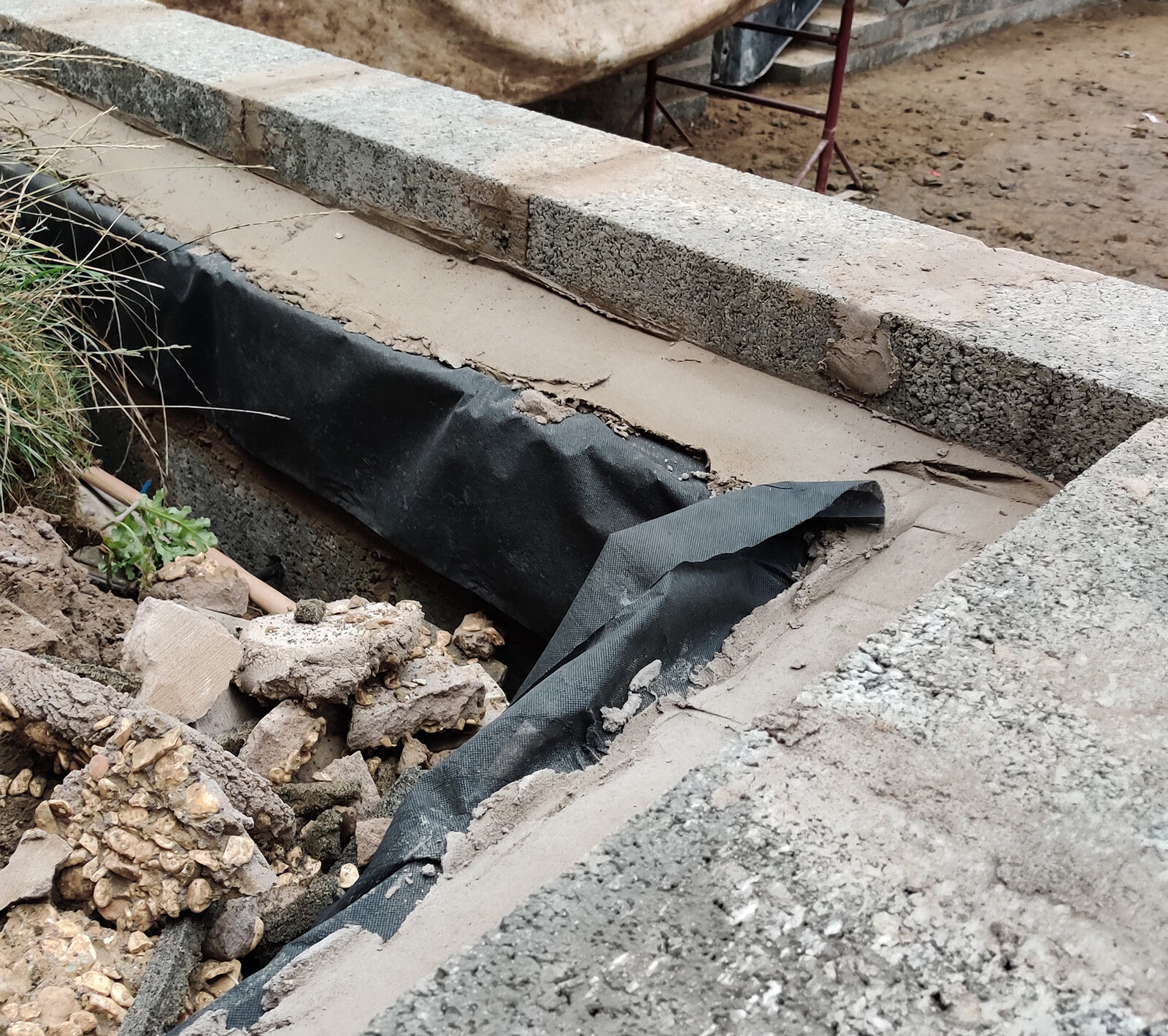

Thanks for getting back to me. The builder did make it an inner skin and I also saw some black membrane-stuff?? Is this what you mean?
Possibly, though I can't tell if it has been fitted to entirely cover the wet face of the wall.
The black stuff might be geotextile, which is porous.
The blue stuff looks like a bag or tarp.
Drainage of the soil is also needed, usually through pipes near the base. The wall will still be damp at the bottom through damp rising g up the foundations, but not so wet.

The walls were built just before Christmas. There are pipes near the base on the back wall but not on the 'planters'.
The builder put a 'cap' between the inner and outer skin of the walls to stop crap falling down the gap.
Do I need to smash that off and see if there's crap down there then? i.e. Do you think the inner/outer skins are connected by stuff which is causing the seepage?
Or could there be another reason? Like water coming in from the top of the blocks and soaking through and just popping out at different parts ??
Or maybe moisture trapped in the wall slowly coming out??

So, I take it that it couldn't just be the walls "drying out". I'd rather not drill holes if I could avoid it. I could take the "cap" off (the cement that covers the inner/outer walls) and have a look down the gap. But, if there's any chance that this will just be moisture that was just trapped in the bricks and it'll settle down then I don't want to do that obviously. The damp seems to be higher up than the bottom (doesn't seem be a lot coming through at the bottom) which is confusing me?

Thanks JohnD. I've since found out that it's called "Ghosting". I think I need to either get a thicker coat of render on it. Or maybe paint it with a thick breathable masonry paint but I'm going to ask the renderer about it.

the black ‘membrane’ looks like weed control membrane. it wont stop moisture entering the wall and will perish . A damp proof membrane would have been better.
Ahhh... that could be an issue then. I'm pretty sure it is the weed membrane stuff. It's got that 'hessian' type feel to it. Thanks for the help :-)

the main damp area is high up suggesting it’s rain water running off the top.
There’s no drain holes at the bottom?
I’d give it a few days to see if it dries out.
Either way you can’t paint it until it’s bone dry, with the risk of it spoiling if there is moisture entering from behind.

Thanks for that... yep, all the slabs need re-doing because the guy didn't prime them so most of them have not bonded. I noticed there wasn't a drip groove in them either. I've also read that a bead of clear silicon along the bottom can help.
My plan was to put clear silicon in the gaps to stop the grout lines dripping.
The ghosting has been there for a number of days now - although it's forecast for good weather this weekend so hoping it can bake some of the moisture out of them and then I can see (on the next rain) if it returns.
In the meantime, for my own peace of mind, I'm going to remove a bit of the 'capping' this afternoon and have a look down the gap between the partition (on one part of the wall) to just see if there is anything untoward going on.
