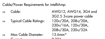

The PDF on it is here: http://www.jacarta.com/wp-content/uploads/2016/07/Jacarta-intelliAmp-2016.pdf
Apparently, it can measure power and current by simply clipping it over an active and already existing 3 core 16A/32A cables! (As in the ones that look like caravan electrical connectors.)

I am puzzled why it states this:
and then this:
A cable with parallel cores could be seen as an extremely elongated, single-turn solenoid. So from a position above or below the plane in which the cores lie you would detect a magnetic field.
But the cores do not lie in a plane.
