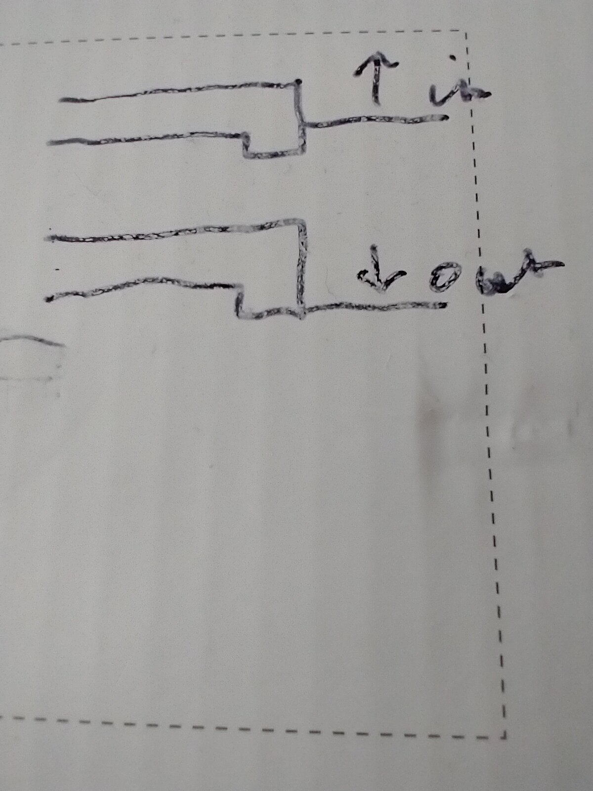

Hello All.
Currently building an extension, and am sat at DPC level. The house I am joining to has walls that are not plumb - only slightly out, but makes a difference of a couple of cm or so once you get up to around 3m.
How do you tie the extension into this? Other than just making the extension walls lean the same amount, I cannot think of any other way of doing it that will look acceptable once finished?
Should have checked before I started, but hey ho.
Luckily only a single storey extension....
I would always build the new straight and plumb.
It'll need tying in as best as you can and you might need to get innovative.
It will make the old look quirky, but I don't anything wrong with that.
Thanks. One end leans out and one end leans in.
The lean out end I think is easier as you can somewhat make up the difference with the final rendering. The lean in end is making me scratch my head.
I think you are right, build it plumb and then tie in as best you can once you get close to the existing wall. Will add to the character I suppose!

you need to set out the extension corners plumb.
where you need to be careful is the set out of the brickwork -for 20mm you could simply stretch or shrink the perps so you dont end up with a massive mortar joint at the abutment.
if you want all the perps plumb in the new brickwork you will need to do an altered set out not finishing on a full / half brick resulting in a lot of brick cuts where the wall meets the house.
Noseall knows about brickwork so he might be able to advise better.
Build a little projection into the last 4" of new wall to hide the join, it's what they do when they re-skin the old terraces near me, they always have a row of bricks sticking out by a few cm to disguise the join between the new plumb wall and the old leaning wall next door.
