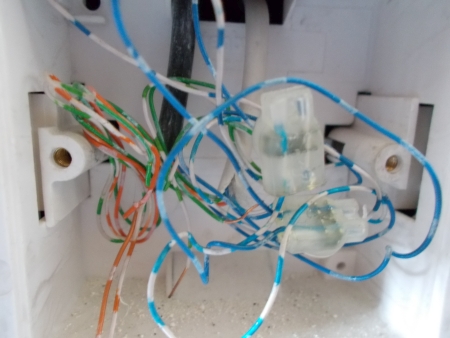

The first picture is inside the wall housing of the slave socket. I think the black cable is incoming, the white cable goes to the master in the bedroom.

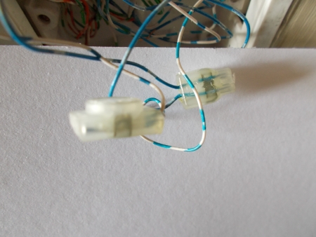

The second picture is a close up of the wire joins between the black and white cables.

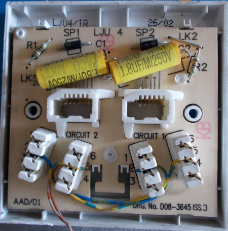

The third picture is the slave socket itself.

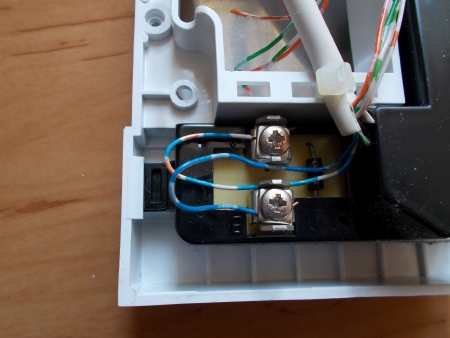

The fourth picture is the master socket in the bedroom, showing the white cable (from Pic1) going to wiring connections A and B. As shown, no other wires connected.

Very strange
Third picture is as marked an LJU 4 which is two master sockets both connected to the same line by the ble/yellow pair. It is not a NTE5. Master sockets have the 1.8uF capacitor, slave sockets do not.
I take it there is no socket on the box shown in picture 1
What should be there is an NTE5 on the black incoming cable. The NTE 5 has a master socket. Best option is to ask BT to fit the NTE5 for you as part of the new service to the flat.

A line test will have found the master sockets and hence it is assumed the line is intact and fit for use. In theory it is as you can use it but with micro filters necessary on each telephone to stop the ADSL signals affecting the phones.
Contact BT ( or who ever is providing your broadband / telephone service ) and tell them you do not have an NTE 5.
When the NTE 5 has beenn fitted then you replace the front plate with a filter plate ADSL-NTEFACE-SOL which can be bought from
http://www.solwise.co.uk/adsl_splitters-faceplates.htm ( there are other suppliers )
The router plugs into the ADSL socket, a phone can be plugged into the Phone socket, this is filtered to prevent ADSL afffecting the phone
At the back of the NTEFACE the blue/white pair ( the speech pair ) to the other socket need to be connected to the filtered terminals 2 and 5 Orange/wt to terminal 3 and White/or to 4. Terminal 3 is the bell wire and a few phones need this connected for their bells to ring ).
At the other socket connect Orange/wt to terminal 3 and snip out the 1.8uF capacitors as well as the resistors and surge suppressors.

Just to clarify. Picture 1 is the wall box that picture 3 (dual socket) is screwed to. As shown by the pair of Wh/Orange wires in each picture.
Also, to confirm. The white cable shown in picture 1 runs along the hallway to the box in the bedroom (picture 4) which seems to be an NTE5 box (which I called a master in my earlier post) with removable faceplate etc.
