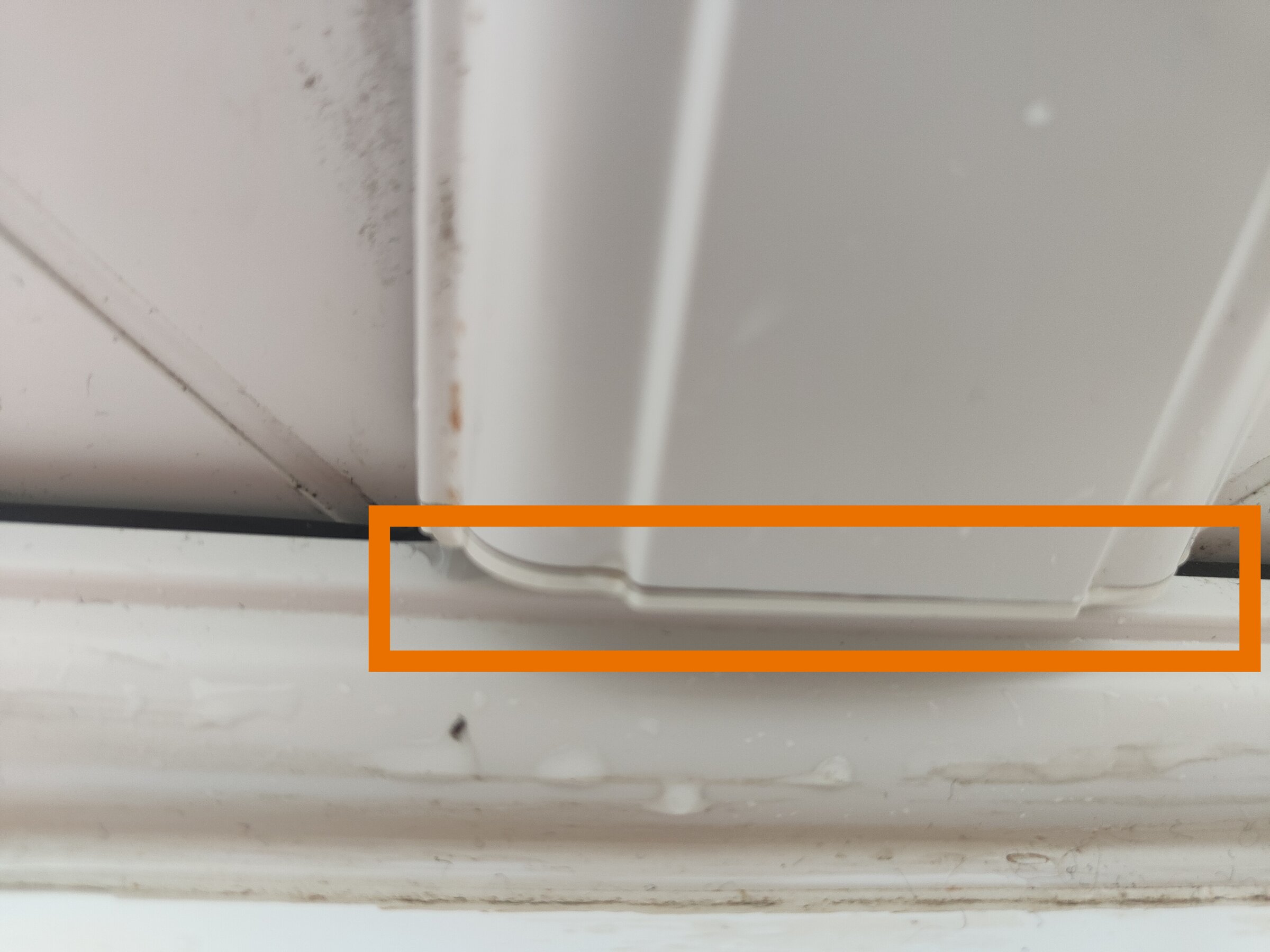

[GALLERY=media, 107656]Leaky astragal by phoenixw posted 14 Feb 2022 at 8:14 PM[/GALLERY]
We have an outward opening uPVC French door that has a leak from the bottom end cap of the bar between doors. The drainage in the frame seems to be working fine and there's very little in there even after a heavy day like today!
Any ideas what I should be looking for which might be causing ingress? Imo the fact the frame has little water in makes me think the door seals are pretty good, is there any part of the door I should be checking to see whether a seal has perished or some silicone needs renewing?
Thanks for taking your time to read my post!
