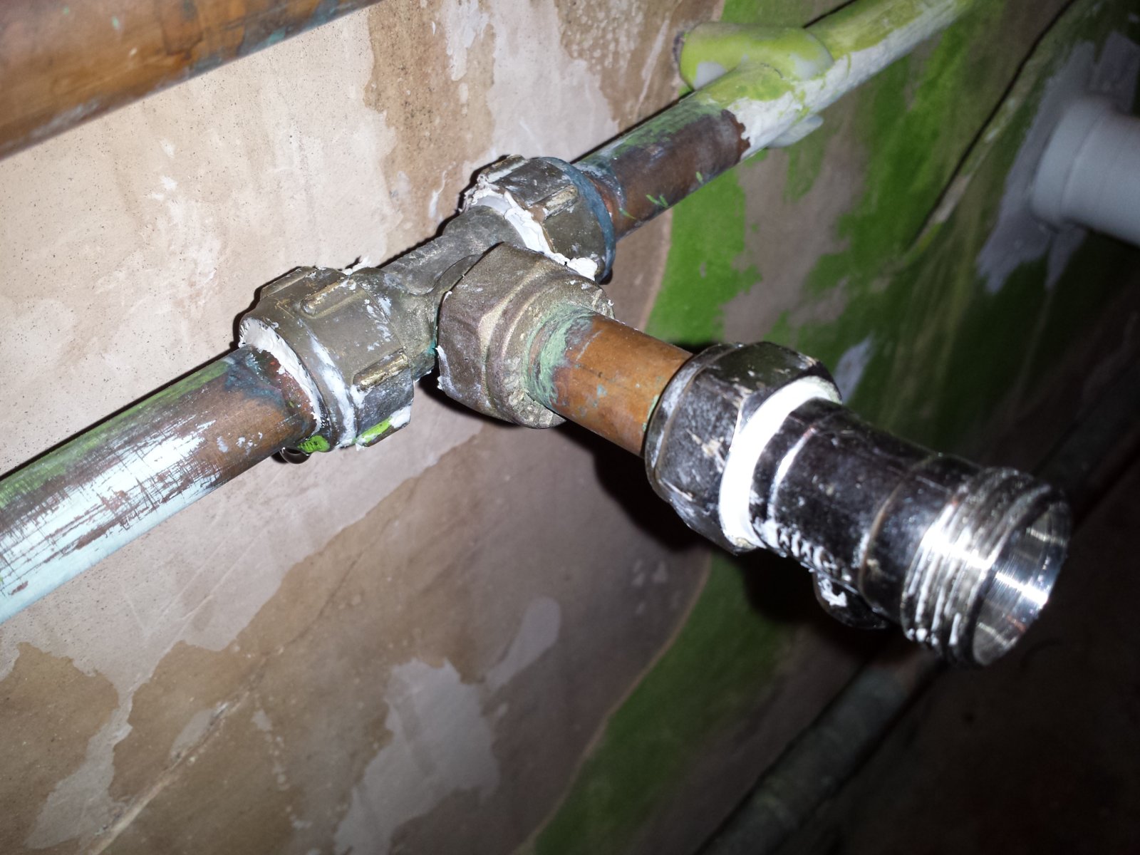

Hello,
I recently had to adjust a tee in a compression joint; the pipe teeing off the straight pipe was angled too far up, so I slightly loosened the two nuts (by about a quarter turn), re-angled the whole thing, then tightened the nuts again. Then a very slow drip started from both the compression joints, so did the following:
1. Tightened them some more
2. Removed them both, wrapped some PTFE tape around the threads and olives, then did the nuts up again
3. Removed them both, removed the PTFE tape, added some Fernox jointing compound to the threads and the olives, then did the nuts up again
....After steps 1 to 3, the drip remained, but now only from one of the joints.
4. Foolishly bought a new tee, then realised it's impossible to remove the old tee because the two pipes going into each end disappear through the wall and I can't pull them out of the tee.
So, seeing as it's nigh on impossible to get a plumber to come out to do such a trivial job, especially at this time of year when it's getting really cold, does anyone have any suggestions as to how I might be able to fix this? Please?!
Thanks in advance for any advice,
Paul
