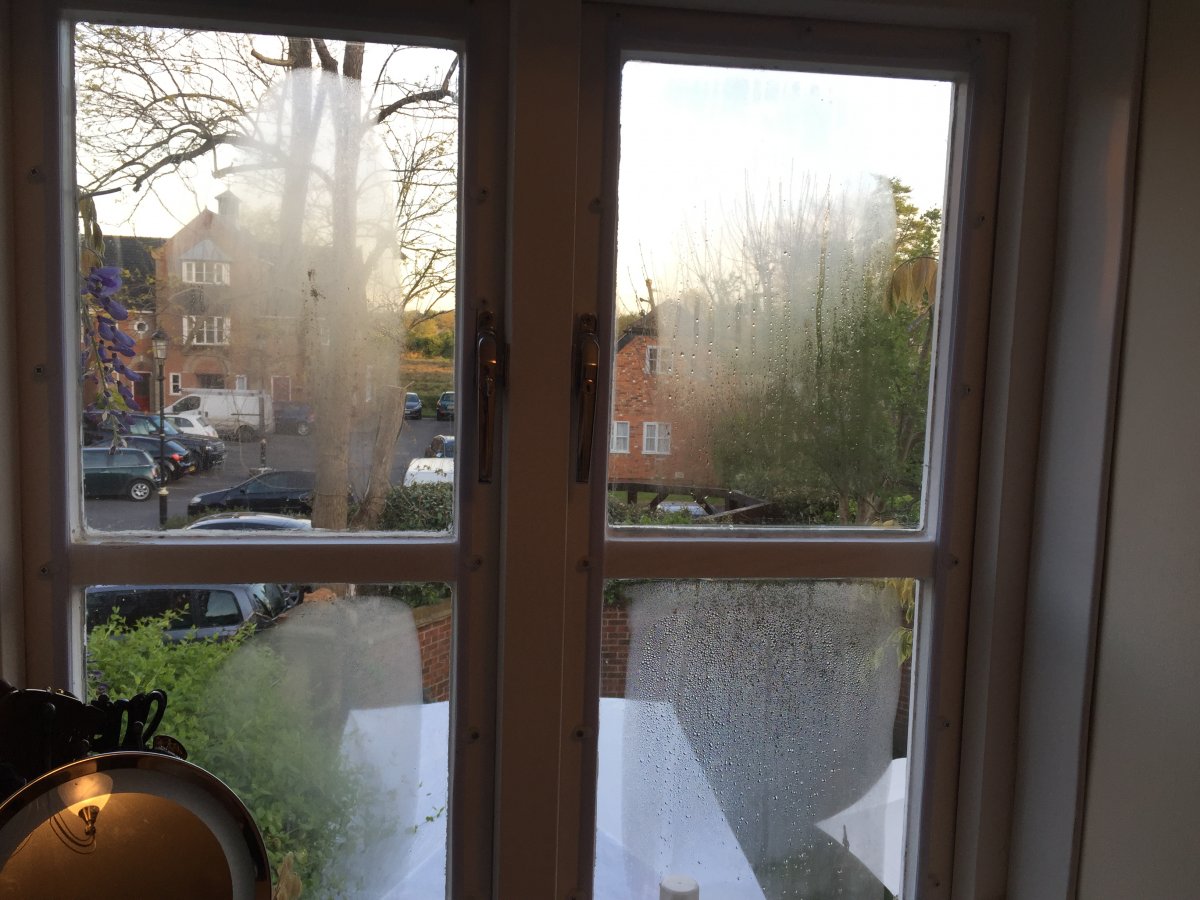

My wife and I recently moved into a grade II listed cottage, which has timber casement windows, with secondary glazing attached to each glass pane internally. When we moved in, the majority of the windows had been neglected for 15-20 years - all mouldy and black. I have recently embarked on a project to refurbish each one - notably cutting out any mouldy wood, sanding and cleaning them, and repainting them with a water based satin paint.
I have completed 4 sets of windows so far - 2 of them are fine - however 2 have started misting up on the inside of the secondary glazing - as shown in this picture:
I can't really figure out why two are fine, and two suffer from this issue. Of the two that are misting up, one is on the front of the house and one is on the rear. So it doesn't seem to be location specific. All the windows are very similar, and all have the same secondary glazing. But it's obviously an issue as the condensation forms, and then forms drops of water inside the glazing which are starting to cause mould again.
I should point out I re-applied the secondary glazing after a dehumidifier had been on in the room for 24 hours, but I have read that these secondary glazing units are not 100% sealed anyway, and water will always find a way in. But how do I stop this? I've read about adding a small hole inside the glazing to the outside, but does this work? I've also read about putting silica gel inside, but surely this wouldn't stop all the condensation?
If anyone can shed any light on this it would be appreciated :).

The way to do it:
Seal the secondary glazing on the house side as well as you can. For example draught strip.
Allow the space to ventilate to the OUTSIDE. Usually old windows are pretty leaky, but if not, you can drill a small hole, sloping downward and outward, in the frame and stuff it tightly with mineral fibre to prevent dirt and insect penetration. It need only be a pinhole, because the expansion and contraction of the air in the cavity will give all the movement you need.
The outside air is colder and contains less water vapour than the inside air.
Your objective is to keep air from the house out of the cavity, and let outdoor air in. The air in the cavity is practically still so it still works as an insulator.
Make sure there is no rain ingress to the cavity or you may still get misting on rainy days.

Thank you :). The glazing is sealed very well on the inside - there aren't any obvious areas where it would leak. Did want to try drilling a hole, but I can't tell where the glass runs to, and am worried I'll drill a hole into the glass. But I'll look at it a bit more closely and try and figure it out.
the hole can be in the frame or mullion. Need not be near the glass.
Thanks JohnD. The hole has to be inside the secondary glazing though? As there isn't a lot of room to play with. The glazing pretty much just covers the glass + a cm or so for the seal.
yes, the hole has to ventilate the cavity between the inner and the outer glazing.
Looking again, I see your secondary glazing is attached to the casements, not the frames.
One caution about drainage holes through the timber window frame. The tube drilled through the timber should be sleeved to prevent water being absorbed from the tube into the untreated timber wall of the tube. This can make the timber damp and thus accelerate decay of the timber frame.

having looked at the way they are fitted, I think they are worse than most secondary glazing, because they are fitted to the sashes, not the frames.
Secondary glazing is most often fitted so that the whole of the original window assembly is on the "cold" side of the secondary glazing. So the typical leakage and draughts around openable windows is able to ventilate the cavity sufficiently to keep the moisture content more or less at outdoor levels.
