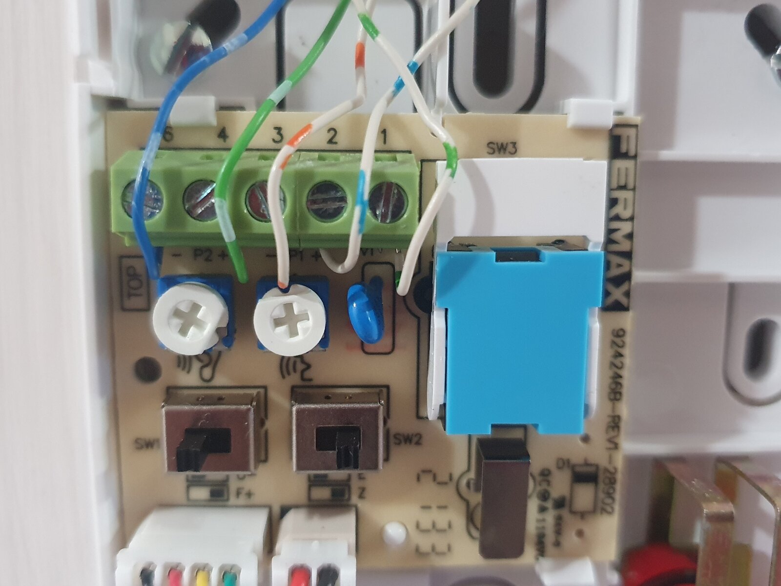

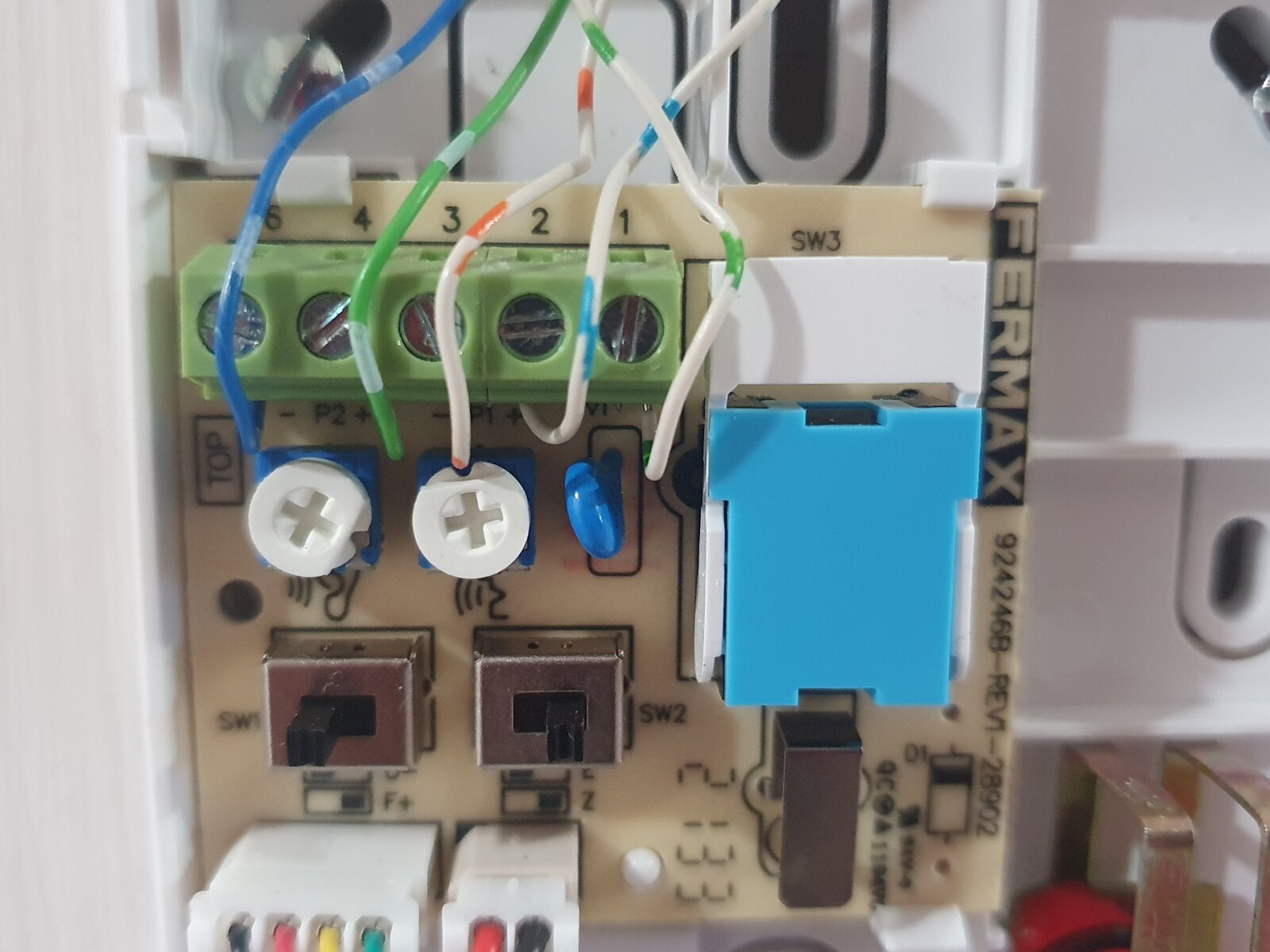

I replaced a Terrando handset with a universal handset made by fermax, there was many phones wiring on the the instruction apart from this one. so here are the photos to show how.
The number 4 cable (Org/Whi) is not used on this phone as I think this is the do not disturb and this handset didn't have this function.
