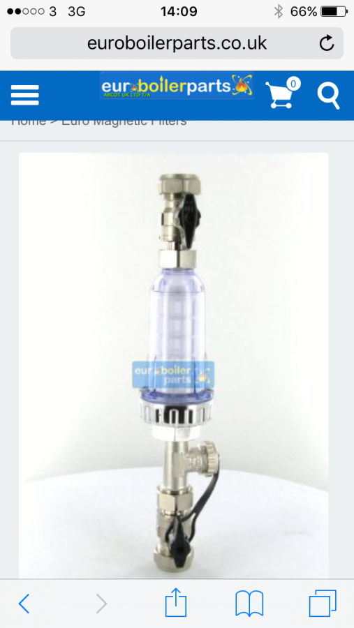

Had a veismann combi boiler fit 3 years ago along with a magnaclean 2 pro and kept up the servicing.
At the weekend the boiler failed due to the smaller heat exchanger being blocked with small shards of magnetic material causing an F2 Burner fault.
Despite it not really being a Boiler Issue and technically not covered by the warranty the Veismann engineer was great, replaced the faulty part, flushed boiler and got me up and running.
On checking the magnaclean there was a small thin film of crud on the magnet but not a single bit of magnetite shard despite the core being magnetic.
In fact each time it has been checked its looked pretty clean which leads me to believe its simply not working.
Clearly I need to flush the system first and put inhibitor in but why didn't the magnaclean work?
Already thinking of replacing all radiators to ensure a clean system but is this necessary.
Is there some better filter that will catch these larger bits of magnetite ?
Fernox TF1 is well rated but to me it looks like an almost identical design so sceptical?
Spirotech MB3 looks promising but unsure.
All help appreciated
