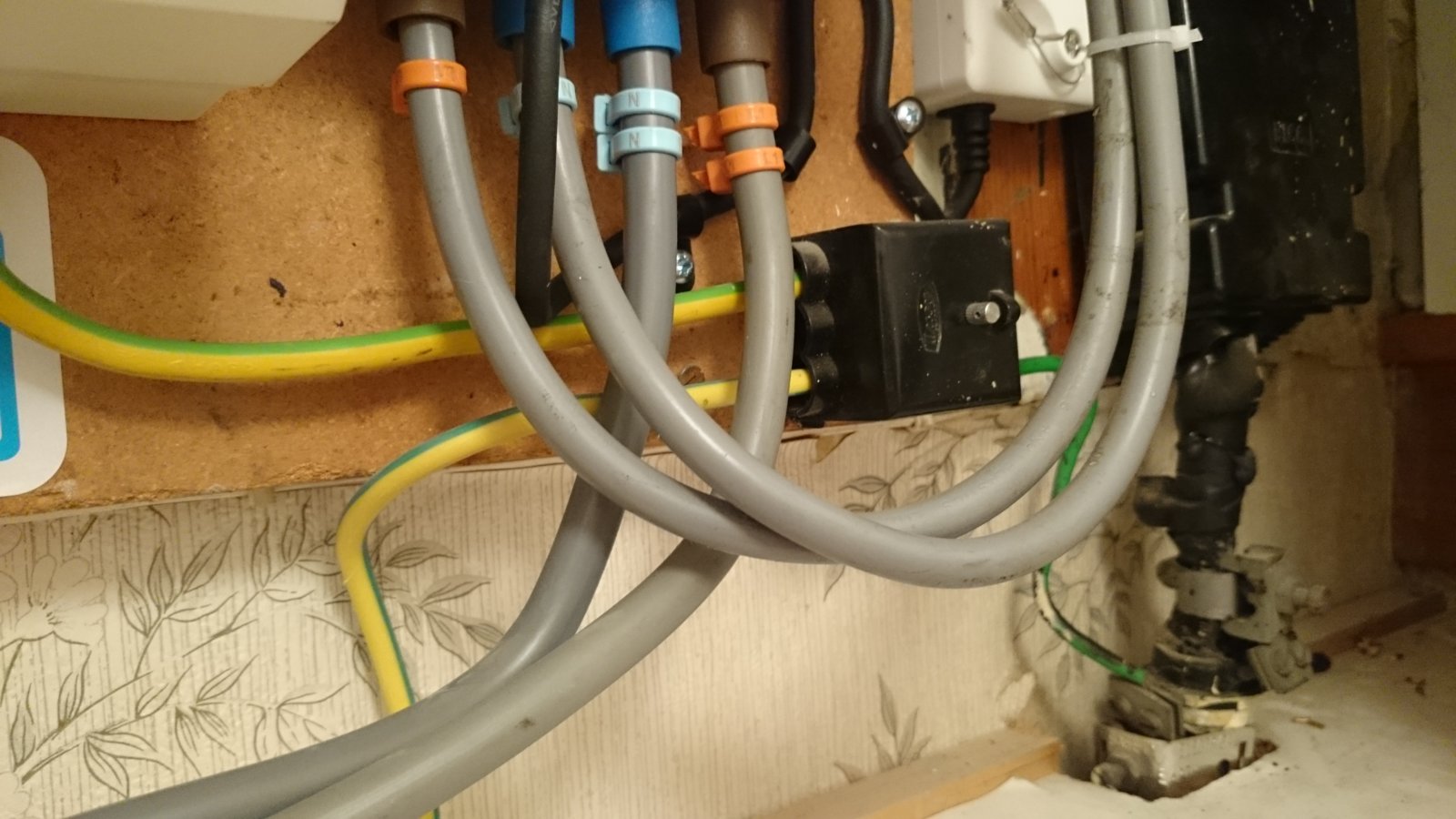

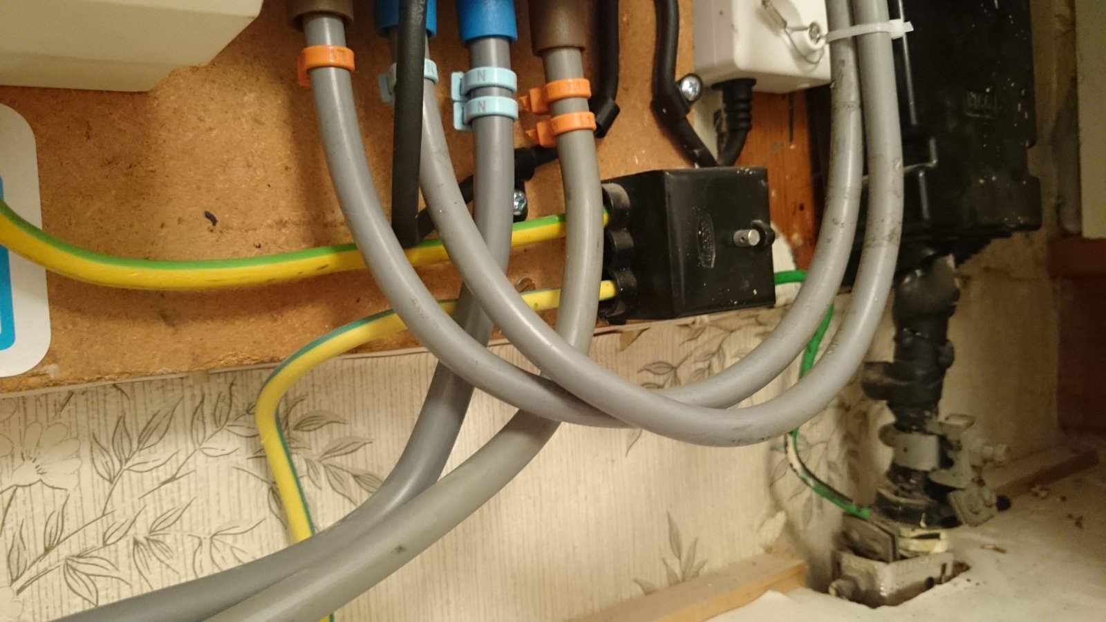

It seems you have a dedicated cooker circuit which is not being used, and your cooker is connected "somehow" through a plug and socket. What are the cooker details? and can you post a pic of your consumer unit/fuse box clear enough to show size details and descriptions.
The cooker is an Electrolux Induction hob.

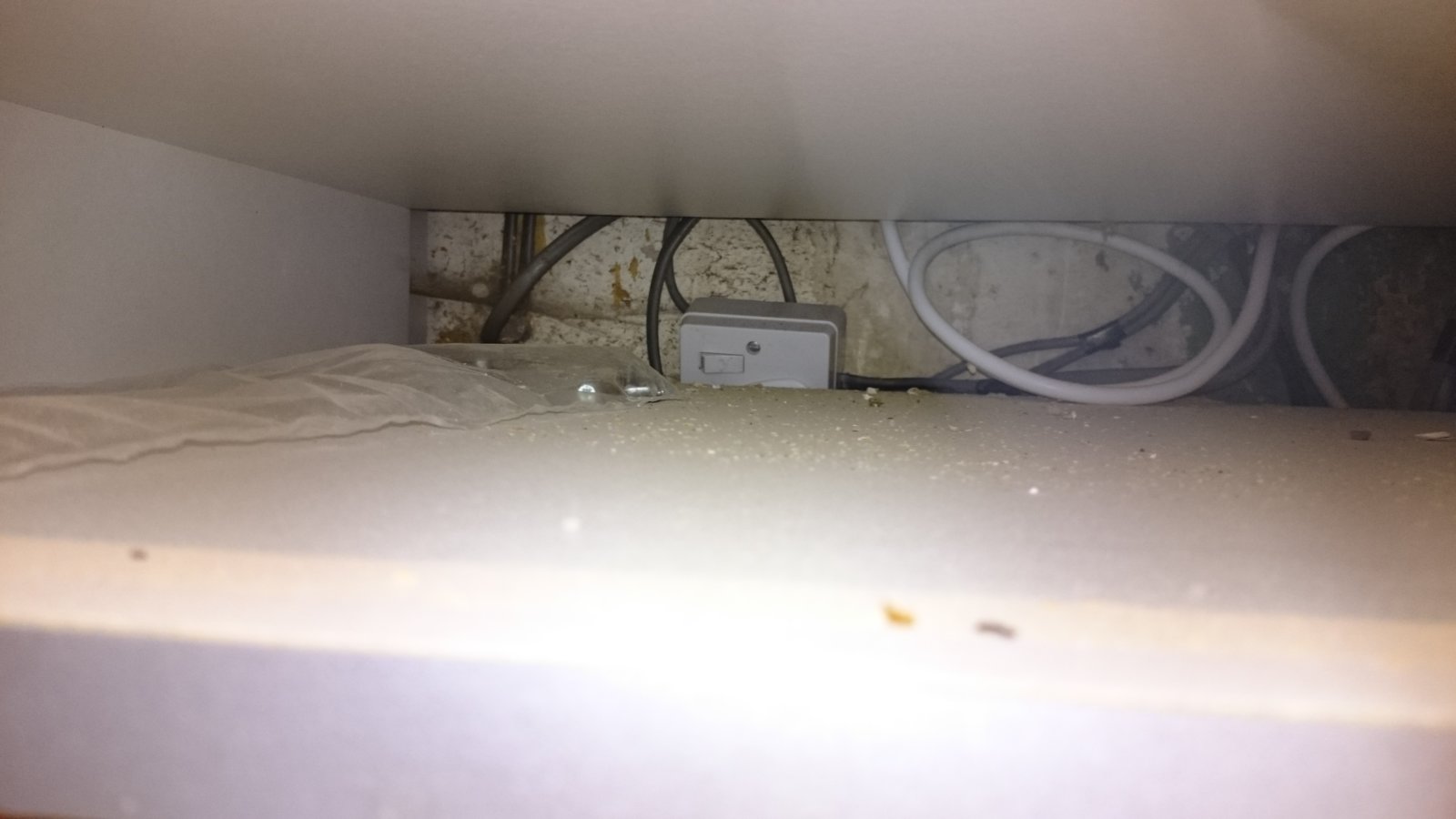

And this is what is visible when the bottom section is removed, the switch you see is on btw.

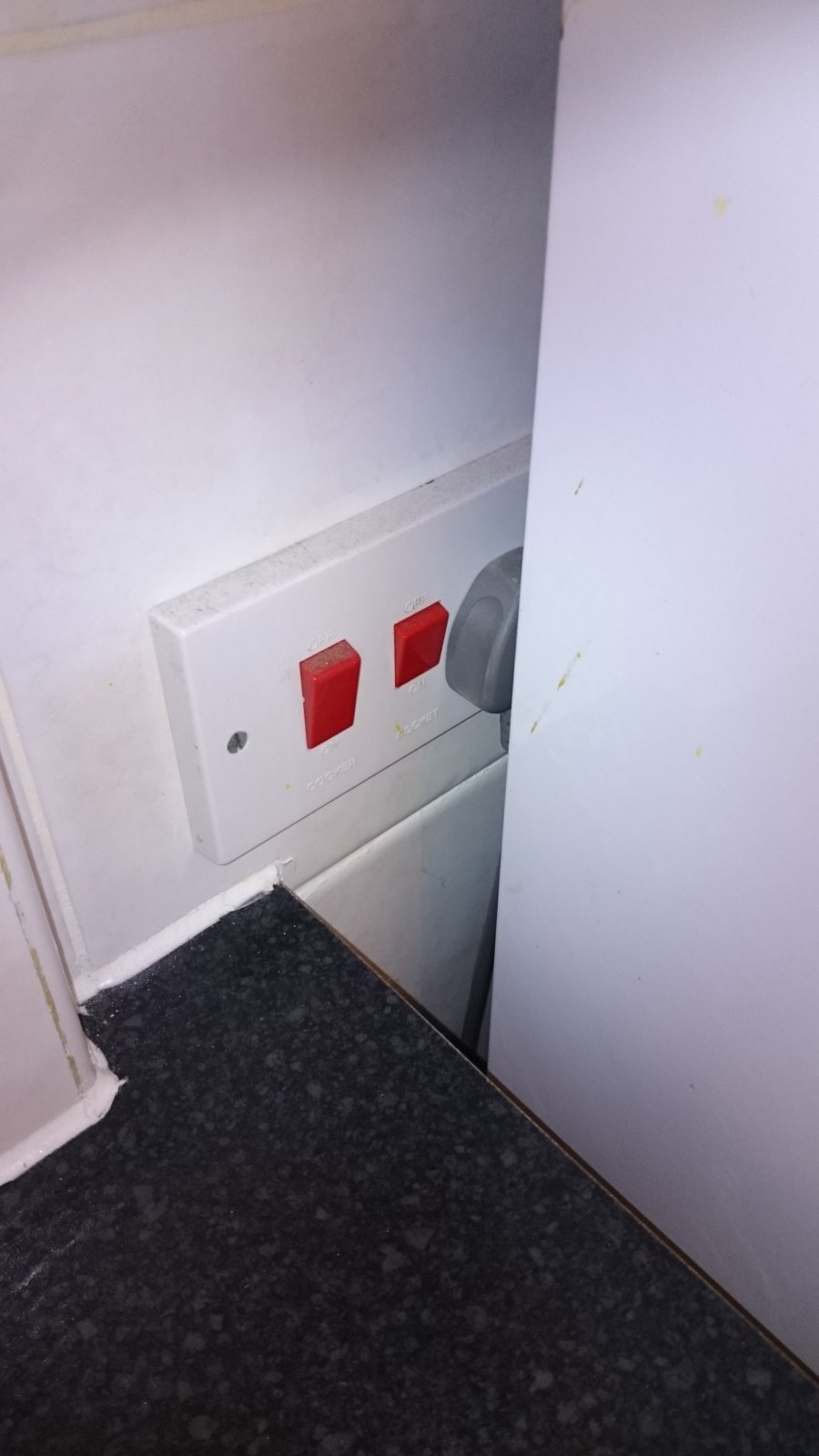

Here's something else that's weird, what you see here is red wall switches in the kitchen with one plug attached, the one on the left says COOKER underneath it and is on the on position, the switch to the right next to the grey plug says SOCKET underneath, this too is on. if I switch any of these off the fridge turns off, how crazy is that? image supplied.
I can understand why the fridge turns off as that plug connects to it, but why the one marked cooker on the latest image turns off the fridge is anyone's guess.

When elements fail they can sometimes short to earth, though usually more common with water heating elements, this can often trip an earth trip like you have, the mcb works different, so its common for an Rcd to go off but the Mcb stay on.
If the fault blows clear it is possible for the Rcd to reset but the element no ,longer work.
Its also possible the element if it has failed has blown something internal to the oven possibly the control switch.
It appears the original cooker switch is not being used for the cooker and simply has the fridge plugged into it, the mcb marked cooker will turn off the plug attached to the unused cooker outlet.
