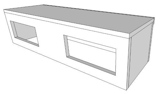

Hi there, I have a 1930s straight staircase which is in decent condition structurally but requires some attention. My plan is to renovate it by cladding over existing treads and risers and fix the squeaks from underneath - thankfully I can gain easy access as it is all open.
The main issue I have is that the bullnose bottom step is 22cm high from the floor. And 22cm is the max allowed by the regs as I understand it. The remainder of the steps are each 18cm.
Is it possible therefore to replace just the bottom step relatively simply? I can perhaps fix battens and or angle brackets (with possible use of pieces of plywood screwed in at the back of the step) to the underneath/sides for increased support to the newly installed step? Shall I perhaps use some small screws sparingly and wood glue liberally?

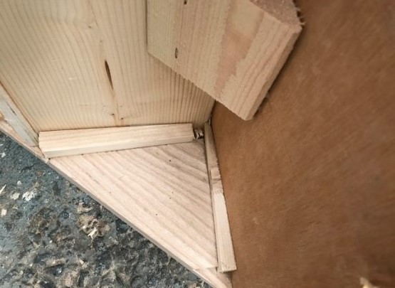

No, it isn't quite that simple. It's because the treads and risers are all held in dovetail shaped housings by glued wedges. This photo shows the construction used:
You can actually get away with cutting out the bottom tread and riser, but I would then ensure that both the stringers are adequately fixed down to the floor (with largish angle blackets) - this is because the bottom riser is sometimes (but not always) used to fix the stairs to the floor at the bottom. I'd make-up a new bottom step as a sort of (inverted) plywood box with a planted-on nosing to match the other steps, fixed to the floor and screwed to the stringers and the lowest remaining riser. This will require access from beneath the stairs, so the last bit of the underdrawings would need to come out
The cut-outs are to allow you to get a cordless screwdriver in there, If access from beneath isn't feasible, the cut-outs could always be put in the front of the step and covered over by 6mm plywood after the box has been fitted.
I'd be wary of depending on a couple of battens screwed into the risers as the gives no support in the middle of the tread whereas a box does
BTW, yes, well within the capabilities of a competent DIYer
