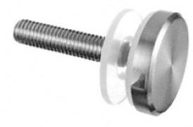

Although I was thinking in terms of drilling part way through and Aralditing the legs onto the bottom using cut down machine screws (and maybe washers) Harry talking about drilling through put me in mind of the fittings which are sometimes used for glass balustrades, etc:
That was brilliant. Much appreciate the effort to pull that post together! Looks like something I could reasonably manage. Off to order the diamond saw
