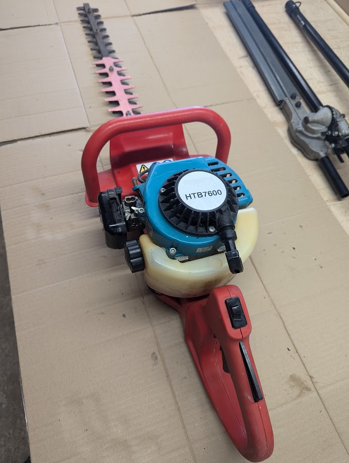

Hello, just wondering if anyone can help me get my hedge trimmer working.
When I press the primer bulb it doesn't draw any fuel through the line
Any ideas guys?

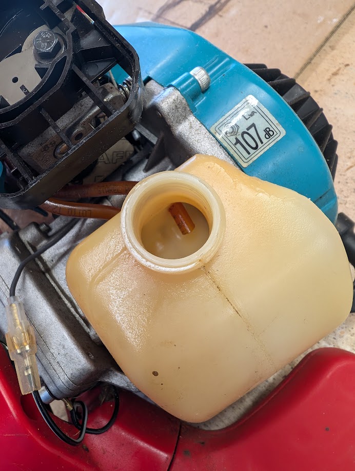

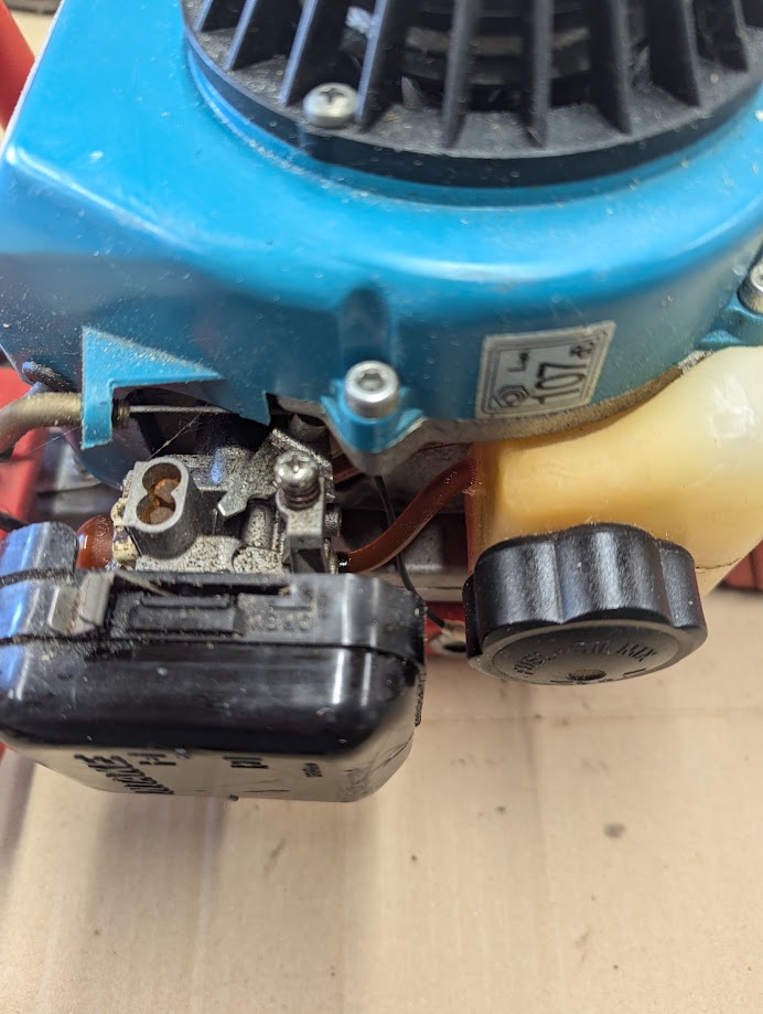

Okay so I had a little look today but couldn't see anything obvious, do I need to remove the pipes to inspect them? they are fiddly to access.
The long pipe in s the only one you are interested in.....with the filler cap off you should be able to fish the pipe and filter out for a look see.
John

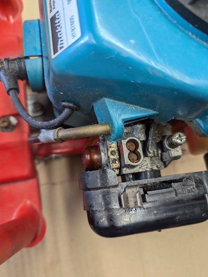

Only one of the pipes go into the fuel tank and it's way too short to fish out
"Only one of the pipes go into the fuel tank and it's way too short to fish out"
Where does the other one go to then

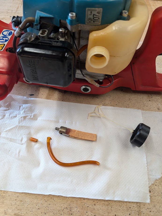

Yep, that's the broken fuel pipe, and the thing above it is the filter.
The filter lies in the bottom of the tank, the pipe connects to the filter then passes through the rubber grommet and connects to the carburettor.
A simple and frequent repair!
Here's when the fun starts. The pipe needs to be the same diameter as the original, both inside and out. Replacement fuel pipe is available from GHS Ltd and you need the yellow stuff (I forget it's name for now!)
John :)
