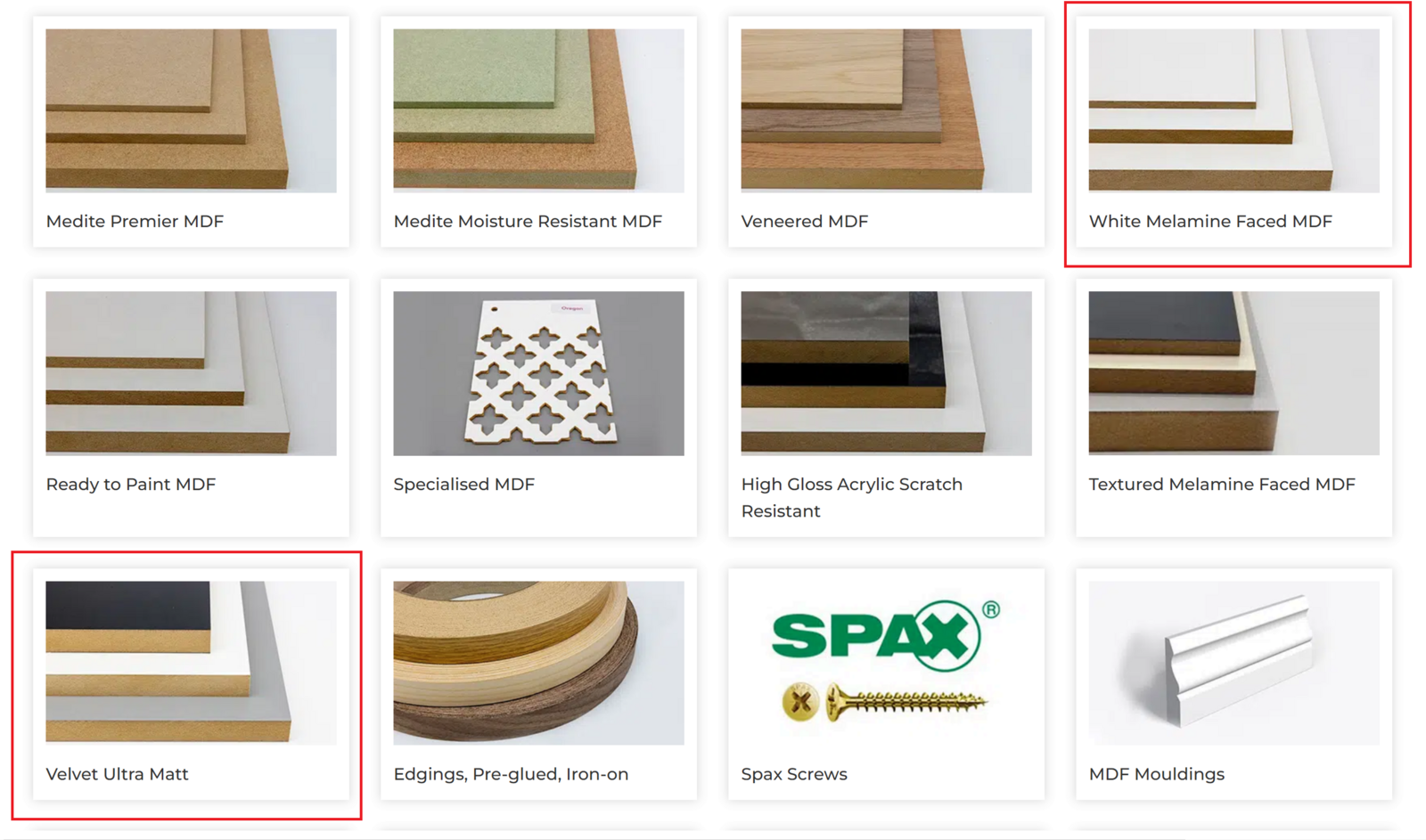

Dear DIYNot forum members,
I'm in the market for some MDF and, depending on the supplier, I keep bumping into different finish options: standard melamine, "Velvet", "Finsa 12Twenty".
For example:
The descriptions on the vendors' websites look like something generated by ChatGPT AI and I can't see through the marketing copy.
I'm building a bookcase. I want it to have white matt finish. What's the difference between the offerings and what material should I choose?
Basically moisture resistant mdf is better quality than the shed stuff but more expemsive, that said the latter is fine for shelving IMO. You can get it cut down to fit in the car at bee and queue and then finish off at home. I designed a book case from a single sheet of 8x4 as a challenge and to save materials. Plenty of youtube videos on preparation and painting. Good luck.
Blup
You need Finsa hydrofuga ideally.
its made from Eucalytus and is super smooth, ideal for painting.
it’s a lot more expensive, but it means you will end up with a nice finish
sand the edges with 120g, 180g, 320g so they are polished, it burnishes the edge and closes it up. Then paint the edge with a sealer and sand again, before painting whole thing.
if you buy bog standard mdf from a builders merchant, when you paint it you will see all the fibres through it.
