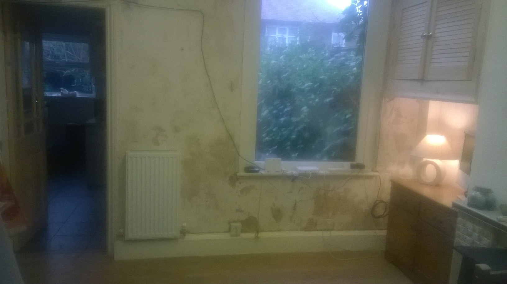

I took photos today. Unfortunately I'd already partially cleaned up before I knew I was going to want photos, so the mould isn't there in it's full glory any more, but you can still see a bit!
Full view of the offending wall:
[GALLERY=media, 96553]Inside1 by Hairball posted 27 Nov 2015 at 3:31 PM[/GALLERY]

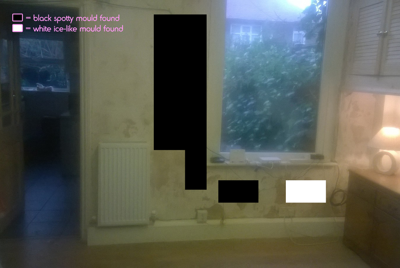

Full view edited to show where the mould patches were:
[GALLERY=media, 96554]Inside1b by Hairball posted 27 Nov 2015 at 3:31 PM[/GALLERY]
Beside the window:
[GALLERY=media, 96555]Inside2 by Hairball posted 27 Nov 2015 at 3:32 PM[/GALLERY]
Beside the window (lower down):
[GALLERY=media, 96556]Inside3 by Hairball posted 27 Nov 2015 at 3:33 PM[/GALLERY]

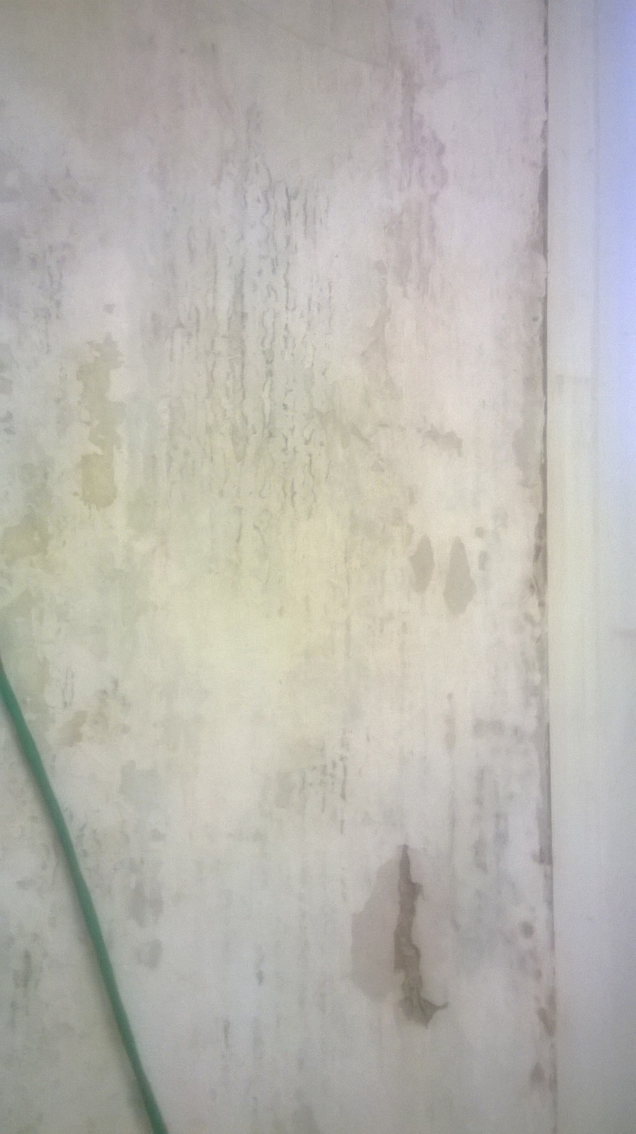

Below the window- white mould was mostly where you see the chipped off plaster- there were also the plaster "bubbles" (raised bits with air behind) I talked about here, so what's missing there all fell away easily, either with the wallpaper, or when I "popped" a bubble.
[GALLERY=media, 96557]Inside4 by Hairball posted 27 Nov 2015 at 3:34 PM[/GALLERY]

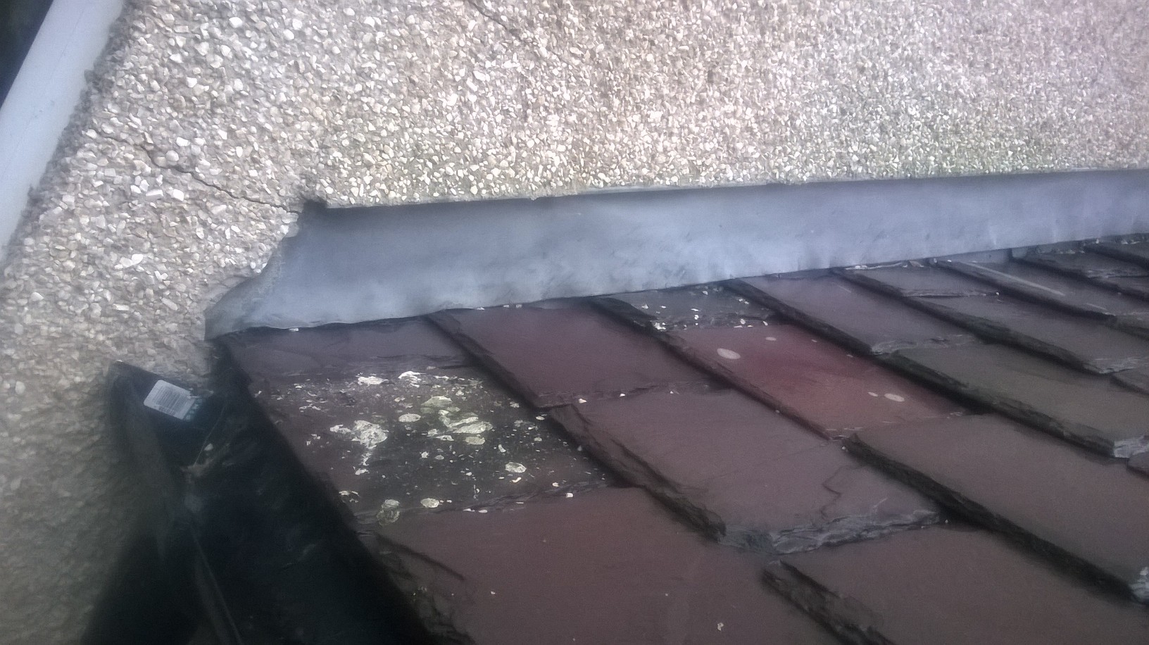

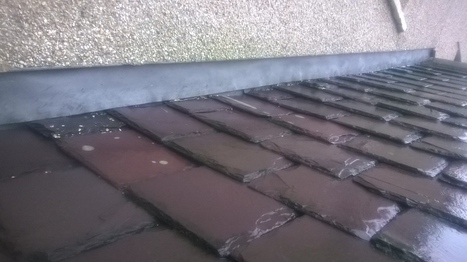

The main suspect would be the junction of the kitchen extension (cavity wall?) and the old wall. A pic of the flashing where the extn roof meets the old wall would help.
Next suspect would be the dashed render.

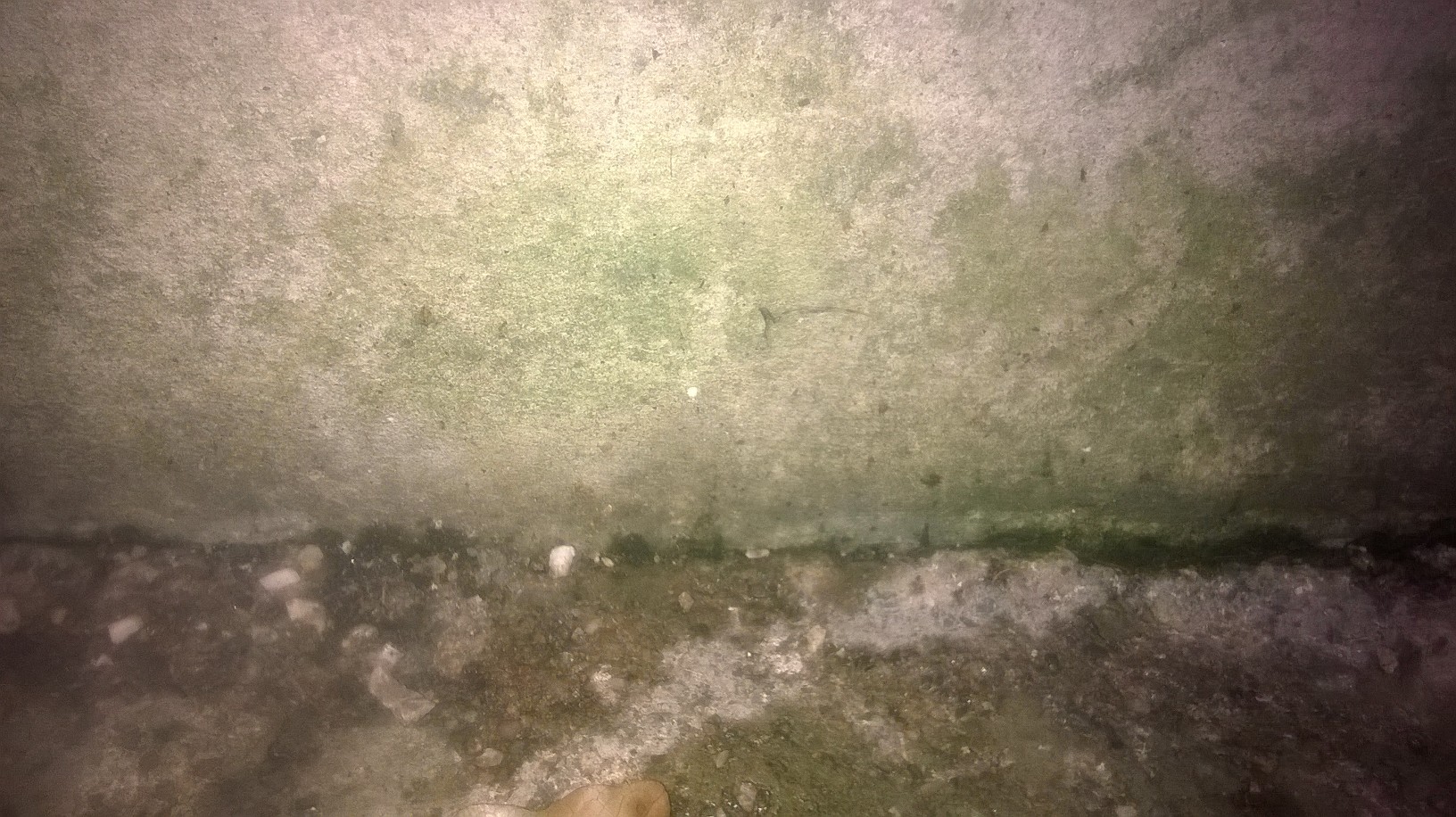

The smooth render near ground level seems to be in ground contact and bridging any DPC. A pic here as well please.

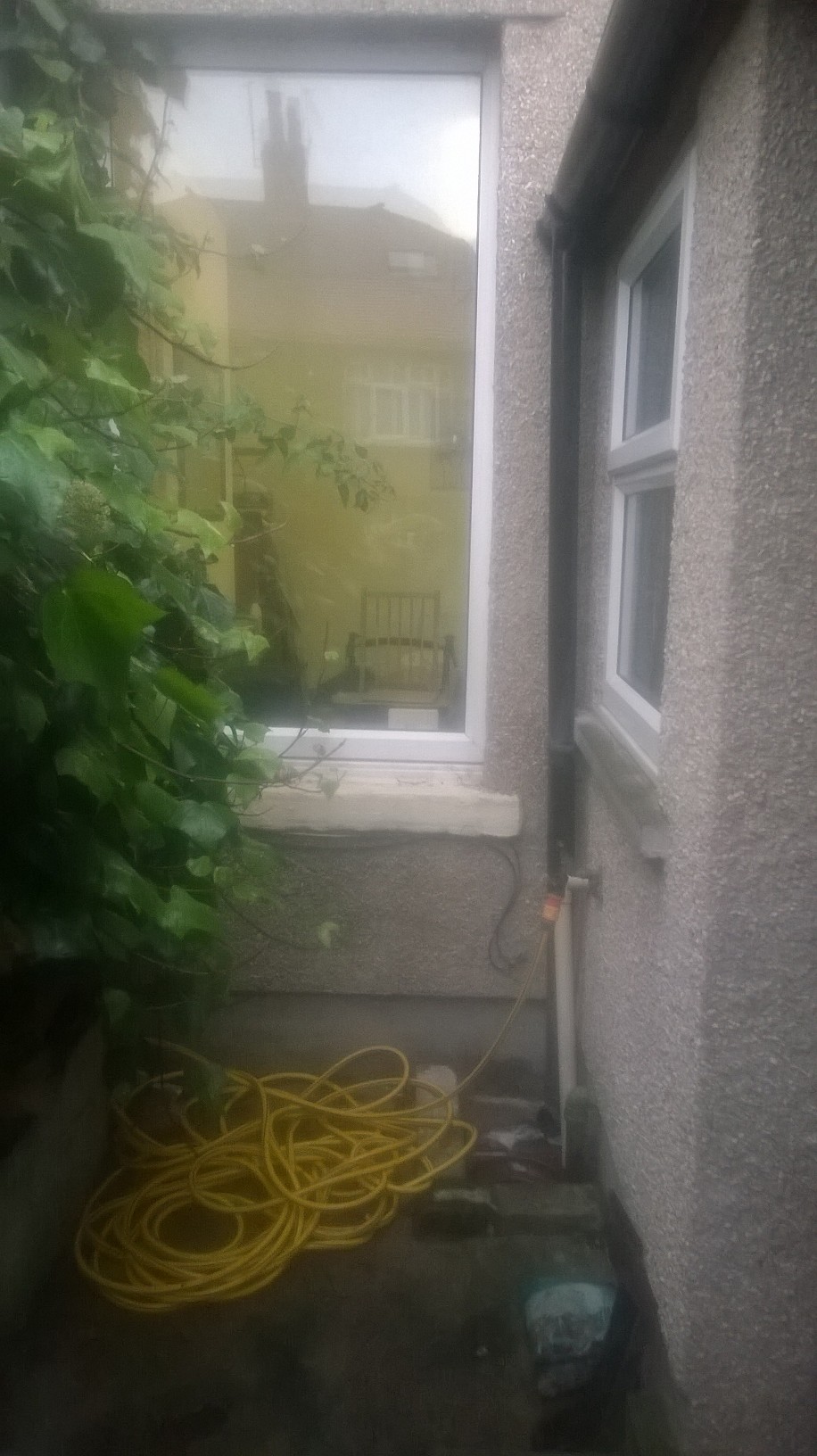

The gulley on the house wall is damp. A correctly installed gulley doesn't need a dam.
Does the stone cill have a sound throating?
Cut all the foliage well back.

You've got classic condensation mould, in a typical Victorian terrace. The patches are the giveaway, as is that location on the rear wall, which is rendered and that does not help.
Mould only lives off fresh condensation moisture, and is being fed by the starch in the wallpaper paste.
The white bits are salts from the plaster which once drawn out, start to absorb more moisture from the air to get worse and worse.
You will need to deal with your condensation by reading up on it, and then hack off all that plaster and redo it, as once the salts are drawn they will continue to be.

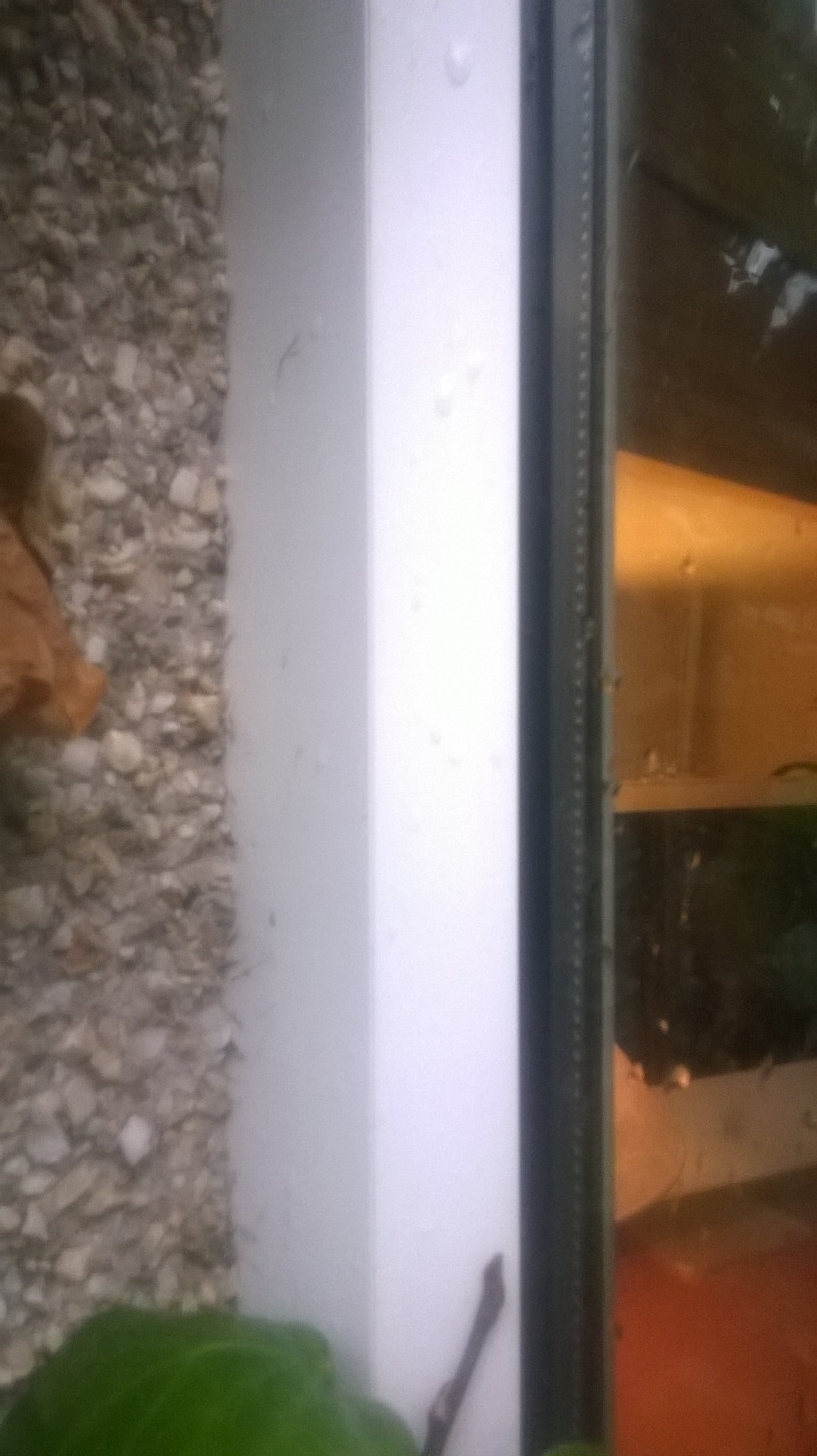

I tried to check the seal around the window- I couldn't see anything- pebbledash covers it all.
[GALLERY=media, 96584]Outside_window33 by Hairball posted 28 Nov 2015 at 6:55 PM[/GALLERY]
[GALLERY=media, 96582]Outside_window1 by Hairball posted 28 Nov 2015 at 6:54 PM[/GALLERY]

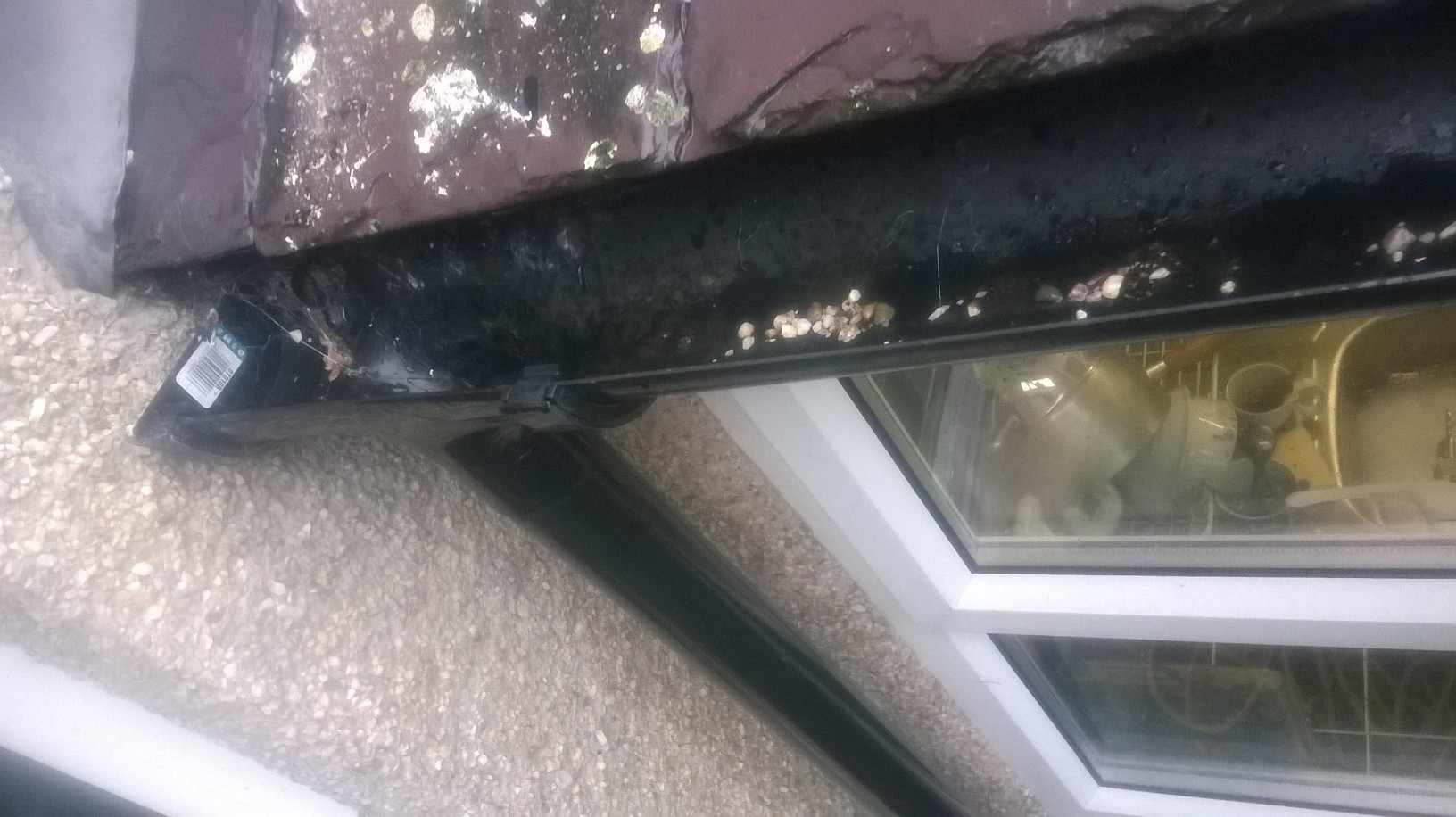

I checked the gutter- there's no blockage / nothing leaking. It was raining (as usual) when I looked.
[GALLERY=media, 96579]Gutter by Hairball posted 28 Nov 2015 at 6:53 PM[/GALLERY]

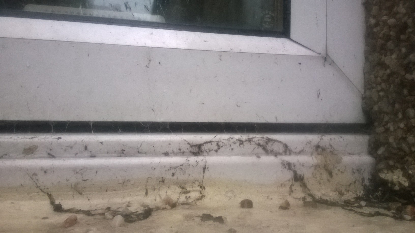

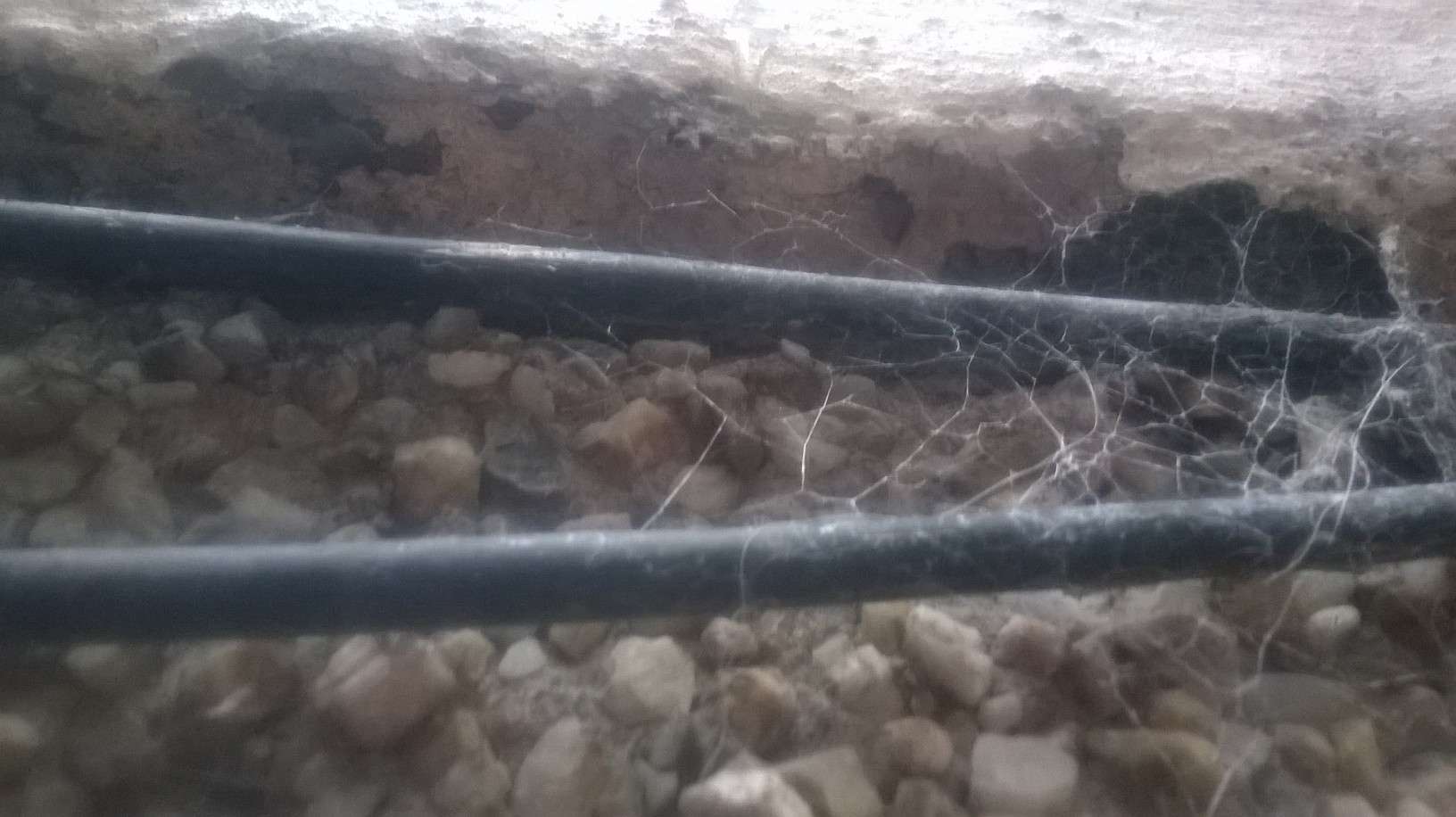

I had a look under the windowsill- there isn't much of an under, nevermind a drip groove (the spider's name is Henry btw- I did ask if he would move for the photo, but it was raining quite hard, and he didn't want to get any wetter).
[GALLERY=media, 96589]Under_windowsill1 by Hairball posted 28 Nov 2015 at 6:56 PM[/GALLERY]
[GALLERY=media, 96590]Under_windowsill2 by Hairball posted 28 Nov 2015 at 6:57 PM[/GALLERY]
I photographed the flashing where the extension meets the main wall- btw my dad says the extension is part of the original house- even though it looks like an extension, he was fairly sure it was built when the house was.
[GALLERY=media, 96585]Roof1 by Hairball posted 28 Nov 2015 at 6:55 PM[/GALLERY]
[GALLERY=media, 96586]Roof2 by Hairball posted 28 Nov 2015 at 6:55 PM[/GALLERY]
I photographed the smooth render where it meets the floor as requested:
[GALLERY=media, 96577]Floor1 by Hairball posted 28 Nov 2015 at 6:53 PM[/GALLERY]
[GALLERY=media, 96578]Floor2 by Hairball posted 28 Nov 2015 at 6:53 PM[/GALLERY]
I also noticed that the pebbledash has a sort of a lip underneath it where it meets the smooth render- it was difficult to show on stills, so I took a video of it:

I think the dam around the gulley is because.. well.. for some reason I have no idea about, the drainpipe doesn't go directly into the drain hole...
[GALLERY=media, 96576]Drain by Hairball posted 28 Nov 2015 at 6:52 PM[/GALLERY]

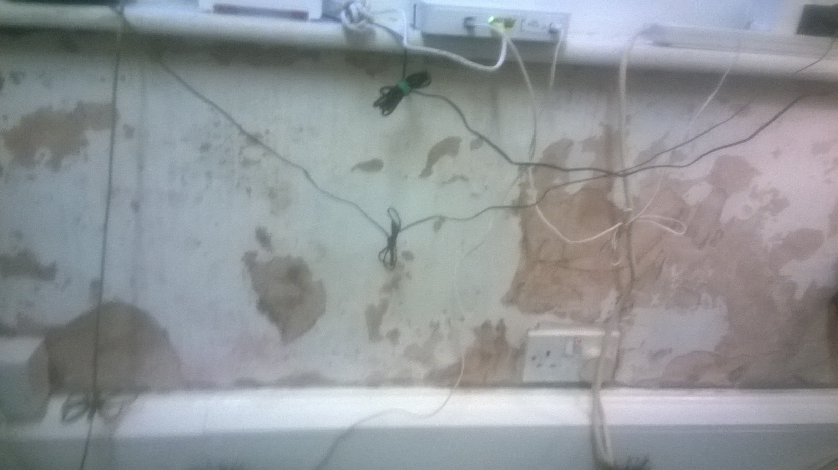

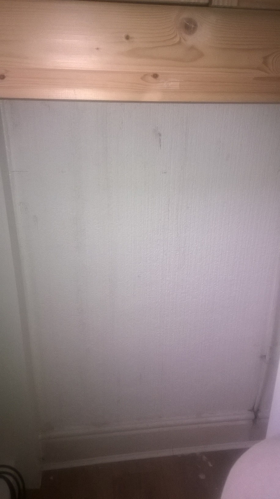

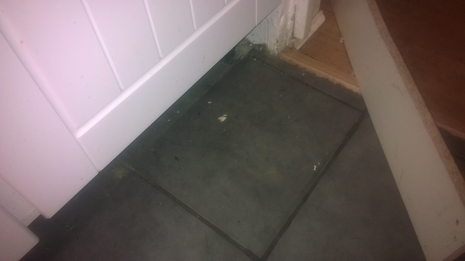

Inside- removing the skirting board is not so easy- it isn't skirting board, it's boxing in. Even if I remove it, I won't be able to see much- all the central heating pipes are in there.
I had a more thorough look at the alcove wall- it all feels good (wallpaper well stuck and nothing crunching behind) except for the bottom 6" or so above the skirting board, where it feels maybe slightly damp and crunchy.
[GALLERY=media, 96575]Alcove_wall by Hairball posted 28 Nov 2015 at 6:52 PM[/GALLERY]

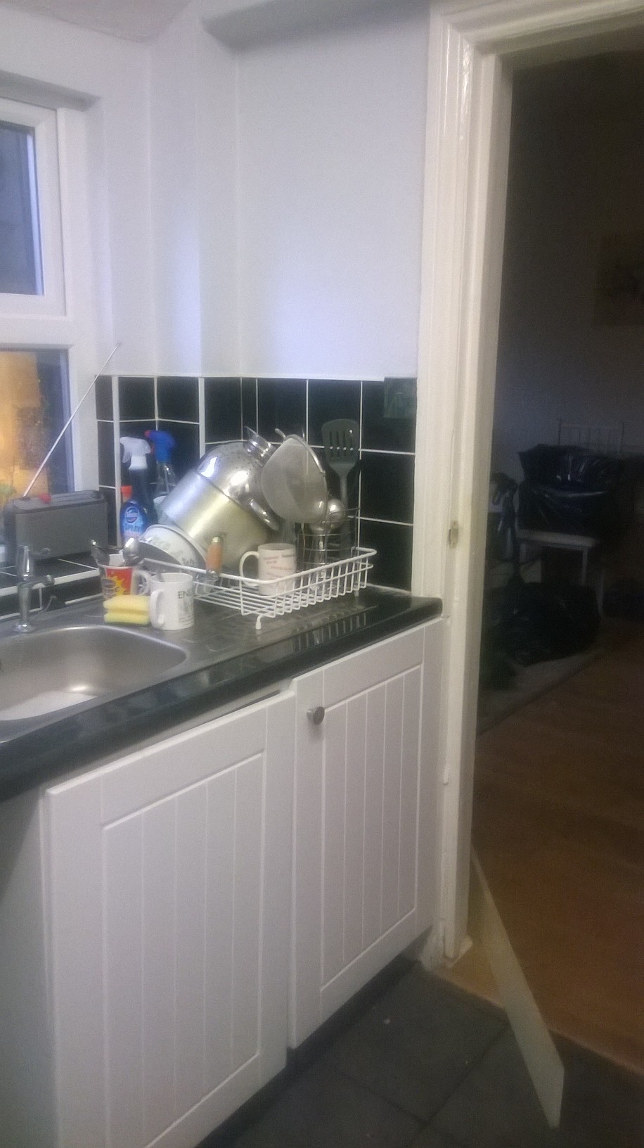

The wall and floor in the kitchen look fine:
[GALLERY=media, 96580]Kitchen by Hairball posted 28 Nov 2015 at 6:54 PM[/GALLERY]
[GALLERY=media, 96581]Kitchen_floor by Hairball posted 28 Nov 2015 at 6:54 PM[/GALLERY]
Though there was once (a few years ago now) a damp problem there- there was a leaking pipe in the wall, I believe- in the corner of the kitchen wall you see in the pic above, there were mushrooms growing! It was fixed and redecorated, and no problems on that side since.

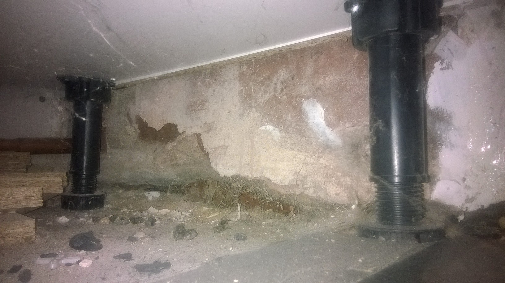

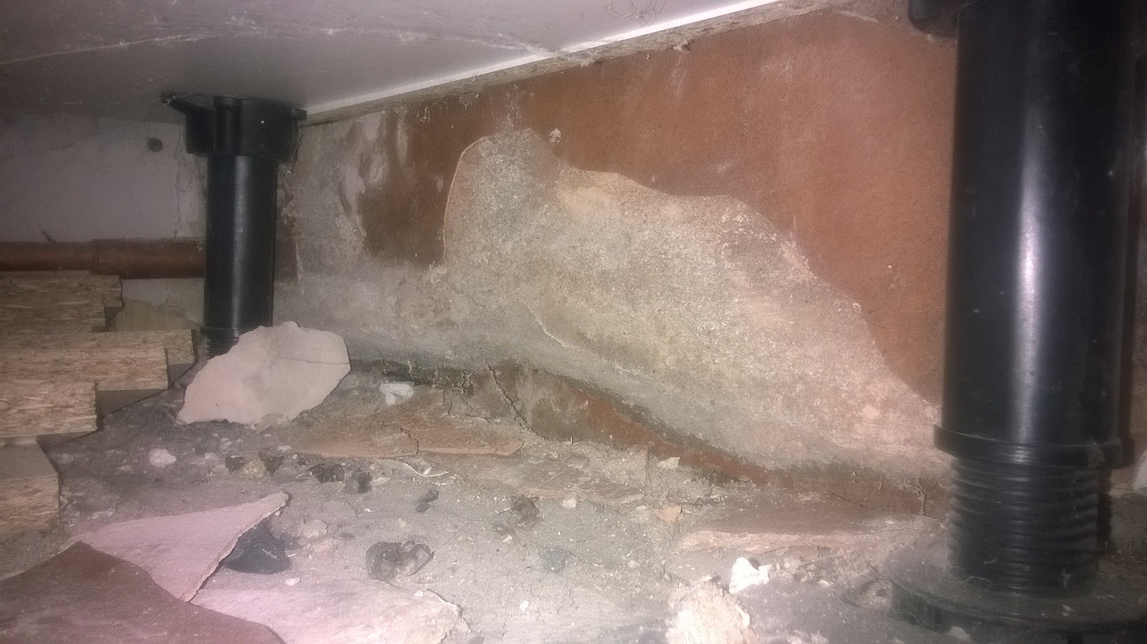

I couldn't really get to the lower part of the wall to get a good look without major dismantling- as you can see there's a cupboard in the way! I did get underneath it though. This is the other side of the mouldy wall- about where the radiator is, but at ground level:
[GALLERY=media, 96587]Under_sink1 by Hairball posted 28 Nov 2015 at 6:56 PM[/GALLERY]
I touched the plaster there to see whether it was damp, and a few chunks crumbled and dropped just with a light poke. :oops:
[GALLERY=media, 96588]Under_sink2 by Hairball posted 28 Nov 2015 at 6:56 PM[/GALLERY]
However, I couldn't feel any damp- it felt dry and crumbly? After the initial few bits dropped off, the rest seemed fairly solid, although obviously I didn't engage in TRYING to rip more off!

Excellent Pictures(y) That gulley needs both the black rainwater and white waste pipe altering so the water discharges into the hole - easy diy job and combined with removing the foliage will help.

You have a condensation problem. The location, the pattern, the type, the mould are all indicative and just can't lead anyone to suspect anything else.
Stop your goose chase, and deal with that. There are threads and the wiki here, or just putting those words into Google UK will throw up numerous results.
I agree with Nige F, the pics are great. And agree with what he said about the gulley pipes. You will also need a (150mm?) gulley grid.
Afterwards remove the dam kerb the mortar fillets, and cut back the wall render to 50mm above ground contact.
The under sink pics shows condensation on the wall: the plaster is in contact with the concrete floor.

1. pic 6 shows cracks in the dashed render - moisture could be entering here, and moving down and into the wall. Have all render cracks sealed with polyurethane caulk.
2. Use this caulk to seal the dash to the window frames - there doesn't seem to be any sealant there at the moment.
3. Run a line of caulk on the cill underside - it will stop the water running under, & perhaps penetrating the render.
4. pic 13 cut back the render 50mm from ground contact. In pic 17 The bump at the bottom of the render is a Bell Cast and its supposed to be there.
pic 16 "alcove" shows what is possibly condensation - keep the chest away from the wall.
pic 20 the DSS outlet box is out of the wall.
