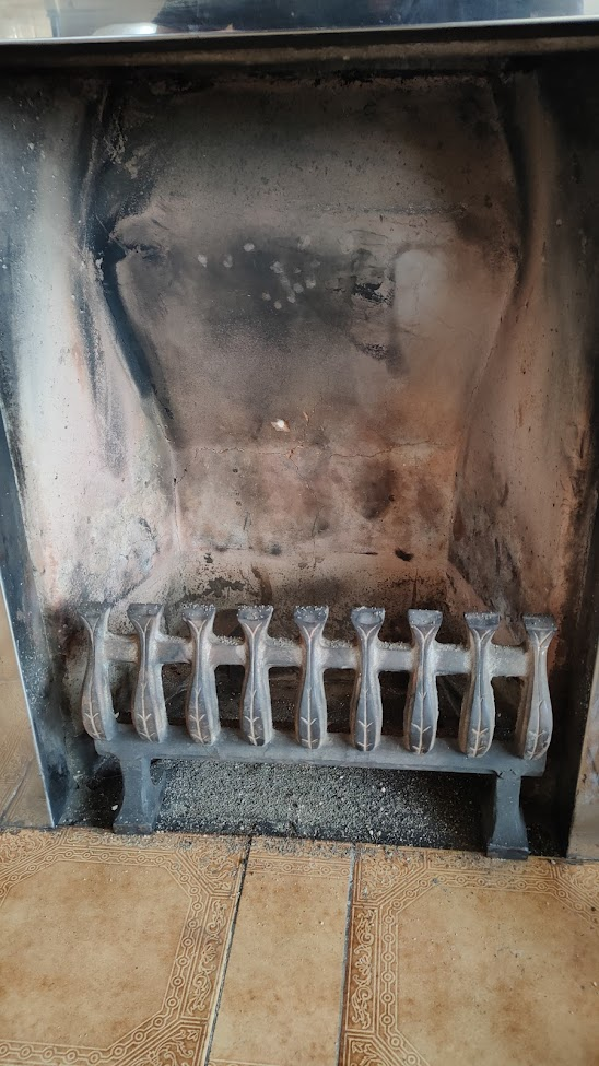

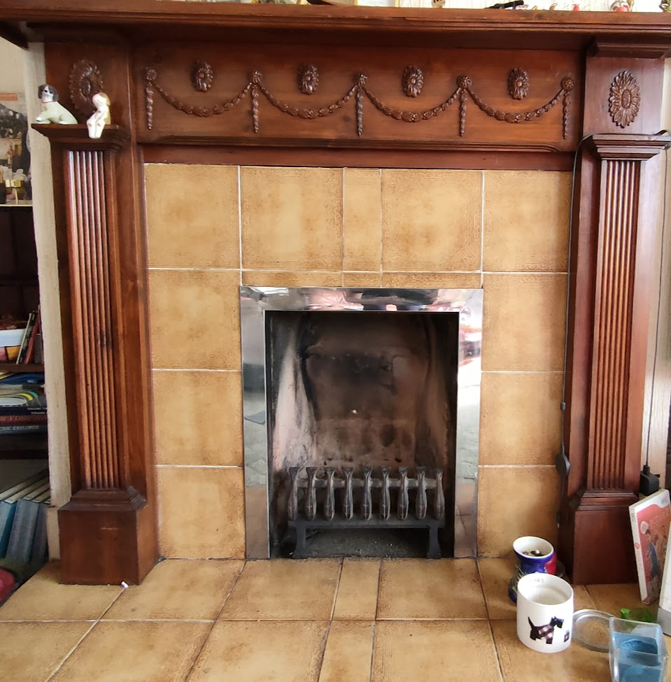

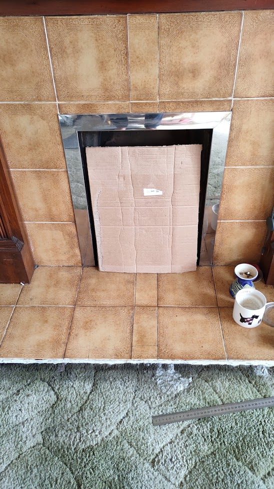

Planning to install a multi-fuel stove, eco conforming etc. It's really small - the cardboard is the size of it - about 4-5 kwh to heat one room.

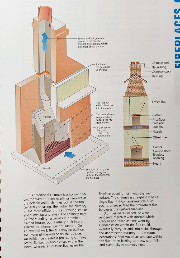

1934 semi. Had an open gas fire in there now removed, chimney swept and checked by registered Sweep and seems ok enough to burn a traditional fire with the new eco fuel.
Why do people install it in a widened chimney? Surely better freestanding on the hearth - as I've seen in houses without a chimney. All the heat then goes into the room.

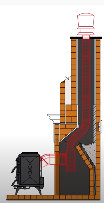

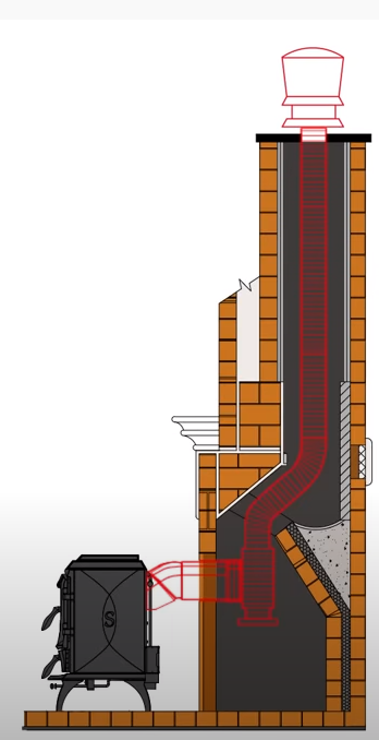

Got 2 quotes and they both want to open out the fireplace at great expense £2-3000. Can't afford all that. Can't the liner go out the back of the stove and use the existing gap to the flue? Possible have to open that bit if not wide enough for the 5 inch liner? Extend the hearth a bit. The second image seems to be my type.
If I really have to remove the fireback is it safe to do it myself. Or at least do the hard labour and get somebody to pretty it up and install the liner etc?

Found a "Stanley Stove" video that is exactly how I want my stove just leaving the existing fireplace more or less how it is.
You can do it like that but will end up with a massive hearth? You need a good amount of non combustible in front of the burner. I wish I had more....
Yes totally doable. My local pub has the same setup and it's what inspired mine. Don't have any pics to hand, but I opened my fireplace up about five years ago and didn't want the stove sat inside it, so I pulled it out so that around three quarters of the stove sits forward of the opening. I just had an off-set steel flue pipe fabricated, supported by one of those collar brackets.. You do need to have a larger hearth though as mentioned above.
Bottom line is, Stove must be installed in compliance with Regs, if it isn't (or you haven't got proof it is) your House Insurance will be void, should anything go wrong. Having had a stove installed myself a couple of years back, it is difficult to describe how hot they can get under the right circumstances, hence now I see the need for the non-combustible material fitted around the fireplace opening!

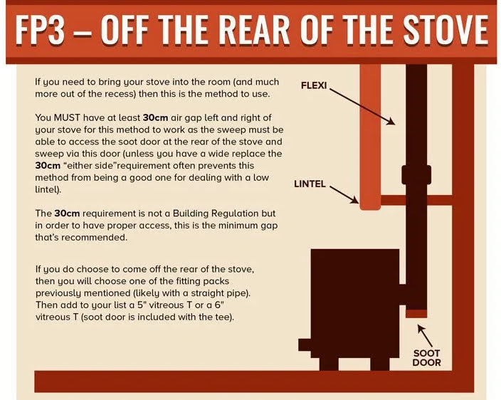

That's what I thought. Just logical but nobody wants to do it - so far! The depth of the stove as it's so small is only 29 cm but I can add a hearth extension to cover the regulations, probably one of the glass ones. The hearth is solid. Kind of stoveI was thinking are very small but amazing. Just to heat one room! With a back plate of course.

Right. Though a free standing stove is perfectly OK if the distances are right. It is after all a fireplace meant for burning coal. and the height as you can see from the cardboard is not great. I want the heat in the room not walled in. In fact I want to be able to put a pan on it. No children here.
