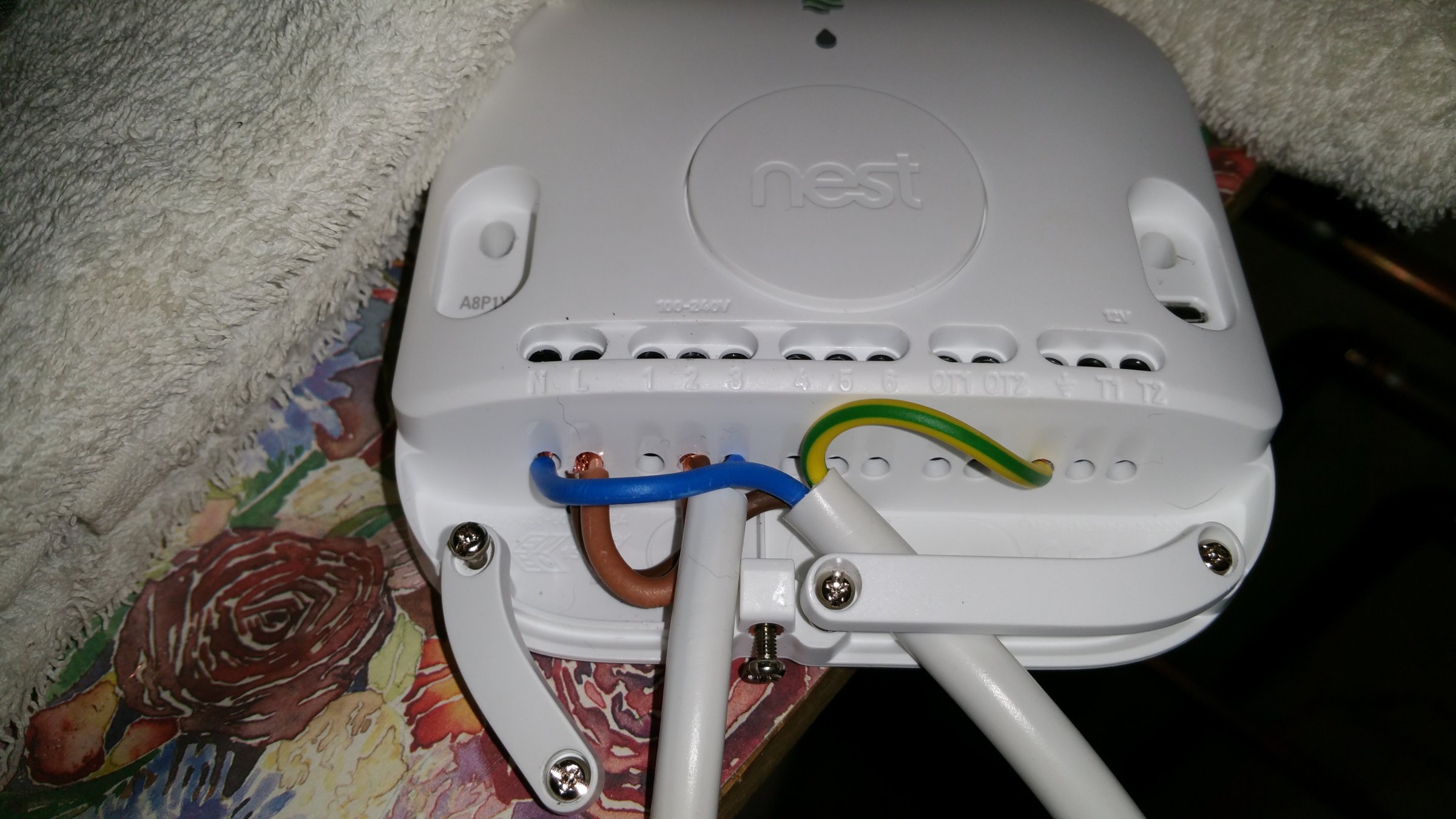

So I fitted this yesterday and didn't get any heating - HW worked fine, open a tap and hot water, heatlink connected to thermostat by wifi and all leds ok. I followed this thread and wired exactly as shown - https://www.diynot.com/diy/threads/nest-gen-3-installation-with-baxi-combi-maxflow-wm-boiler.494416/
But no heating and no manual override when pressing the button on the heatlink. So looking at the Nest wiring diagram for 230v combi I noticed that there should also be a live into 2 on the heatlink so I added a jumper between L and 2, still nothing and yes all lights on heatlink ok - thermostat has been put on a stand in the lounge and said heating but nothing.

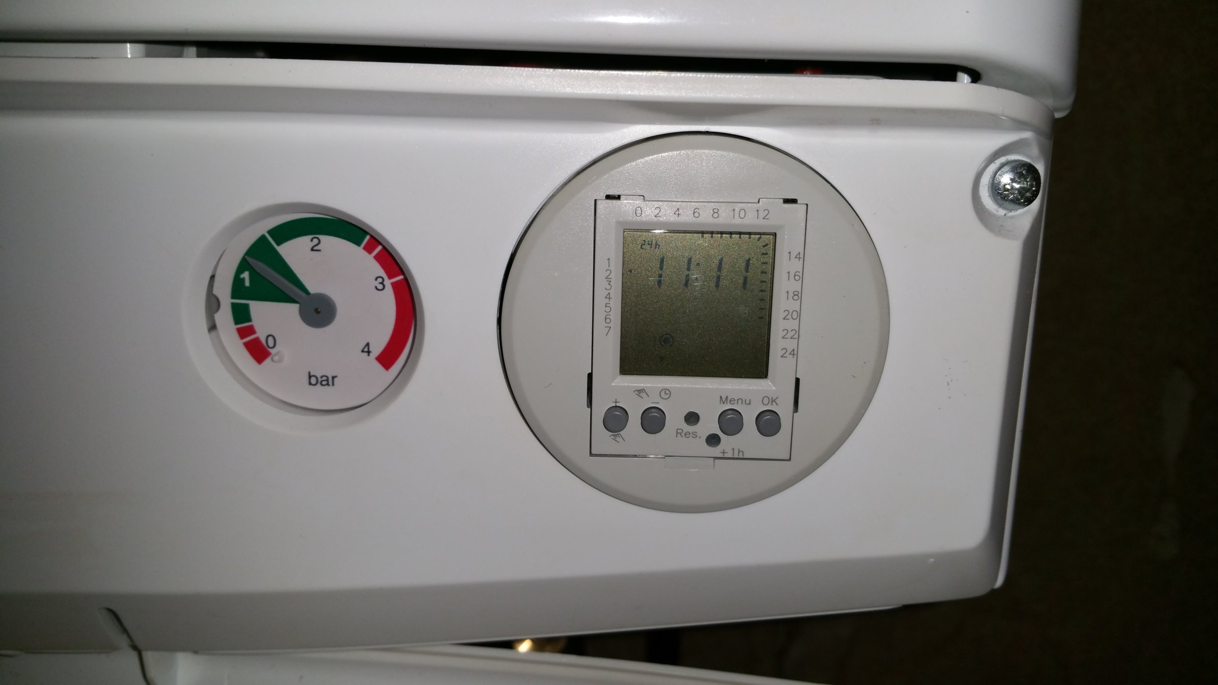

Lo and behold I wake up this morning and the heating is on! So now I'm a little bit concerned that I have cocked something up. When I had the boiler installed I opted for the digital programmer rather than the mechanical clock, I have no room thermostat only thermostatic valves on the radiator.

- have I wired it correctly? (in the heatlink pic below the RH cable is L,N and E from supply side of terminal block on boiler and the 2nd cable is from terminals 1 and 2 as per thread mentioned previously)
- is the digital programmer overriding the Nest? (I only entered the time after the power was off - no programs)

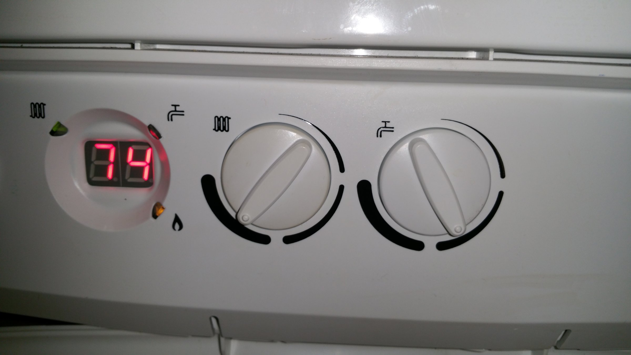

- what temperature should I set the CH dial on the boiler for maximum efficiency or doesn't it matter?
