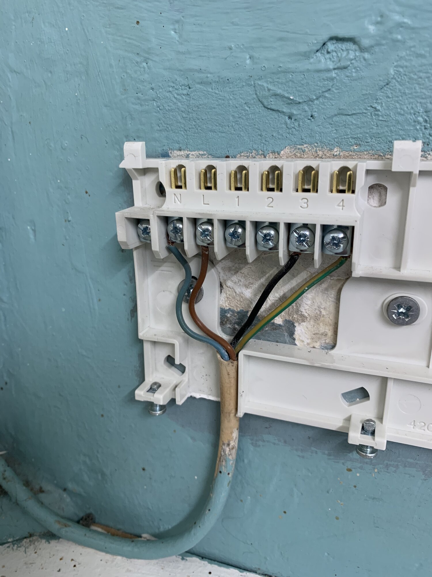

I managed to replace our old Honeywell ST9420C and wireless thermostat with the Nest Learning Thermostat V3 using the following wiring layout:
Honeywell-Nest
N-N
L-L, 2 & 5
4-3
3-6
Previously, on the old Honeywell programmer there were just 4 wires - N, L, 3, 4.

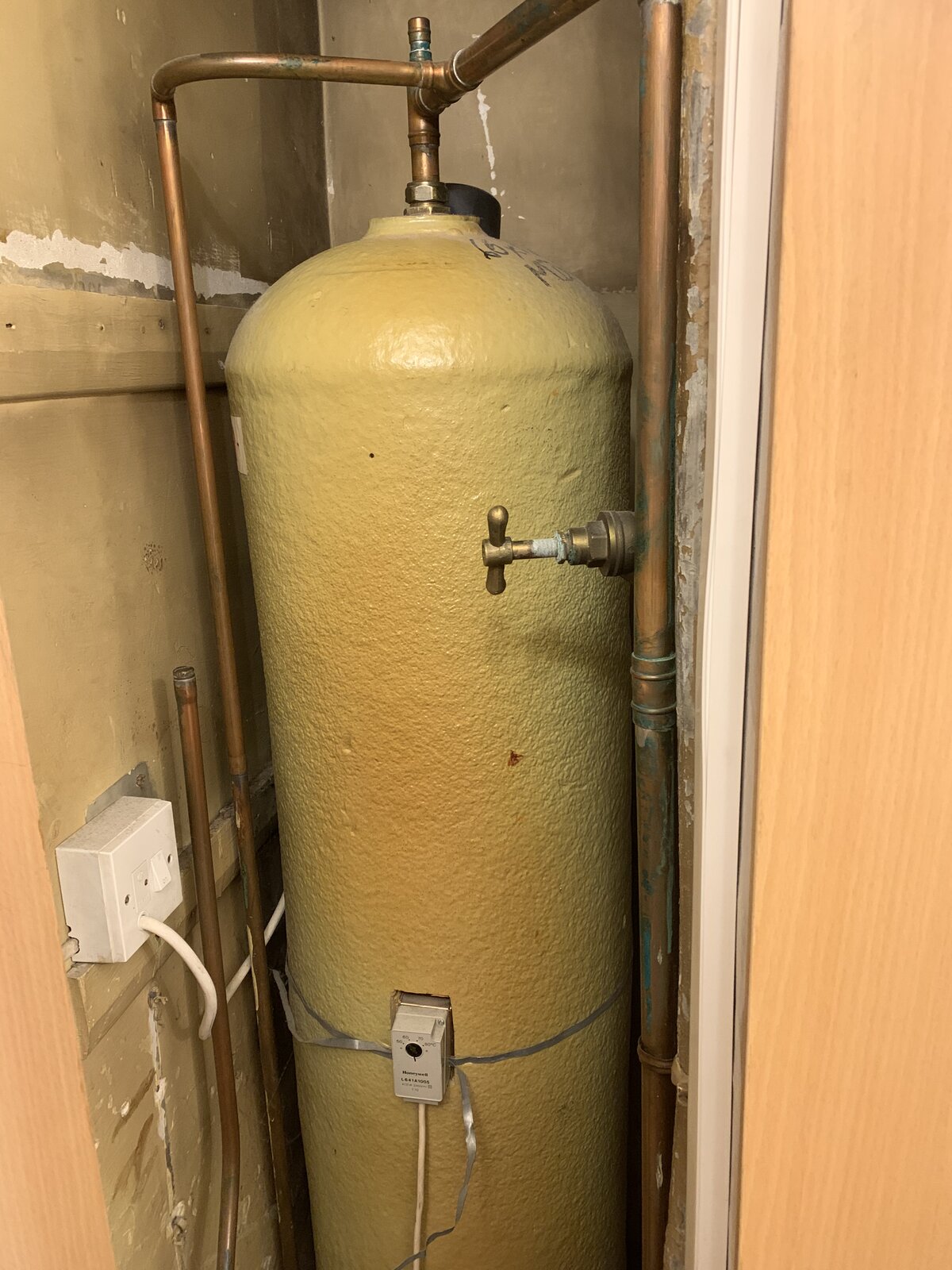

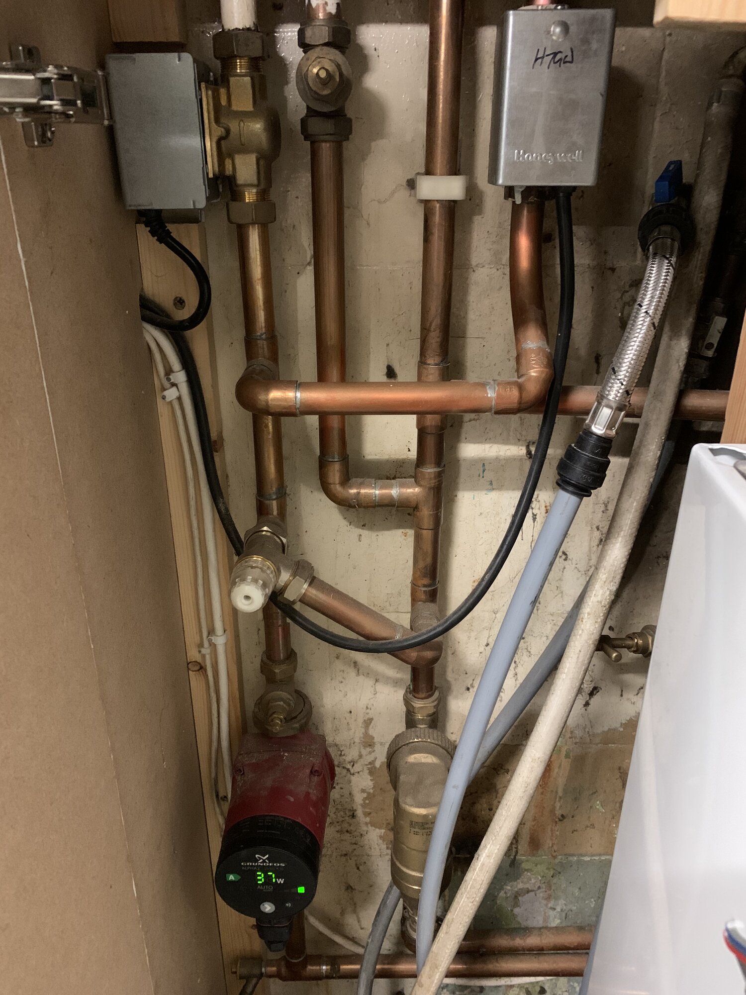

This is working fine for the heating but the hot water seems to be always on with the heating. We have a system boiler (2 valves so presumably S-Plan) and a separate hot water cylinder, which also has an electric immersion heating option which we rarely use, and a header tank in the loft. The old programmer had separate controls/timers for heating and hot water. On the Nest, it’s set to System Boiler with radiators but under the Pro settings it says hot water not connected, and there is no separate schedule/controls showing at all.

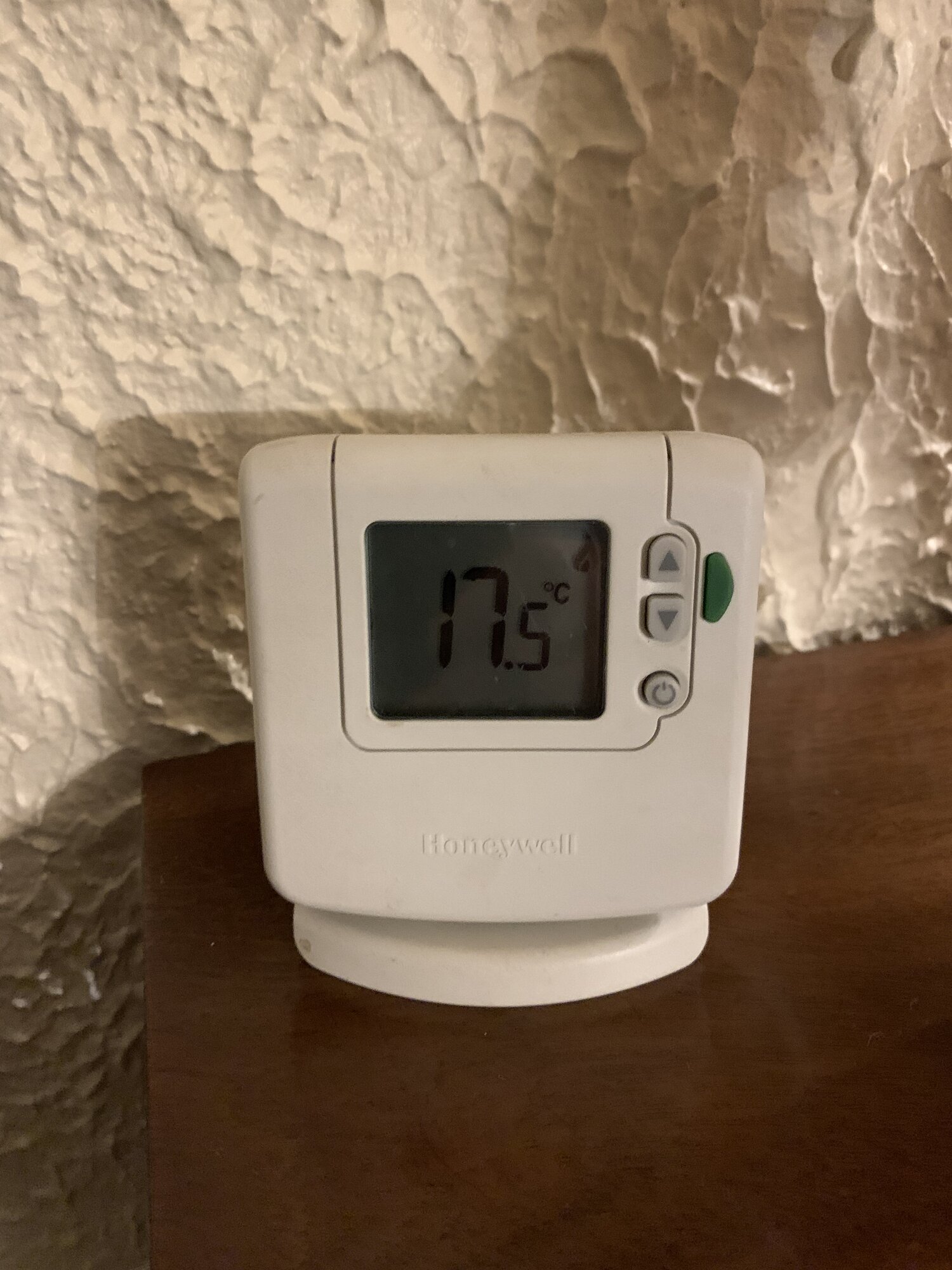

Please can someone help me resolve this. Could it in some way be due to me not properly disconnecting the old wireless thermostat? Not sure how to do that so I simply took the AA batteries out of the unit and put it in the cupboard.

sounds like you have the nest set to Gravity Hot water, you need to set it to fully pumped

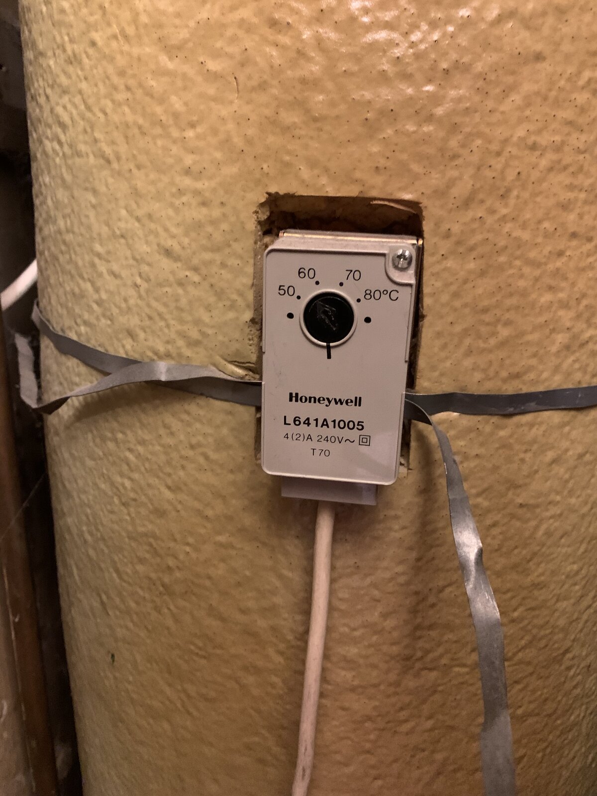

I don’t think there’s a wireless thermostat for the HW cylinder. Looks like there’s just one strapped onto the cyclinder itself (Honeywell L641A1005 - grey box with a black temp dial).
