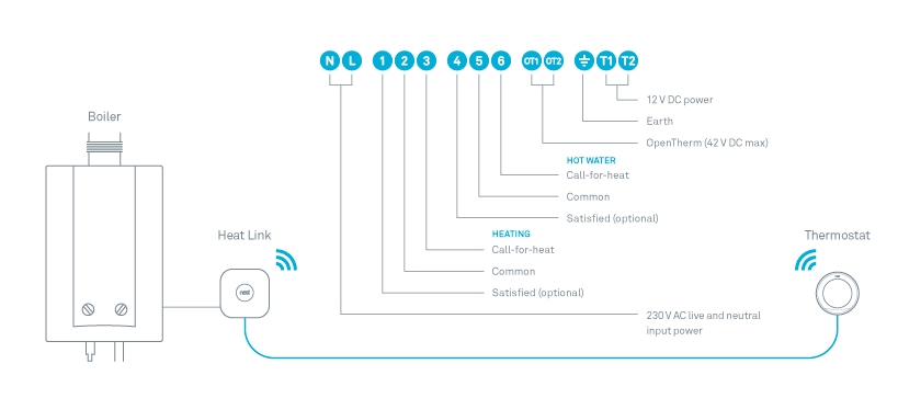

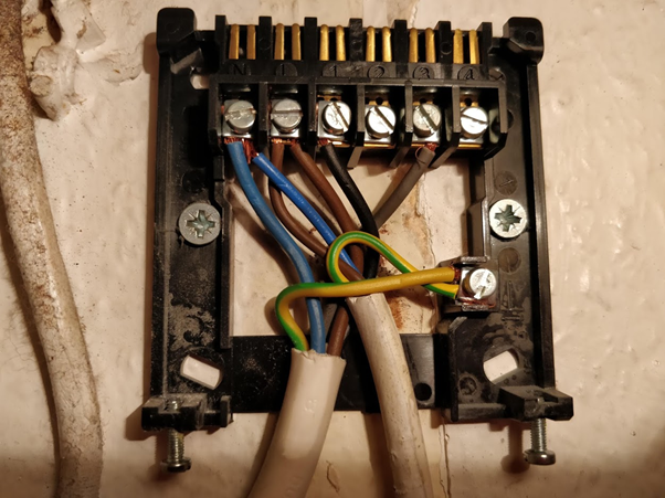

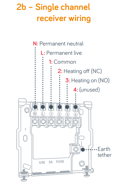

I’m looking for some help with a 3rd gen nest install. I have done quite a bit of research, but I’m yet to find the answer. I don’t profess to know to allot about these but I’m sure someone can help me pretty quickly and maybe help others in the future by doing so.
From what I’ve read and researched I believe the config should be as follows, although I’ve not seen anyone who has had two power leads connected and I believe I should just connect both the wires?
Both Blue cables to N in nest
Both Brown cable to L in nest
The Black cable in 1 is “HW satisfied” nest 4
I’ve no idea where to put the brown cable in 4
I’ve no idea what to do with the earth cables yellow and green
Any help is really appreciated.
