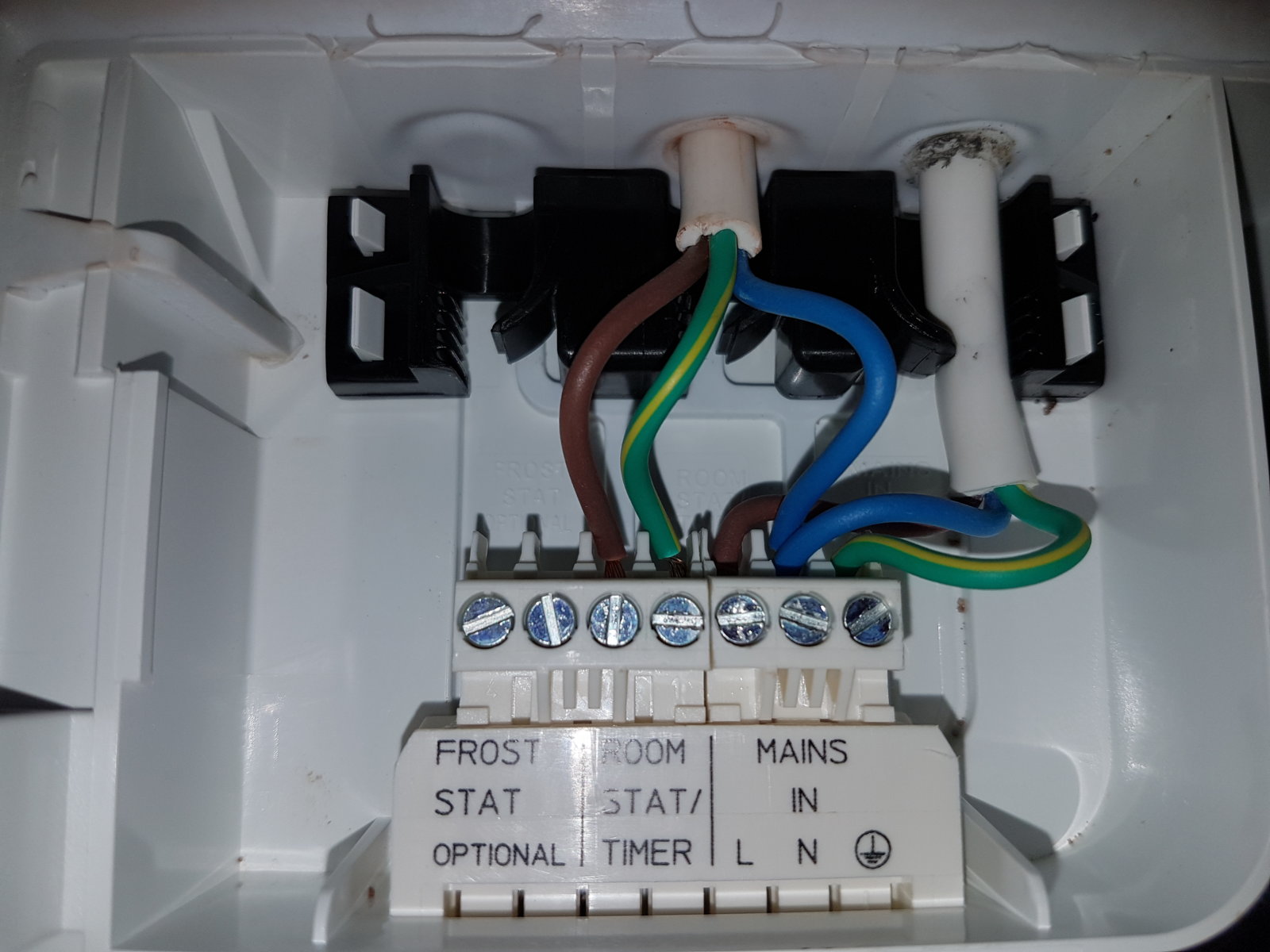

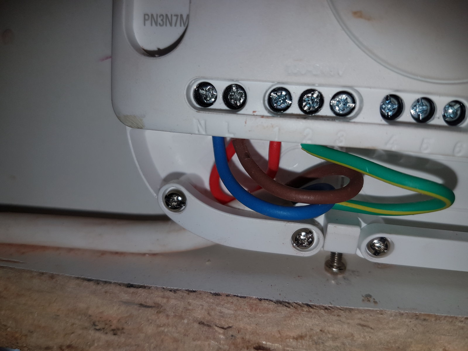

Hi
We have just had a new boiler installed but the Nest is not working. I don't think its been wired in correctly. Please could someone check the pictures uploaded and let me know.
Thanks in advance for any help.
Wrong in several ways.
To do properly you will need some 5 core flex, or another piece of 3 core.

With 5 core flex between the Nest heatlink and the boiler:
Colour - Boiler - Nest Heatlink
Green/Yellow: Boiler earth - Nest earth
Brown: Boiler L - Nest L
Blue: Boiler N - Nest N
Black - Boiler Room Stat - Nest 2
Grey - Boiler Room Stat - Nest 3
Doesn't matter which way round the wires at the boiler room stat terminals are.
If using 3 core flex, then the existing 3 core is for E-L-N as above, then another separate piece of 3 core flex is
Blue- Boiler Room Stat - Nest 2
Brown - Boiler Room Stat - Nest 3
However if the existing mess was installed by someone you paid, then they should be the ones installing it properly, or you need a refund from them.
