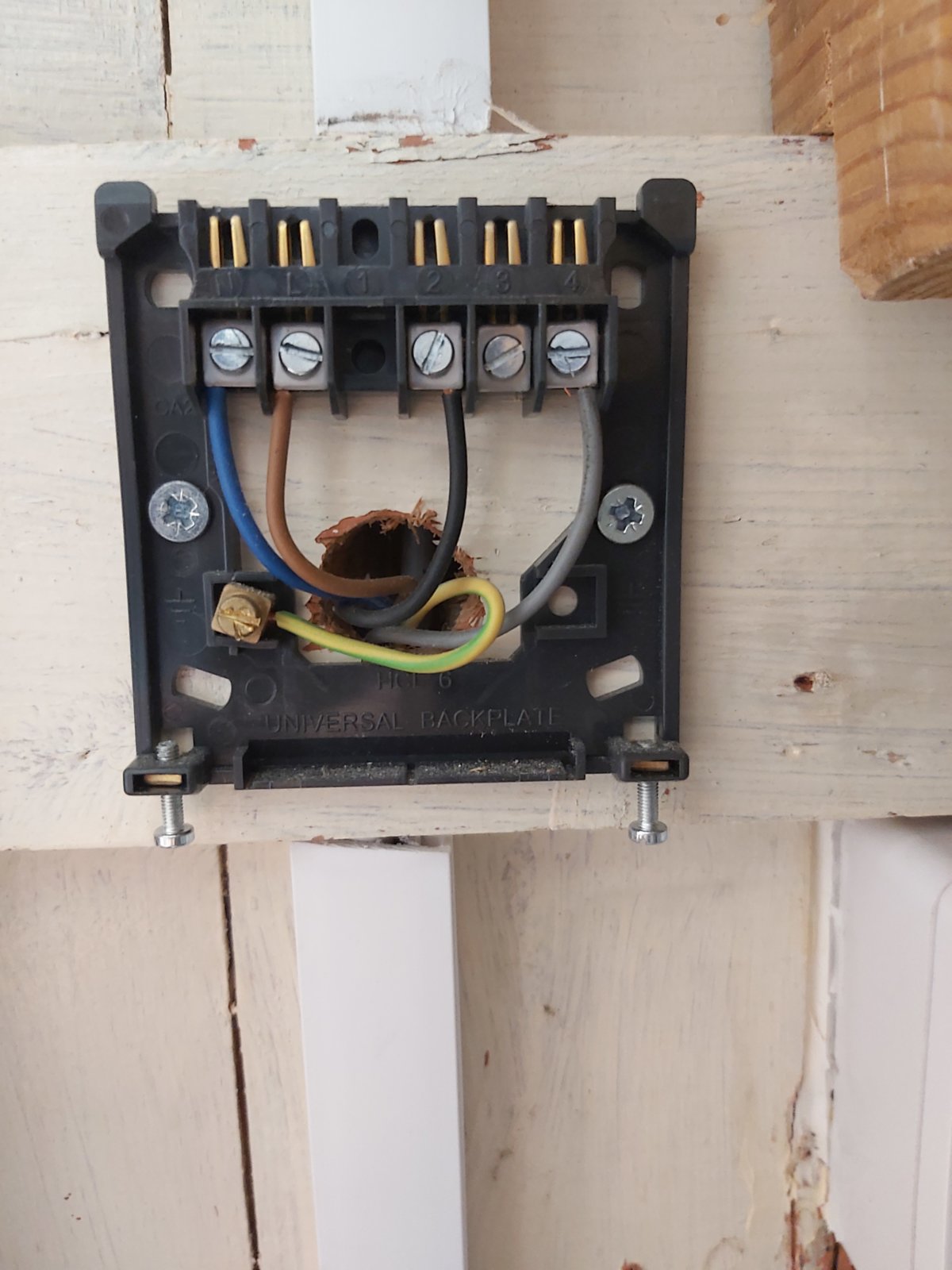

I'm currently trying to install a Nest Thermostat E with Heat Link to a Baxi Combo Duotec 28. There is currently a Horstmann Hrt4-zw attached with the wiring below for the wireless receiver.

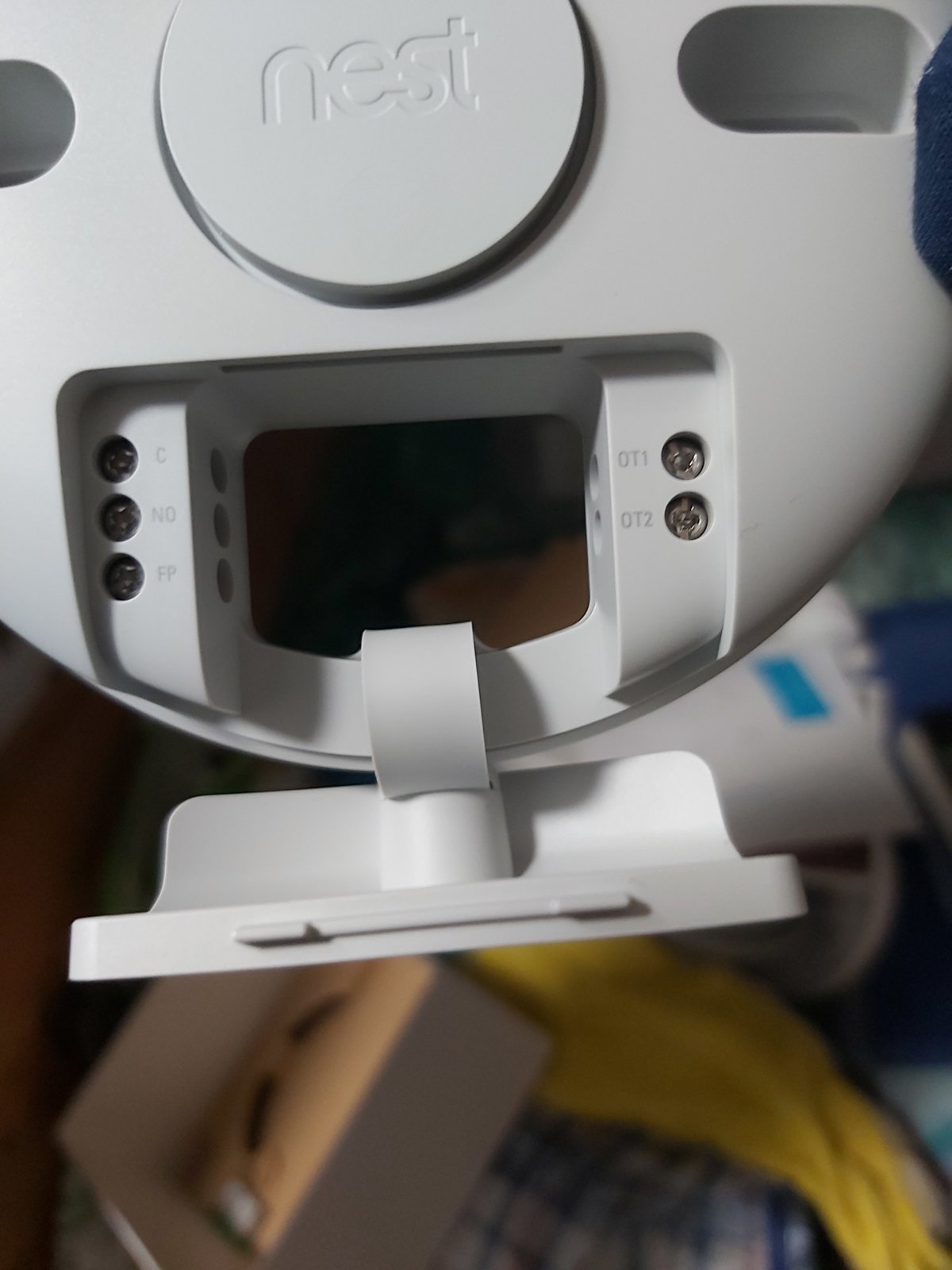

Now how do I know which of these wires connect to the Nest Heat Link which is below
Many Thanks for any help given :)
The black and grey wires in terminals 2 & 4 go the the e-nest C and NO terminals.
The blue and brown wires (230V supply) aren't needed by the e-nest because it's battery operated. They should be safely isolated / insulated and tucked out of the way, as should the earth wire.

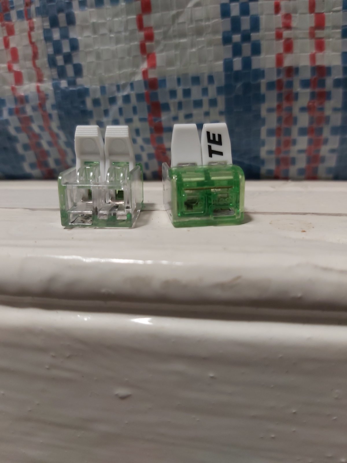

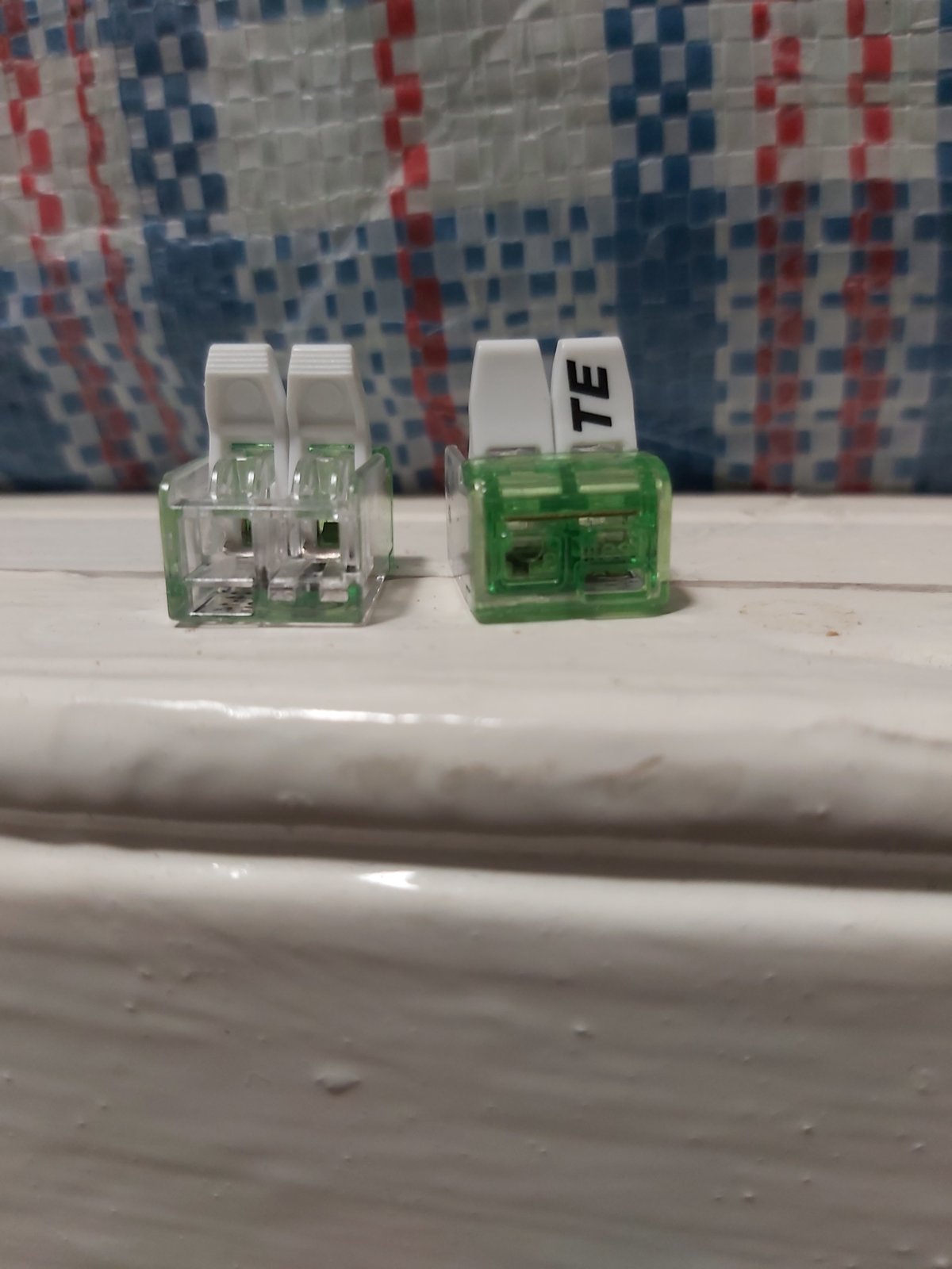

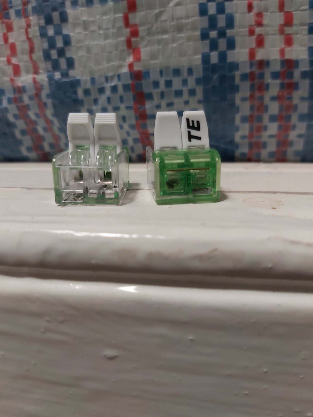

I think I know where I've gone wrong I'm I right in thinking that when I use the wire connector below that I'm not meant to be putting the blue and brown in the same one?
Indeed! Connecting a Live and a Neutral wire together is never a good idea. BOOM! :eek:
Like I said "isolated". Keep them all separate.
Hahaha whoops may explain a lot then. Can I use insulation tape on the other wire? Or would I be better getting another block for the 3rd wire?
Better to put them in individual blocks really, isolation tape can fall off after time.

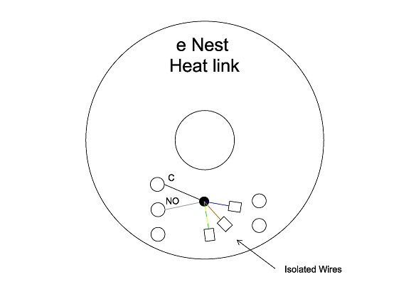

You should have something that looks like this.
With either the black wire in C and the grey wire in NO
or:
the black wire in NO and the grey wire in C. It doesn't matter which way around they go. The terminals are quite close, so make sure that the copper conductors of the grey and black wires aren't making contact with each other.
If this is how it's connected, then the problem will most likely be due to a set up, or communication error.....
.....except there is a chance that you may have damaged something when you connected the live and neutral wires together and blew the fuse.
If it is wired up as above, as a test, you could try taking the wire out of the 'C' terminal. Make sure that it isn't touching anything at all, and restore power. If everything's OK, with the boiler it shouldn't come on now.
