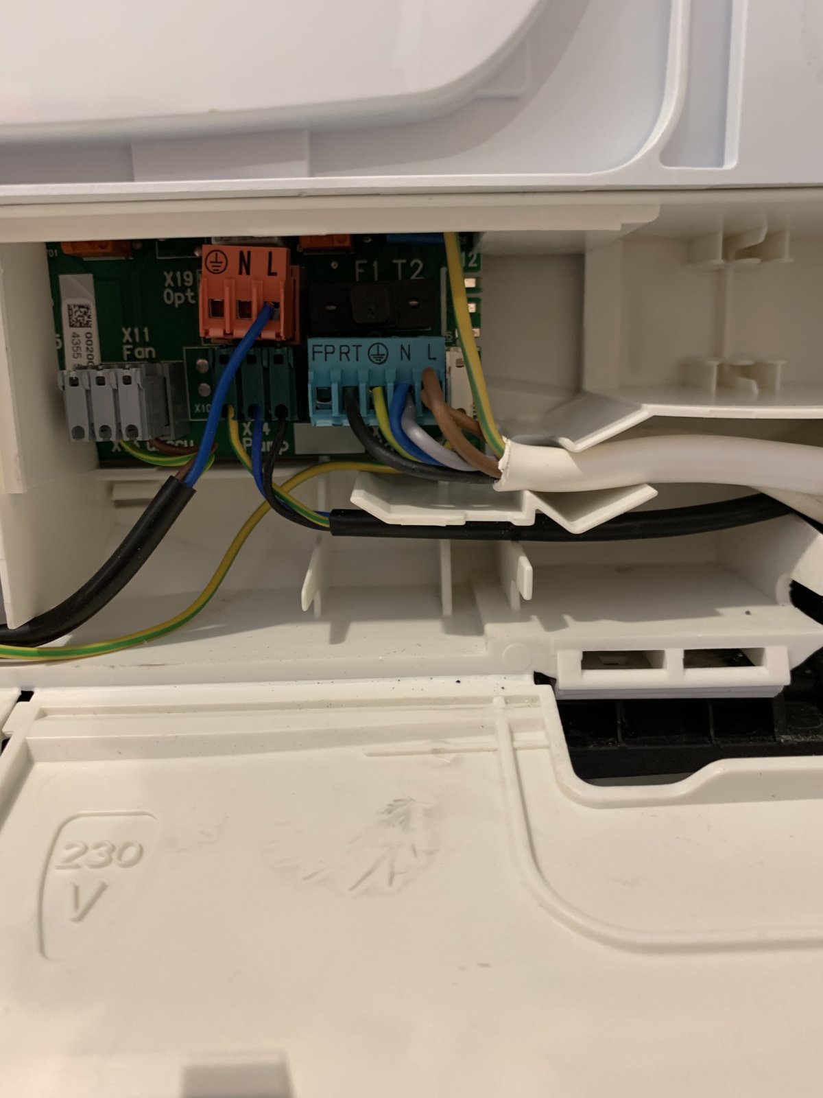

Hi all!
I recently purchased a nest thermostat to accompany my gloworm ultimate 30c combi boiler. I originally wired the heat link to the drawing supplied with the instructions supplied with the nest but that didn’t seem to work and my boiler would only turn on once I went past the set limit on the nest thermostat.
So I did a bit of research and found that apparently the drawings supplied is catered for American style boiler systems and found someone who had done a similar install. I have posted a link to the guide I followed below for your reference.
Previous post for similar boiler:
https://www.diynot.com/diy/threads/glowworm-flexicom-30cx-and-nest-v3-thermostat.494097/
Tutorial:
https://www.cnet.com/uk/how-to/how-to-set-up-a-nest-thermostat-in-the-uk/

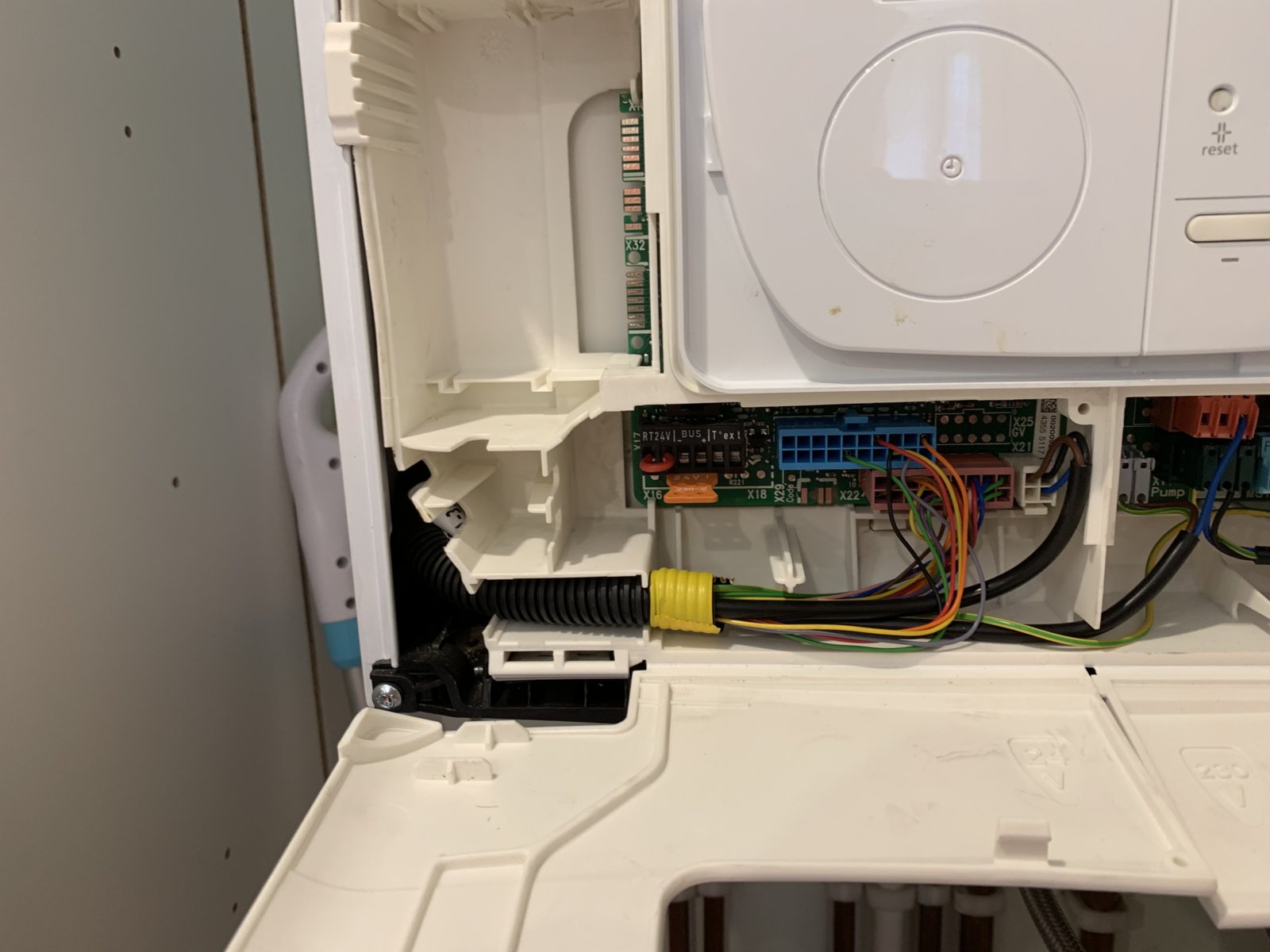

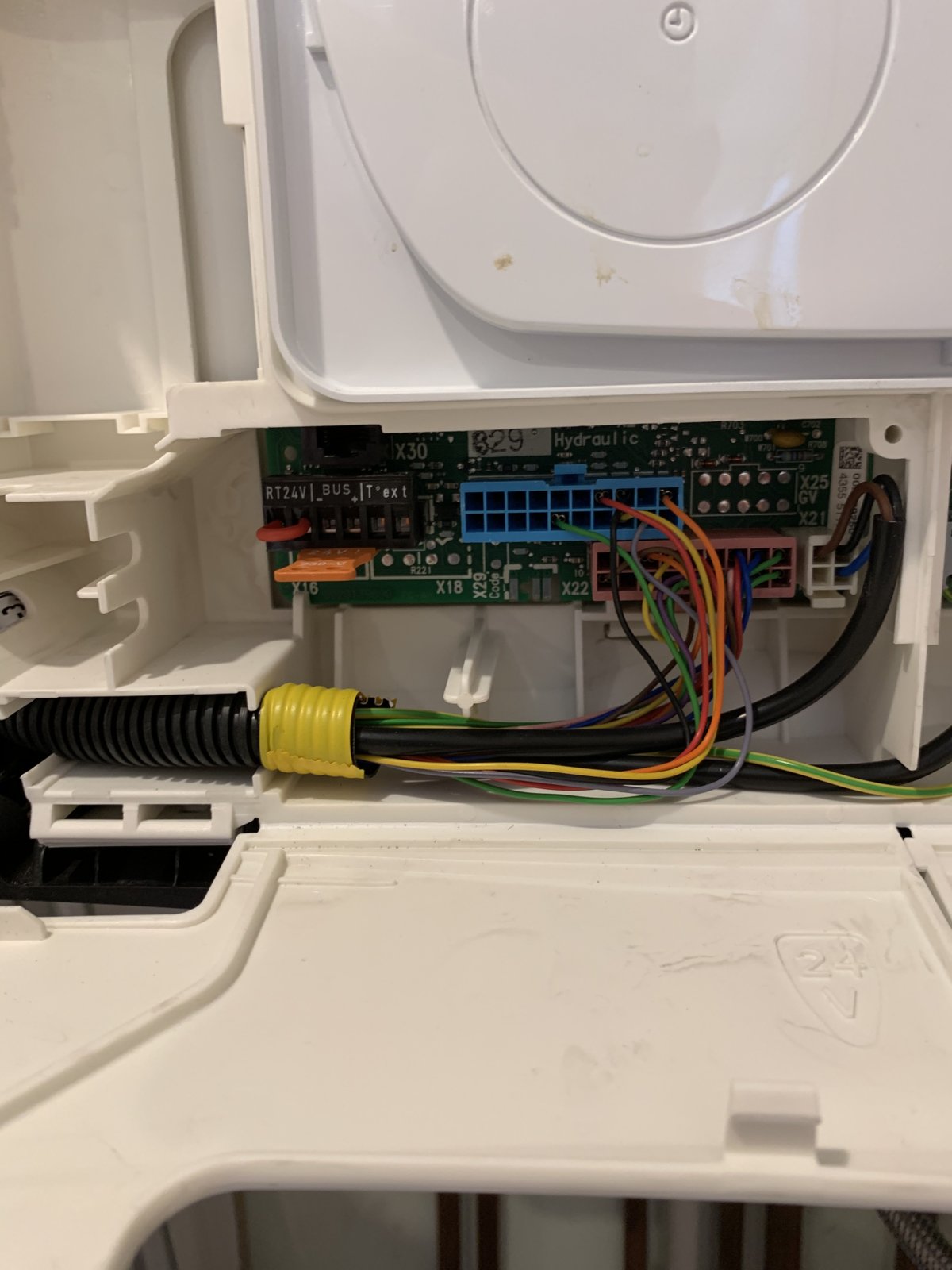

Essentially I have tapped in directly from the boiler 230v supply to the heat link then took a jumper cable from the Live terminal of the heat link and put that into terminal 2 on the heatlink. Then added one more core from terminal 3 on the heat link then wired it into the ‘RT’ terminal on the boiler as suggested in the tutorial/forum post.
Now this has fixed the previous issue I had with the boiler not turning on until I went over the set temperature on the thermostat but now it seems like my central heating is not heating when I change the tempature on the thermostat and when I go to my boiler I have a flashing radiator symbol.
If anyone has any ideas as to how I can fix this/where I have gone wrong it would be much appreciated.
