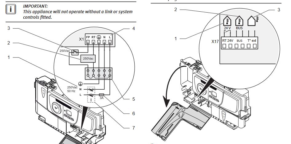

Hi all,
I have had my boiler switched out from an very old (1990s) boiler to a Glow Worm 30c.
I had a Nest configured on this by an official installer, I believe he used the Y Plan configuration.
The new boiler is installed but the Nest is not connected in any way. I believe it should be easy enough to do, but I need a little guidance.
Here are what I believe are the relevant diagrams:
NEST
BOILER
Is that really all there is to it, two wires between the boiler and heatlink? How do I turn off the timer on the boiler? do I need to remove either of the loops under X106 on the second diagram?
One of the confusing things I am seeing in my research is this diagram:
I know its for a slightly different boiler the 30CX rather than 30C, but that seems to indicate 4 wires..... which is fine, but I do not see a 0v socket on the boiler.
Would someone mind pointing me in the right direction please?
2&3 from the nest are connected to your boiler at plug X106, you will see the terminals marked 24vRT you remove the link (if still fitted) and connect the two nest wires to here, do not put 240v into those terminals
Thanks Ian, If I am reading it right, does this mean it will look like this:
Also it doesn't seem clear which way round 2 and 3 connect to in X106
THANKS IAN!! I think it is all wired up and connected correctly, do I need to set the boiler to any particular setting to get the heating to come on or off? at the moment it is set to the timer but ideally I would want that off entirely.
UPDATE: It is working, I have it set to on and the Nest seems to take control.

Quick look at manual
It seems three ways to connect a thermostat, also there are two UK Nest thermostats plus the USA version.
If that was the case then the thermostat connects to the motorised valve, so non of the above.
